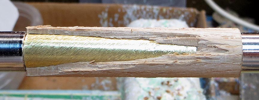

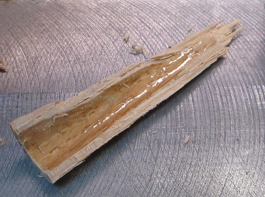

I usually use less expensive epoxy. I've used Great Planes and Bob Smith (BSI) a lot for building high power rockets. But I recently had a blowout, where the inside of the blank obviously had epoxy on it. I don't know why it didn't adhere to the tube, but I thought I'd try a name brand epoxy. And besides, the OP asked for epoxy that could be purchased at Home Depot, which is where I got the Loctite.
