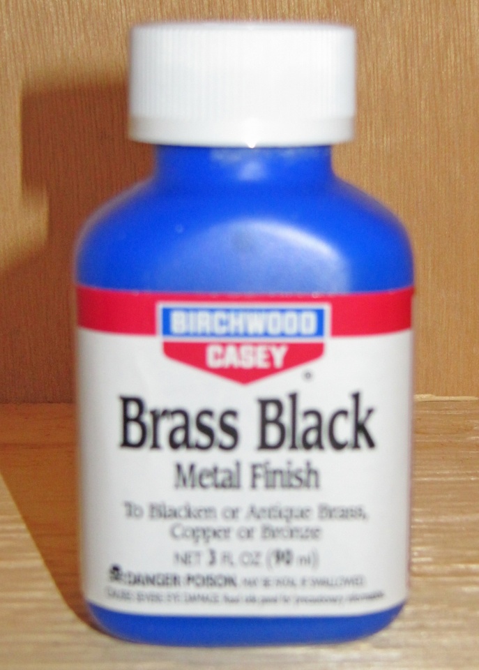

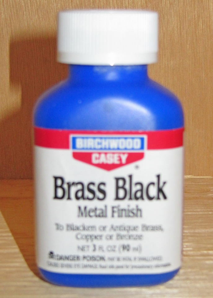

If you happen to want your tube to be black, here's a product I use!
attachment.php

One alternative to painting the tube or using brass ager, that I sometimes use, is nickel plated tubes. Wish they were available in more sizes though.
