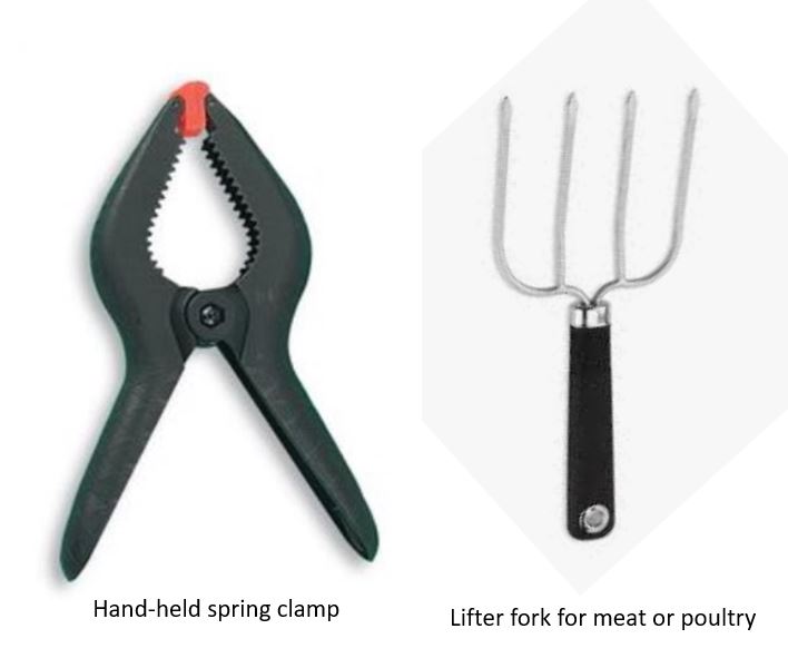

I guess that I'm more of a belts and suspender guy. I paint both inside the blank and the tube. If I only paint inside the blank and the tube happens to scratch a bit of paint off the inside of the tube during the gluing-in process. then I have a "window" effect showing a bit of the brass tube. If I only paint the tube and I happen to scratch some paint on the tube while gluing it in, I get the same negative effect. So, I use spray paint and paint both the blank and the tube. To paint the tubes, I place them on a cheap meat flipper and spray them over a trash can. To paint inside the blanks, I hold them in a spring clamp, give it a good spritz from each end of the blank and set it aside to dry.

I agree with you completely. There are multiple ways to do many, most steps in pen turning and as long as they work for the person, that's the one they should use. I've been painting both the tube and the blank for about 15 years or more and I VERY rarely have any problems. It takes me about two minutes to paint them both and I set them aside to dry for 24 hours.
