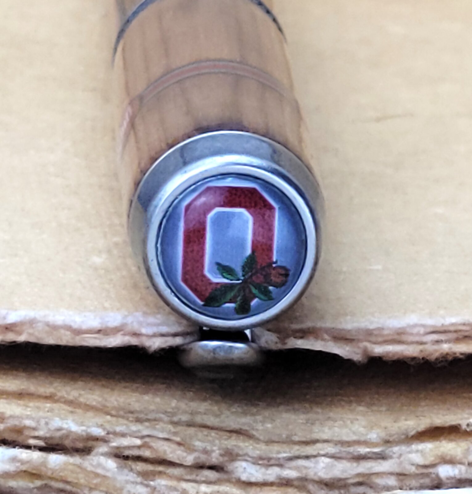

Since you are talking finial, I'll share my one experience (so far) with doing something similar. I used a decal on a wafer thin piece of scrap resin having been turned to the finial diameter. Once it was epoxied in place, I filled the finial area with UV resin and cured it. I'm not sure how that would work with a 3d object regarding air bubbles, though. Here's a picture of my result.

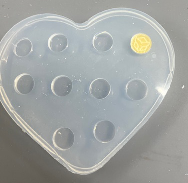

I have a resin mold for my finials. I print out 3D finial coins (pictured below), fit them tightly in the mold at the bottom, and fill the mold with resin to cover the finial. I have tested them with unpainted prints, and they come out fine and bubble free once out of the pressure pot. I did a quick test using nail polish on one and it did not come out well. I will try some high-heat spray paint on my coin to see if it improves.
