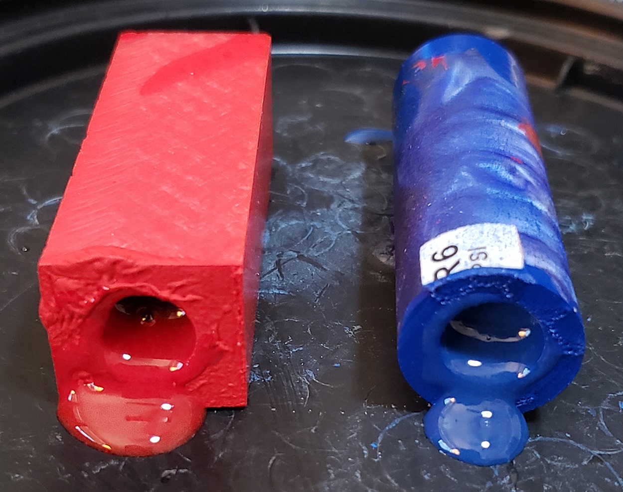

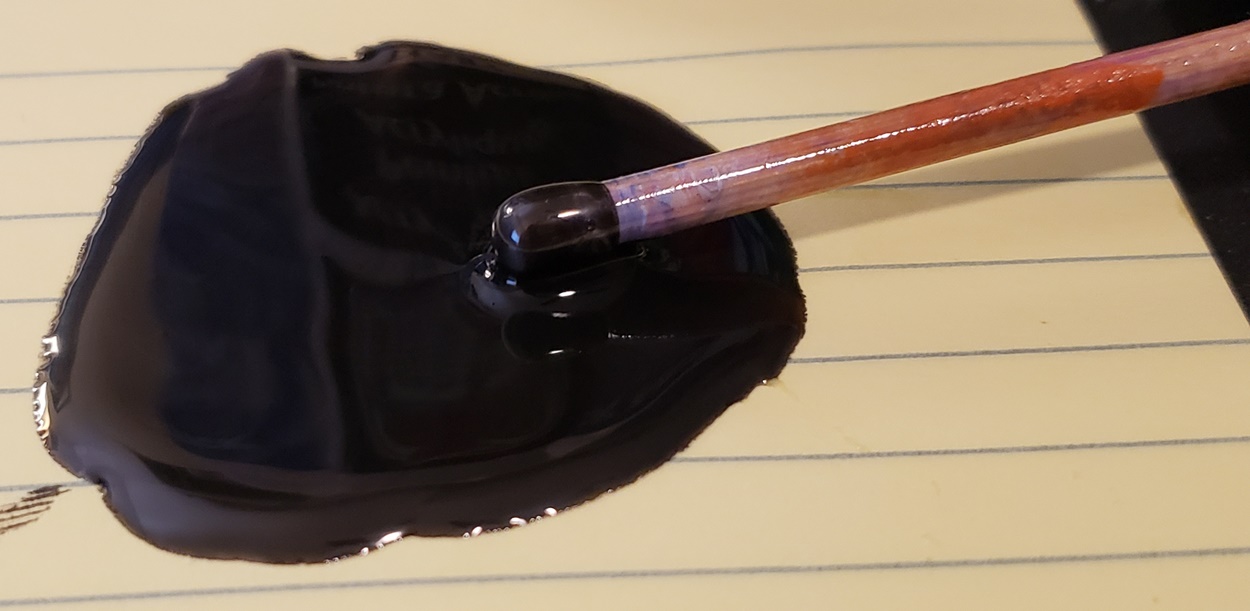

I've been painting the holes of my acrylic blanks black. With the goal of creating a light barrier, black seems the obvious choice. I've been using spray paint because it's thin and doesn't build up the wall thickness too quickly. It takes 4 coats of black on a translucent blank usually before I can see no light through the blank when held close to a bright light.
But black really doesn't show off the colors vibrantly. I bought a can or orange for a specific pen that I was making as a birthday gift, and wanted the color to be vibrant. After 9 coats I didn't have a light barrier. I switched to black and reached a light barrier that I was happy with at the 12th coat. Well you guessed it…the tube doesn't remotely fit. I had to drill out the hole again and start over.
The spray paint, even the black, really doesn't stick to the plastic well. It tends to run off and most of it ends up on my catch pan. I tried craft paint and q-tip before, but it seems too thick, making the tube too tight after a few coats.

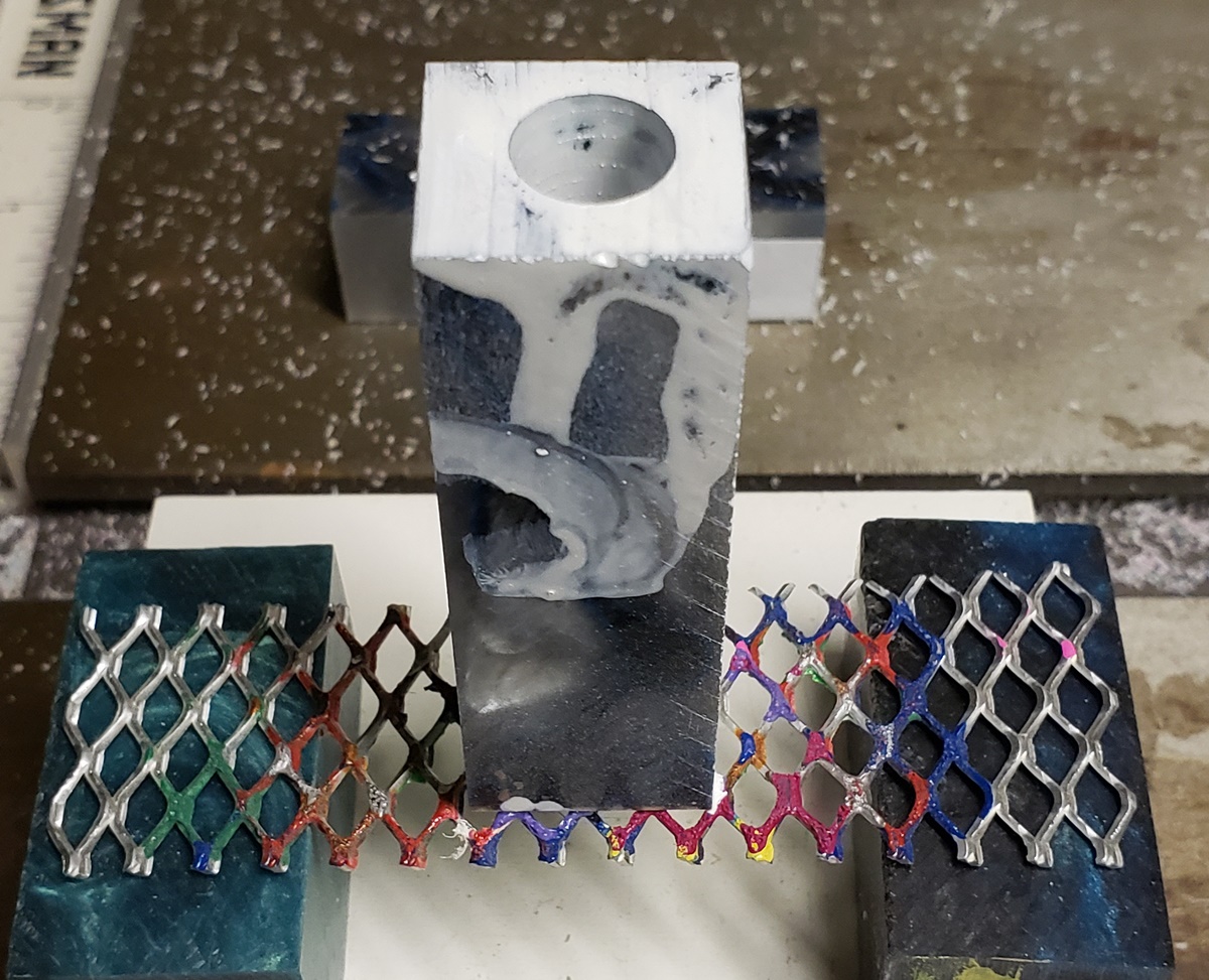

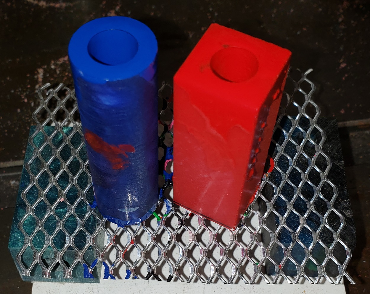

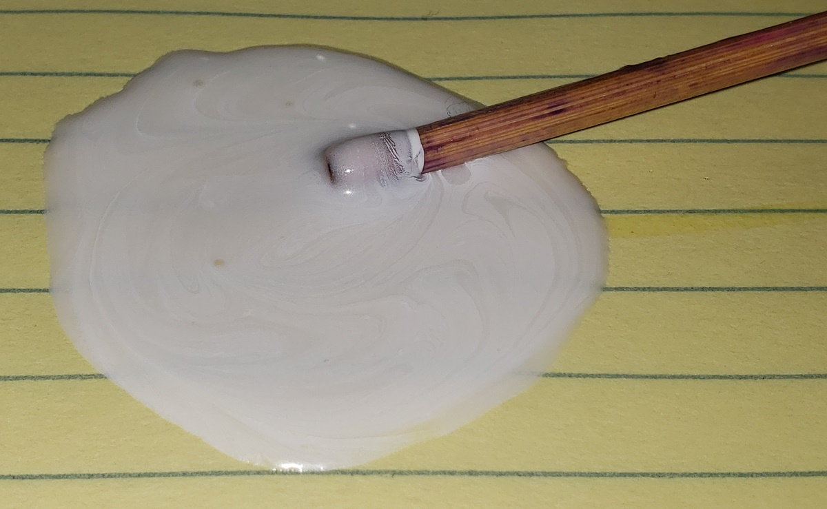

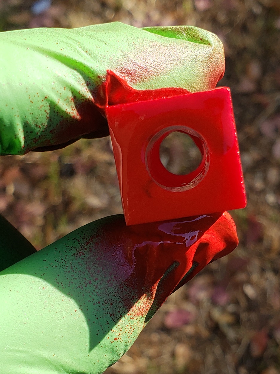

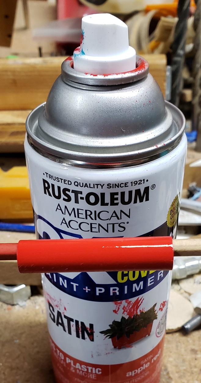

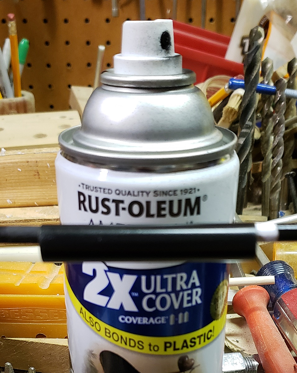

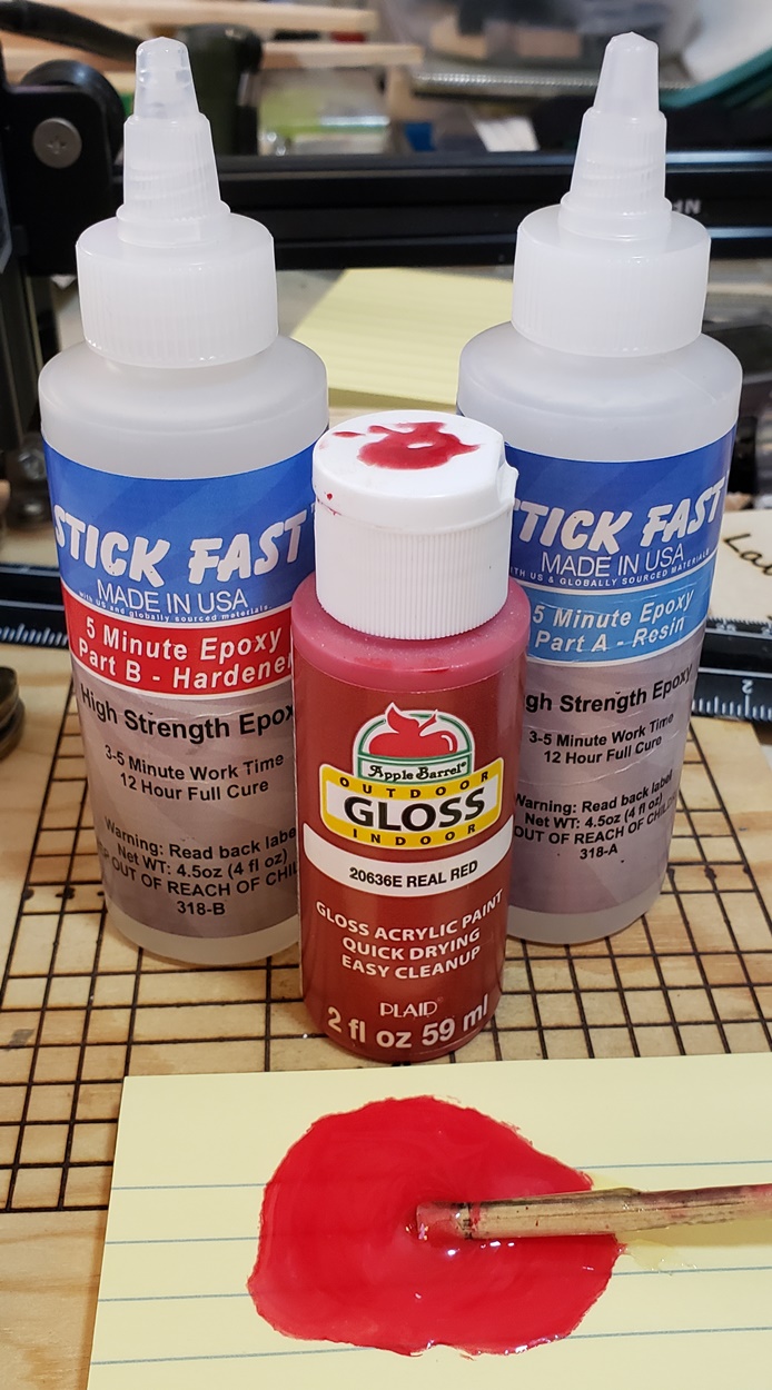

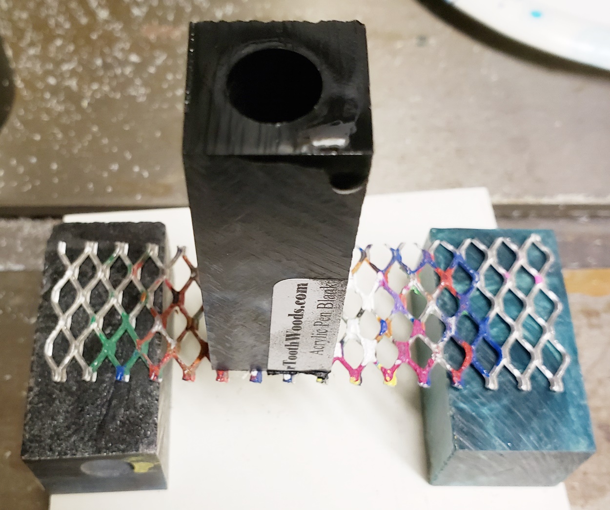

I use spray paint, usually Rustoleum, and always only one coat. After painting, I stand the blanks up on a screen, which allows the paint to run down and smooth out, and also allows air to get in the bottom as well as top. I never drill over size. As for color, I usually try to match the predominant color in the blank. Most of the time, I will also paint the tubes. I also color the epoxy with acrylic artist paint, it only takes a drop. This is the method I have come up over literally years of trial and error, and is what works for me.

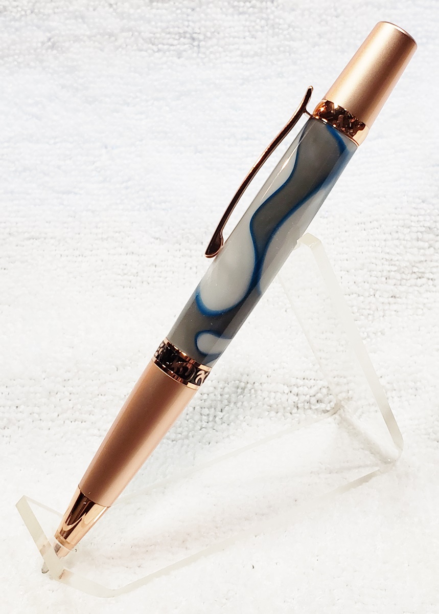

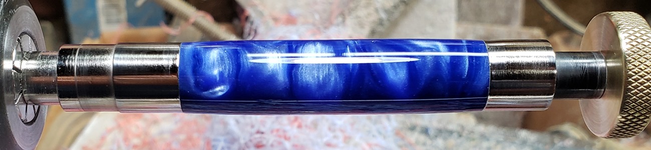

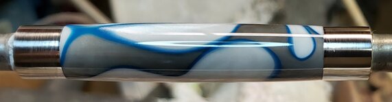

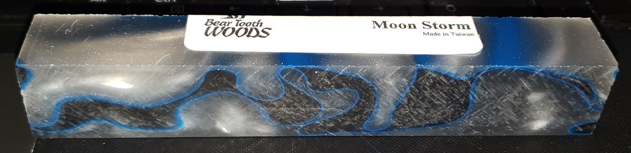

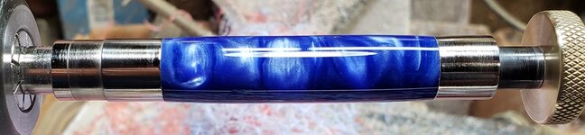

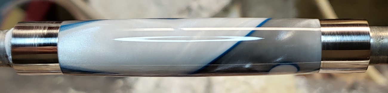

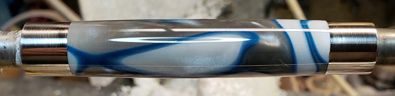

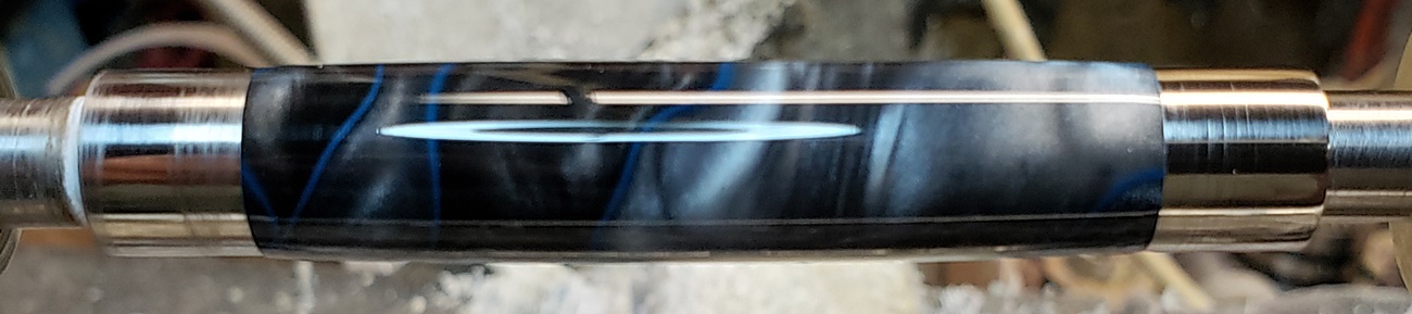

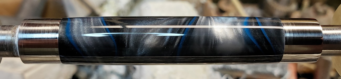

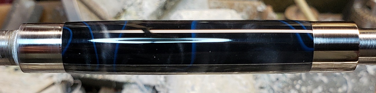

A few years ago, I conducted an experiment. I took two pieces of the same blank, back painted one black and the other white. The results were dramatic.

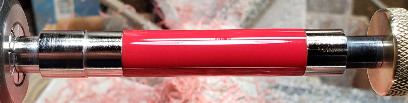

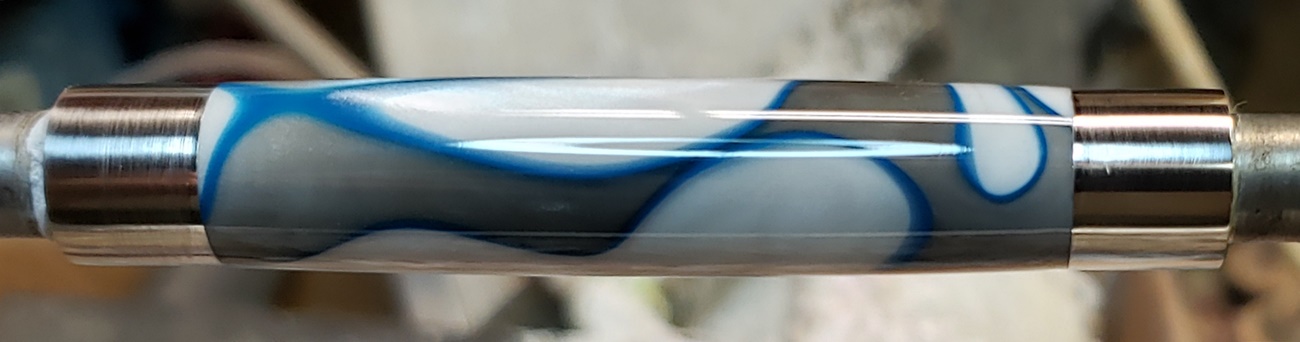

Todd; I'll confirm the earlier posts. You aren't trying to make the blank opaque, just block the view of the brass tube. Use the predominant color of the blank OR make the blank a different color by using a contrasting color.

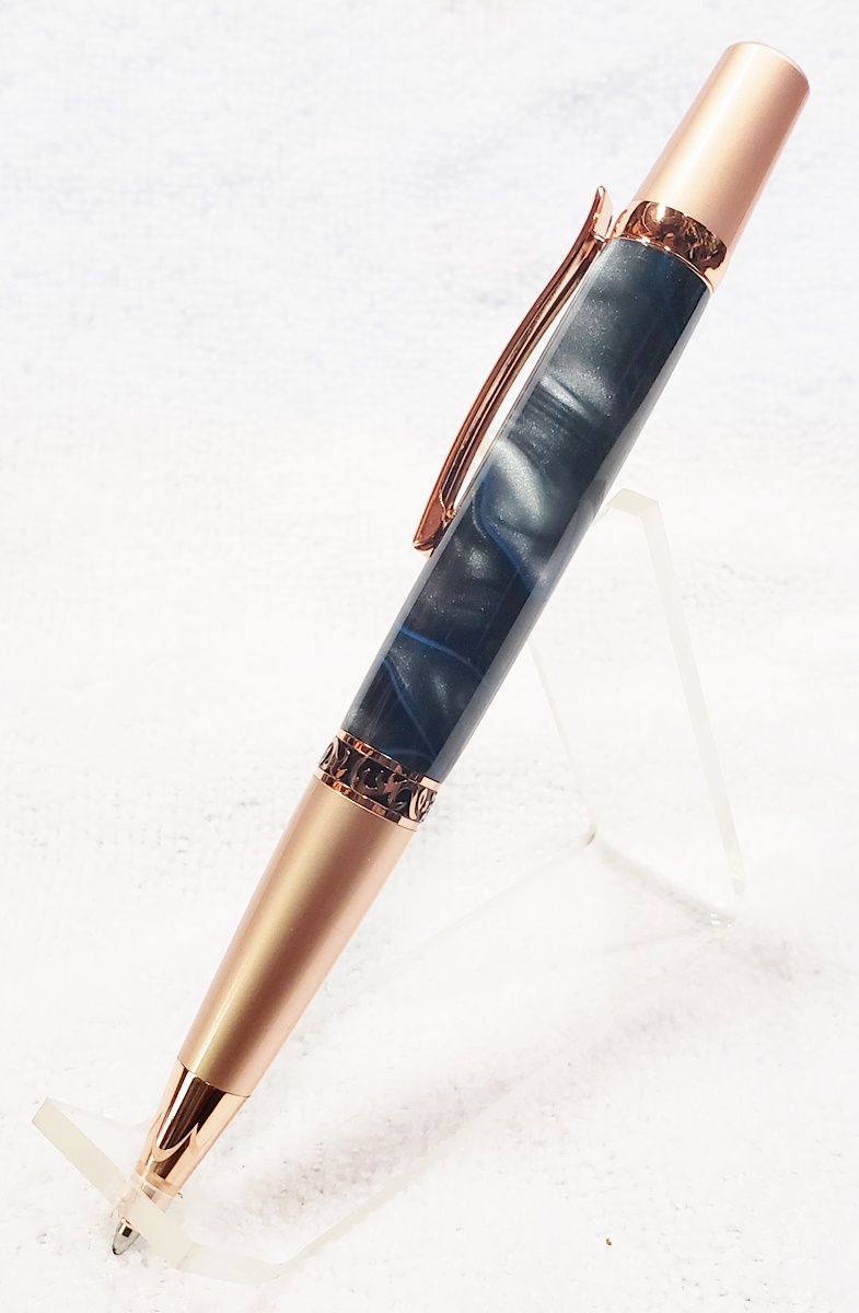

These two pens are the same blank, one painted baby blue, the other hot pink.

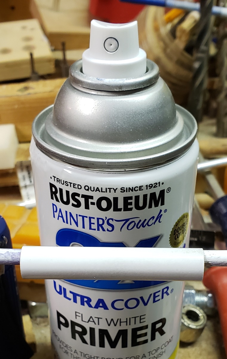

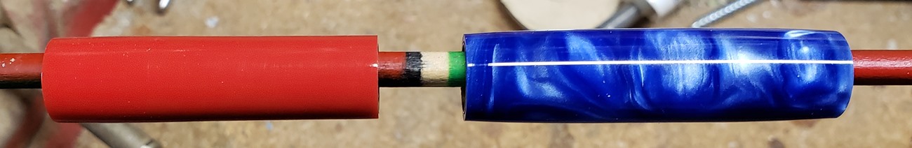

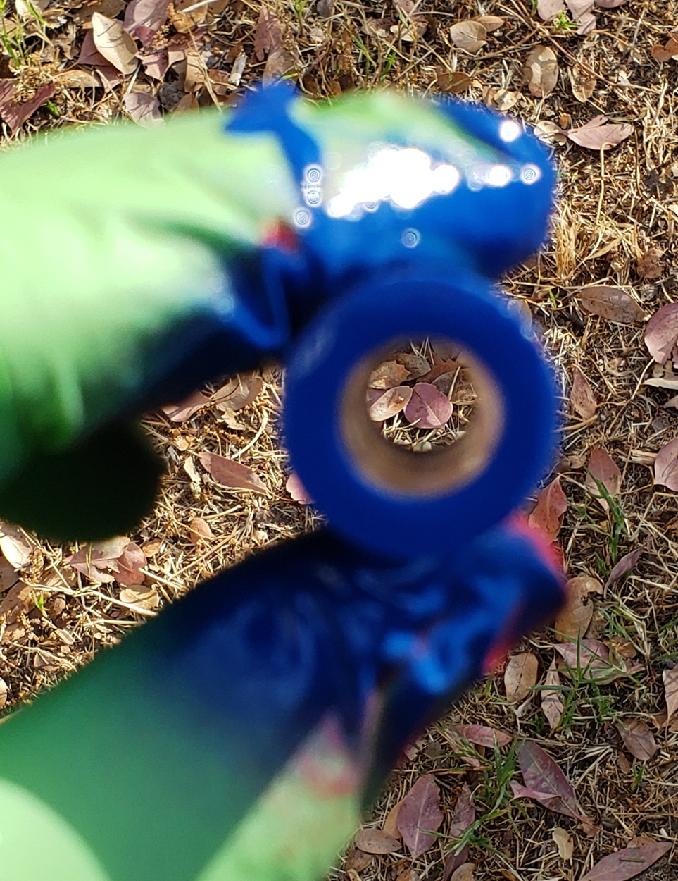

Like Todd and Jim, I too use Rustoleum spray paint and paint both the tube and inside the blank letting them dry overnight before glueing the tube in with thick CA.
A few years ago I painted two pearl white blanks, one red and one blue. The red one ended up pink and the other baby blue.

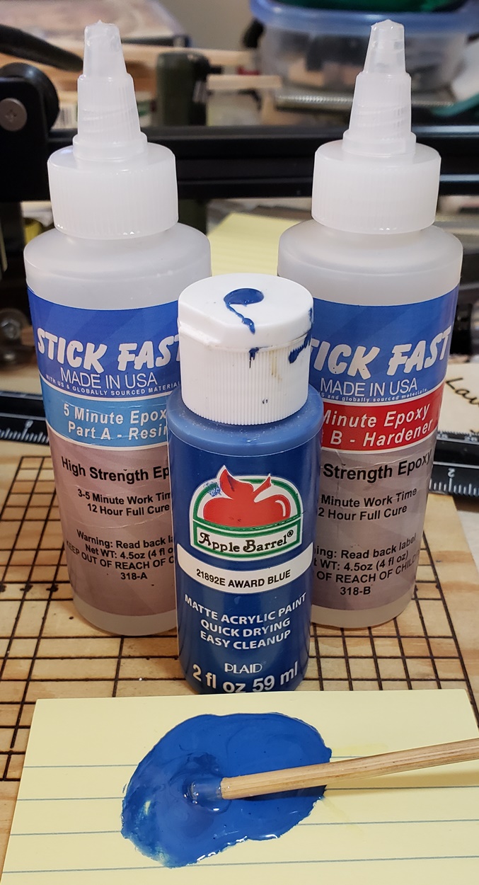

Thank you for so many good replies! I had never painted the tubes. Sometimes I'd sharpie the tube black to mask the brass. I'll adjust and paint both and not worry about making the hole opaque.
One coat! Oh man, have I been wasting a lot of time watching paint dry! 🤪

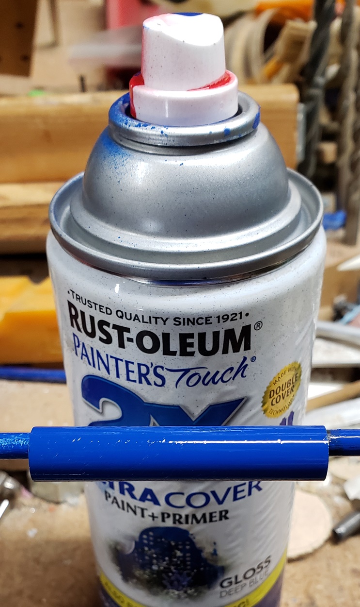

Yes you have. One to two coats all that is needed. I use all as mentioned above. Just a word of caution. I never paint both blank and tube and the reason is you now created a barrier for the adhesive to be able to slip off and break free of a solid surface. Paint slipping off the blank is enough to worry about. To me no need to do both. If still concerned I do as others and tint the epoxy. I always use epoxy. Never CA. CA does not play nice with paints.
Rustoleum Painters Touch, 1 coat. Black if I want to darken, white or silver if I want colors to pop more. I use both CA and Epoxy to attach tubes, depending on what I am doing with the blank but never had a problem with either.
Been using paint and CA for over 15 years and I can count on one hand the number of failures I've had. Switched from that brand of paint to Rustoleum and have never had a problem. And I paint both tube and blank letting both dry overnight before glueing.

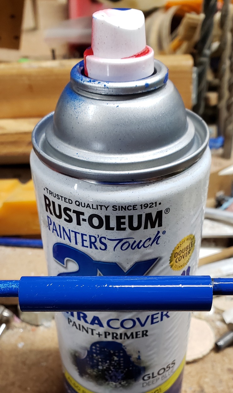

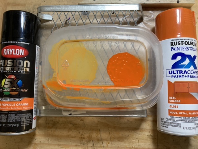

The issue for me was the paint itself. I had no idea there would be such a difference between two $5 cans of paint. I tried at least three different kinds which were all watery. The 2x cans are actually good. I bought the whole color wheel. Thanks again. Now I can get back to turning instead of watching paint dry!
