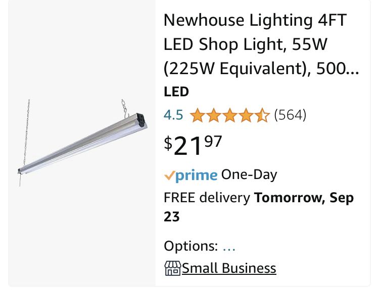

Some of the long fluorescent like fixtures using LED's and hang from chains work great. This puts out a lot of light. Nice part is that the lathe won't throw shavings straight up so it's rare you'll have to clean it. Example I link to isn't the only one. Shop around and you might find a better price.

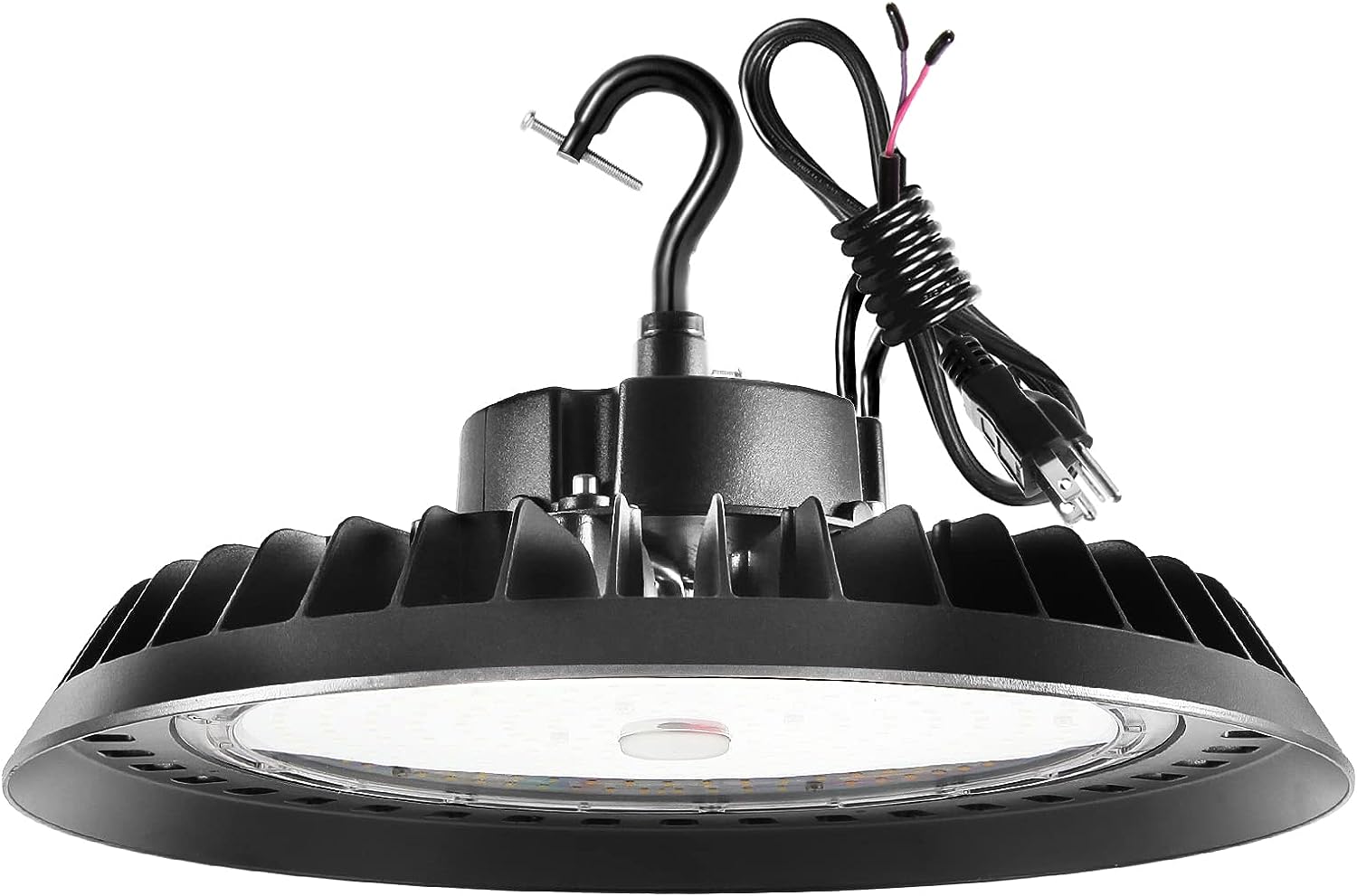

I put one of these above mine and it's very bright.
BFT LED High Bay Light UFO LED Lighting 100W 15,000LM 5000K 1-10V Dimmable,400W HID/HPS Equiv.5'Cable with US Plug,IP65 Commercial Shop Factory Warehouse Workshop Garage Barn Gym Lighting Fixtures

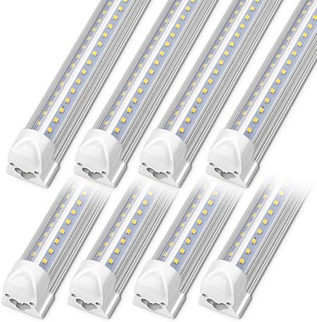

If I can offer a suggestion: Of course LED lights, but watch out for the diffused light covers, or multi-LEDs in a strip such as this:
In general these may be good or even great bulbs, but the multiple dots of light will reflect on a very shiny finish and reflect as a "1000 points of light" in a manner of speaking. It will be pretty. However, if you are to the point that you want to know if you have a perfect finish, a small pin hole here or there will be hidden by all the different reflections from different aspects, and all the pika-pika light spikes on the finish can mask small imperfections from being seen well.
Many lights will have LEDS like this, but the covers that blend all the lights so that a strip looks as one solid light will allow you to see the whole of the finish more consistently. At least this has been my personal experience.
