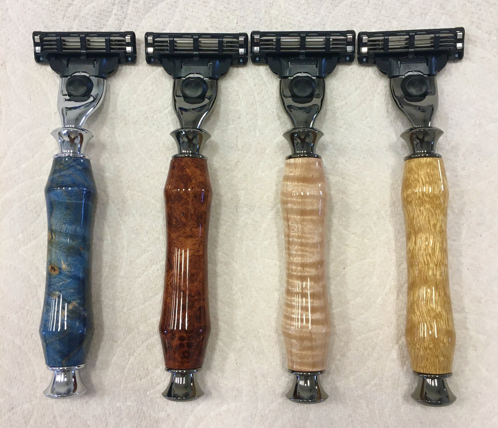

Noticed that I needed more razors for a show, yes a show, this weekend. Most of my razors are brownish and attractive so these will add to the spectrum. Blue stabilized box elder, amboyna burl, fiddleback maple and satin wood (I think- a gift). The chatoyance in the maple and satin wood is other worldly.

very nice, how are you finishing them?
The were finished as I finish my pens. Maybe a bit more CA as the get wet.
Turn and sand twice with 400 grit
Clean with alcohol
4 coats EZ Bond thin 5 cps
Spray Stickfast accelerator
12 coats EZ Bond thin 50 cps "pen finish"
Spray accelerator after each coat
Sand with 400 grit to level
Buff on the Beale buff
