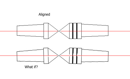

I don't understand the idea of assuming the alignment is correct if the points come together.
There is more to it than that.
What would happen if one or both of the centers were out of axial alignment? This can be horizontal, vertical or anywhere in between.
How would the turning of the centers inside the bushings be effected?
Of course there is more to everything in life my suggestion was a start point it could be a fluke if the points meet exactly as I described certainly the area of interest varies from half a pen at a time to two halves or one piece pens or bowl or whatever. the single fact remains that this my suggestion is a known fact working from a known always trumps the unknown.
