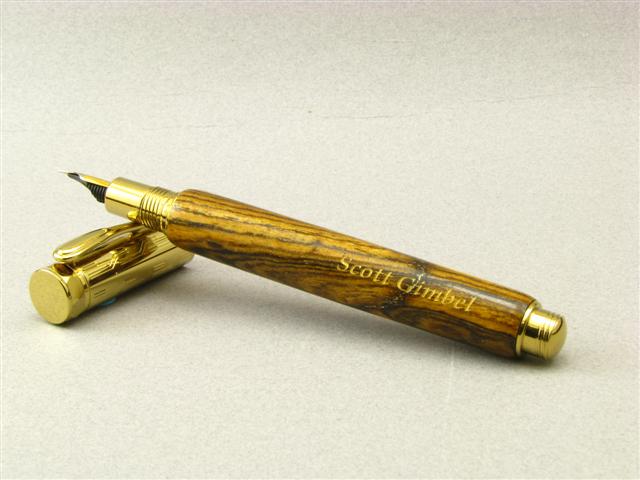

My PITH partner was Scott Gimbel from Round Rock TX. He has asked me to post the pictures as he hasn't any.
First a couple of his to me.
attachment.php
attachment.php
It's a Roman Harvest RB, turned from X-Cut Tulip Wood. He also added in the box more pen blanks in both wood and acrylics than I will ever turn in the remainder of my lifetime! And the leather bound pen box was an added bonus!
Thanks, Scott! It's been put in a special place with rest of my pen swaps.

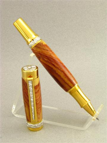

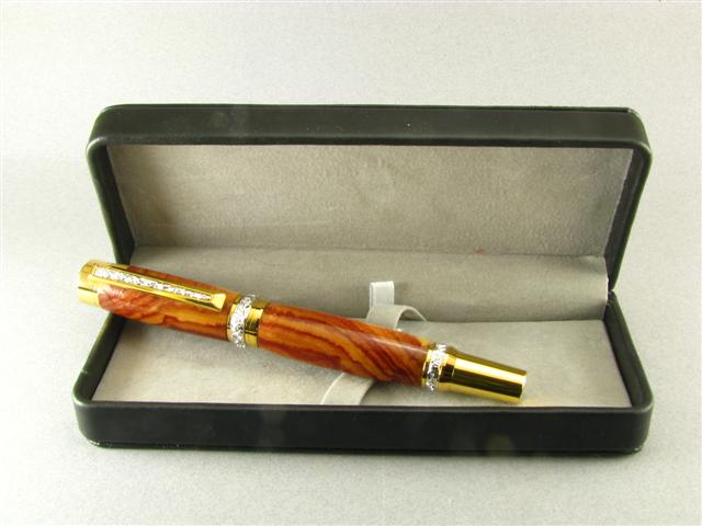

Now mine to him, with no comment from me. I will leave the comments to Scott.

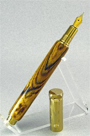

Mack is that Bacote??? It has a distintive strong grain pattern. If so how was it to put a finish on?? Thanks for showing and both parties did well.
It is Bocote. I didn't find it anymore difficult to finish than any other wood I finish.
Sanded at 600 grit, then 0000 steel wool, all parallel to the ways of the lathe. Then a good spritz of ZIP KICKER CA accelerator to remove any surface oils.
I wiped the above off with the lathe in motion. Then about 4 - 6 coats of thin CA, letting that dry overnight. Sanded very gently with 0000 steel wool in the morning, and buffed with my Caswell buffing and polishing compounds.
If the truth were known Bocote really doesn't require any surface finish at all, because of the oils in the wood.
I opened my PITH pen to a great surprise. It had its own homemade wood box. The pen is a Stretch Fountain Pen from lau lau in Hawaii. It's Bacote with Titanium gold accents and even has my name engraved on it. I"ve never written with or turned a FP so I have a little learning to do. I couldn't be more thrilled with what Mack did
