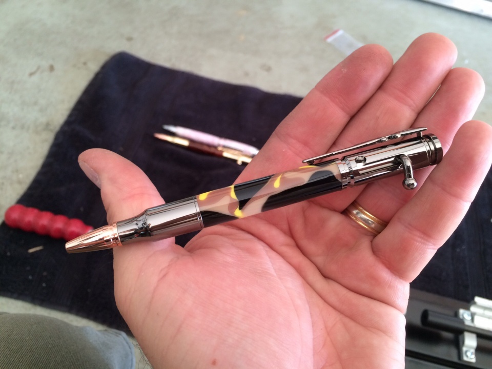

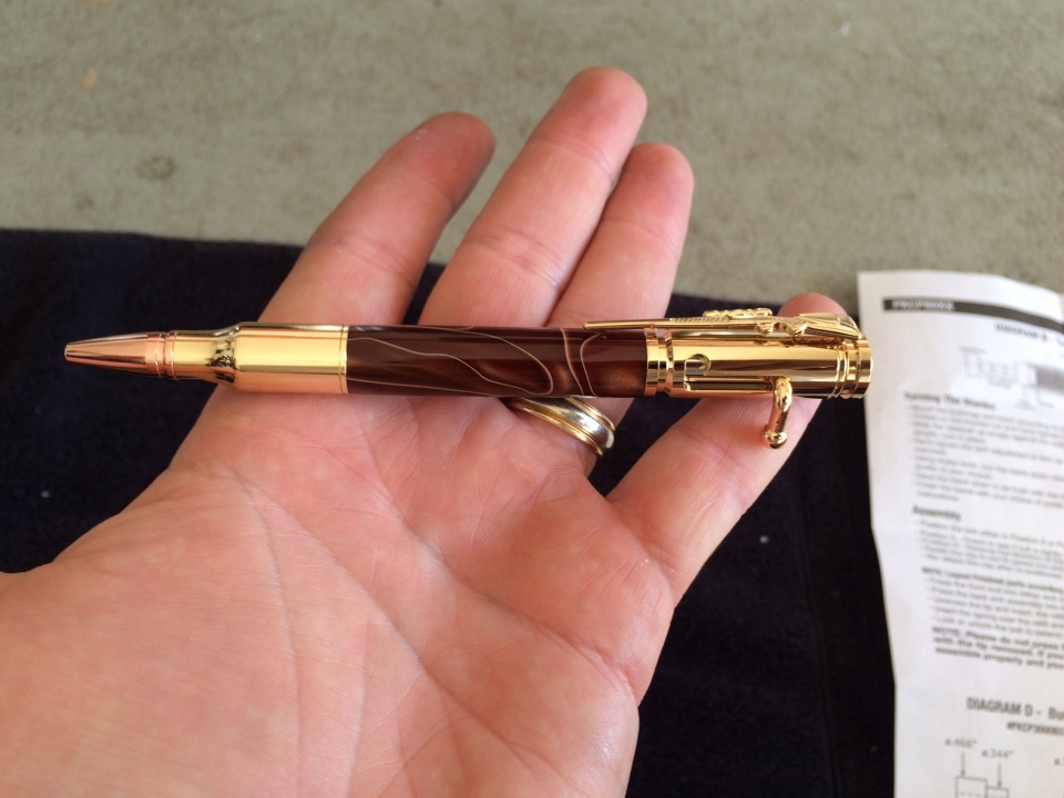

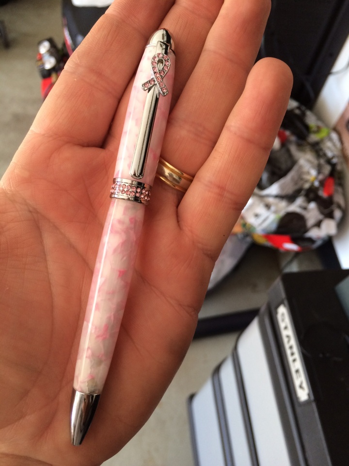

MrKugelschreiber Member Joined Apr 6, 2015 Messages 244 Location Florida Sep 6, 2015 #1 Not bad for a newbie with his 7 year old son!
D Drewboy22 Member Joined Aug 21, 2015 Messages 727 Location San Antonio, Tx Sep 6, 2015 #2 Y'all did a great job!! How did you finish them?
L Lucky2 Member Joined Mar 2, 2012 Messages 1,502 Location New Brunswick/ Canada Sep 6, 2015 #3 Three nice looking pens, you got a nice finish on them. Len
MrKugelschreiber Member Joined Apr 6, 2015 Messages 244 Location Florida Sep 6, 2015 #5 Turned with carbide tools...micro mesh finish to 12000 (wet) and then 2 coats of Meguiar's Plastx polish. The pictures don't do them justice, they are like glass.

magpens Member Joined Feb 2, 2011 Messages 15,907 Location Canada Sep 6, 2015 #7 Congratulations !!! . Those are lovely !!! . Well done !!! Did you paint the hole ( or tube ) for the pink one ? . What paint did you use ?

MrKugelschreiber Member Joined Apr 6, 2015 Messages 244 Location Florida Sep 7, 2015 #10 magpens said: Congratulations !!! . Those are lovely !!! . Well done !!! Did you paint the hole ( or tube ) for the pink one ? . What paint did you use ? Click to expand... Yes, I sprayed Kryon white paint on the tubes. I do need to find something that dries faster!
