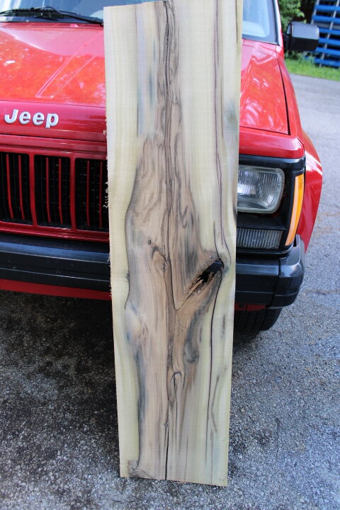

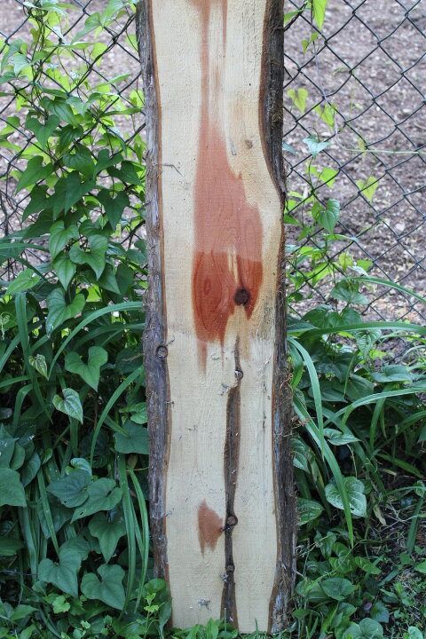

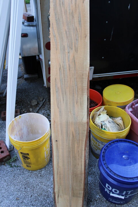

So toward achieving this goal I've been exploring different wood species to see what kind of color/texture movements are commonly seen in them. For my idea to work I'm gonna need color movement in wood more than just common grain direction like you'd see in the oak species. I'm gonna need a wood species that produces a wide variety of movement and colors for the best results. At first I wasn't too sure this process was achievable because all the wood species I was aware of didn't have enough varied movement. I found a lumber mill a couple hours away that had some ambrosia Maple so I went to pick some up for experimenting. When I saw the cedar there I picked some out as well. But then I saw a chunk of highly colored rainbow Poplar he had sat aside and knew that was the right wood to work with. It has so much more color and movement than any other species I've seen so far. Pics of the cedar, ambrosia Maple and rainbow Poplar follow...
You can see how the rainbow Poplar has so much more variation compared to the ambrosia Maple and Cedar that it's really the superior choice for what I'm trying to do. Imagine this rainbow Poplar piece cut into tiny 3/4" x 3/4" squares and how varied each square or 'pixel' would be compared to the same pieces made out of the Cedar or Maple.

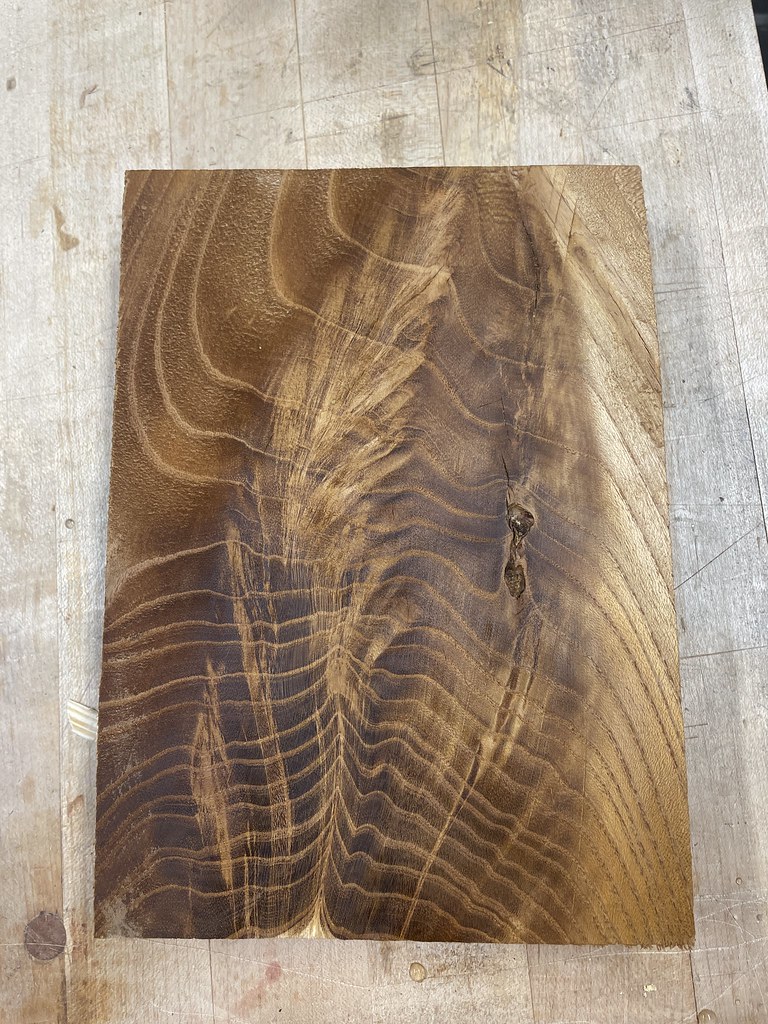

I find you can get that sort of movement, trick of the light, with a number of woods particularly when using a crotch piece. I've seen it with walnut, and have a chunk of crotch mulberry that has created pens like that. Here's the original piece. I've made a couple of pens from it where the figure really dances in the light.
Yes, chatoyance would fit my needs but from what I've seen that kind of figuring can be fairly expensive. Almost any color or grain movement would fit my needs...just so it's not regularly grained wood like oak with it's predictable light and dark color bands.
