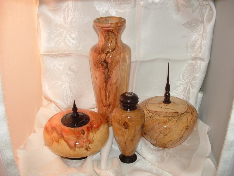

This is a group of items other than pens I have made. Alice
I guess I should have said what the materials were. The tall vase is Yew. Tough to work with when dry! and by the way,--- poisenness(sp?)
Item to the left is box elder and ebony. The next smaller vase is made from lilac, ebony and a cabachon of some sort of stone. The next one is cottonwood spalted and a bear to turn because it tears out very easy. The finial is ebony, lovely wood to work with, as we all know!
Alice

They look great. I just got a Barracuda system and I can't wait to find time to start learning how to turn bowls and such. Good work.

Very inspiring work! I have a bowl (my first) for which I have not made a lid yet. It has been in my mind to make ebony accoutrements like you did. Beautiful work!

Those look beautiful. I really like the cottonwood vessel. The grain on the lid mathches nicely with the base, and the finial looks great.
What hollowing system are you using?

Your work in turning and finishing these bowls is absolute beautiful to look at and it would have to be much prettier in person.
You have brought the hidden beauty of God's wood and you should be very proud of these pieces.
Keep up the excellent work and the market will beat a path to and through your doors. :biggrin:

For those I just used hand held hollowing tools.
One wood that makes great finials is epa(spelling?). It is used for making decks. So if you can get your hands on a scrap piece you will have enough forever. It is fine grained and stains well. Although with a finish, it is a rich brown color anyway or if you use a black dye you have "ebony" Alice
