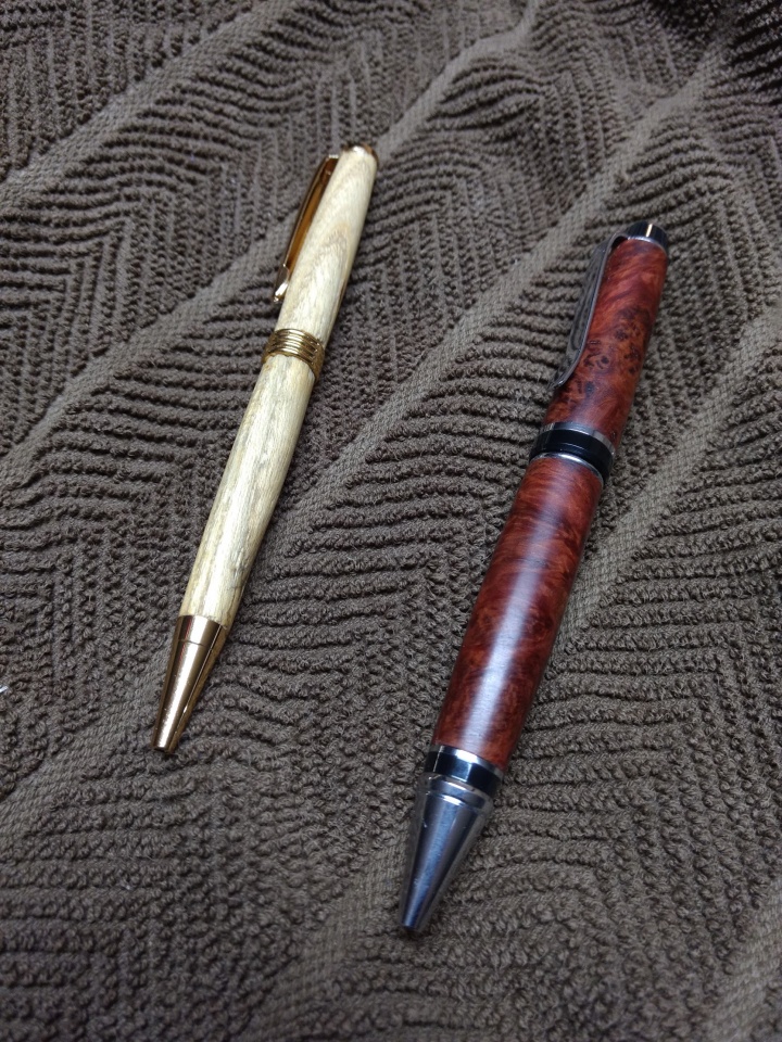

Heres a couple I tried. The first I did was the comfort twist with some slightly spalted fog wood, not sure of the species maybe elm. The sanding gave the grain a deep 3d feel, the finish makes it feel a bit smooth and silky.
The cigar is fitted with a chunk labeled australian burl. I sanded to 600 and buffed on two coats, let it dry and hit the beal buffer. I like the soft smooth feel to it. The finish does not fill, so all the little nooks and crannys are exposed and the wood feels like wood.
One note, because it doesnt fill and build thickness pay particular attention to sizing, leave a bit proud and sand down that last bit if you arent sure of turning to eaxct dimensions. It needs a day to dry good, maybe a few more for a full cure. On nice thing I notice is you dont need to diassemble to touch up the finish because it wipes off the metal and plastic quite well.
I want to try a few more species and see how well they take the finish, also see if stabilised wood will take the finish.

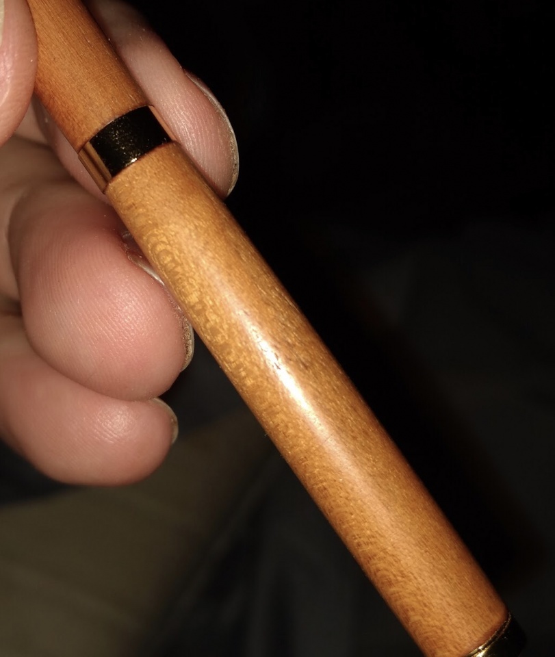

This slim is in cherry I think, sanded to 600 and when putting on the finish I friction polished it with the buffing pad then the same with the paper rag.
How good it is will show up on carrying it around for a while to see if it takes a beating.
