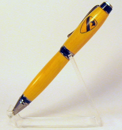

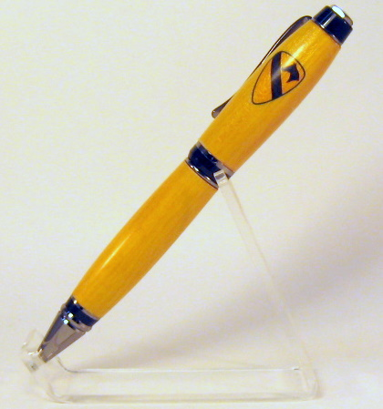

Tom, I made this pen for my barber. A couple months later, he showed it to me. The wood was an ugly brown, and CA had cracks all over it. I couldn't believe it was the same pen.

Nice pen!! you have to wonder if there is some chemical - cleaner, hair product etc that the pen was exposed to causing the problem. I have made 3-4 osage pens with no problems at all. Question was the plating in good condition?

Thanks Keith. No cleaner, no hair products or other chemicals. Ends of both tubes were sealed with CA. Tubes were glued in with two part epoxy. Therefor I think we can also rule out Plating, which was indeed in good shape. I bought the blanks here on IAP from a member who advertised them to be Osage Orange. I had no reason to doubt it. As Kenny Durrant indicated in his first post, my pen did indeed turn brown. I just wanted to tell my friend Tom about my own experience with what I thought to be Osage Orange. You must have gotten the good stuff.:)

By the way Chuck, that's a nice looking pen. Too bad it didn't stay like it looked here. The late friend that sent it to me made high end furniture so I'm pretty sure it's what he said it was.
