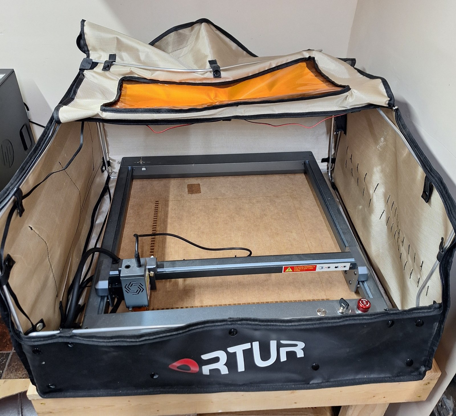

TITLE CORRECTION!! The Rotary is unopened!! I have this outfit for sale but I cannot ship it. I am willing to drive 50 miles or so. This engraver is used, but not by me. I bought it thinking I would someday learn the software, and use it. But I bought another lathe instead!

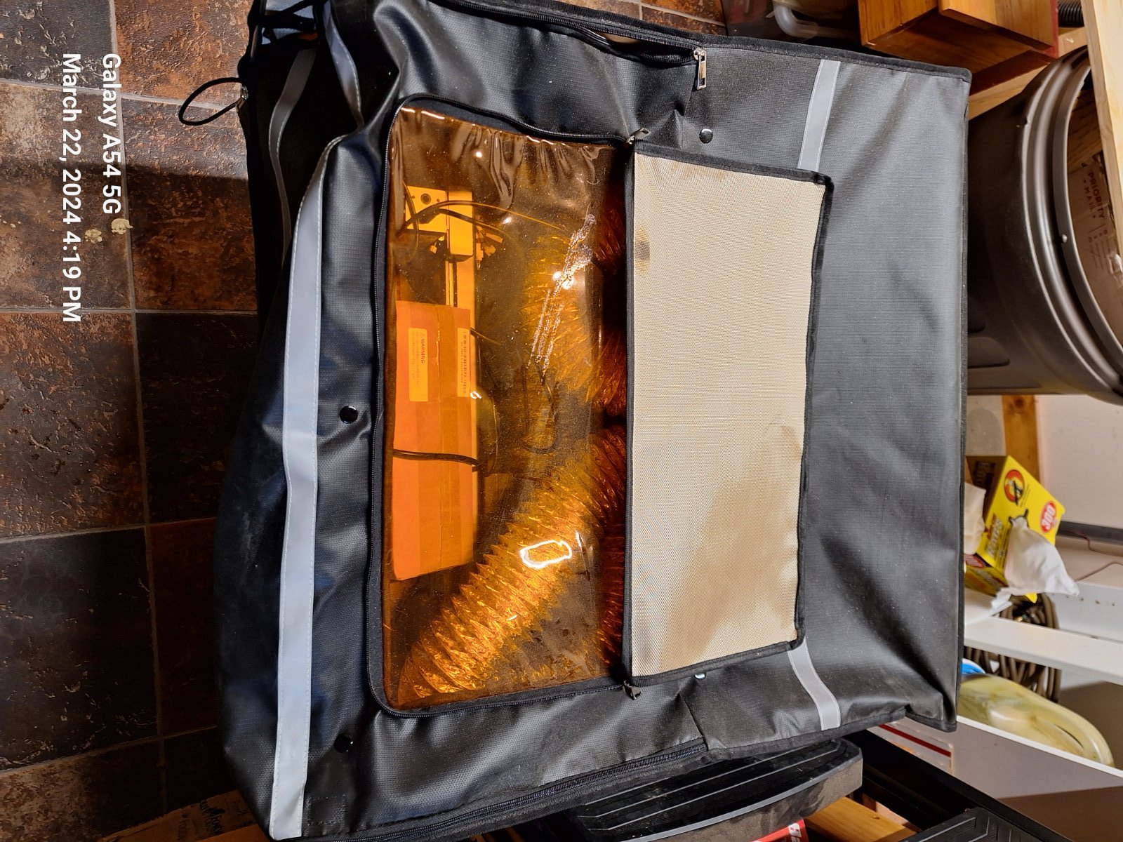

It comes with an enclosure that has a zip open/ close laser screen window, glasses, exhaust fan with hose.

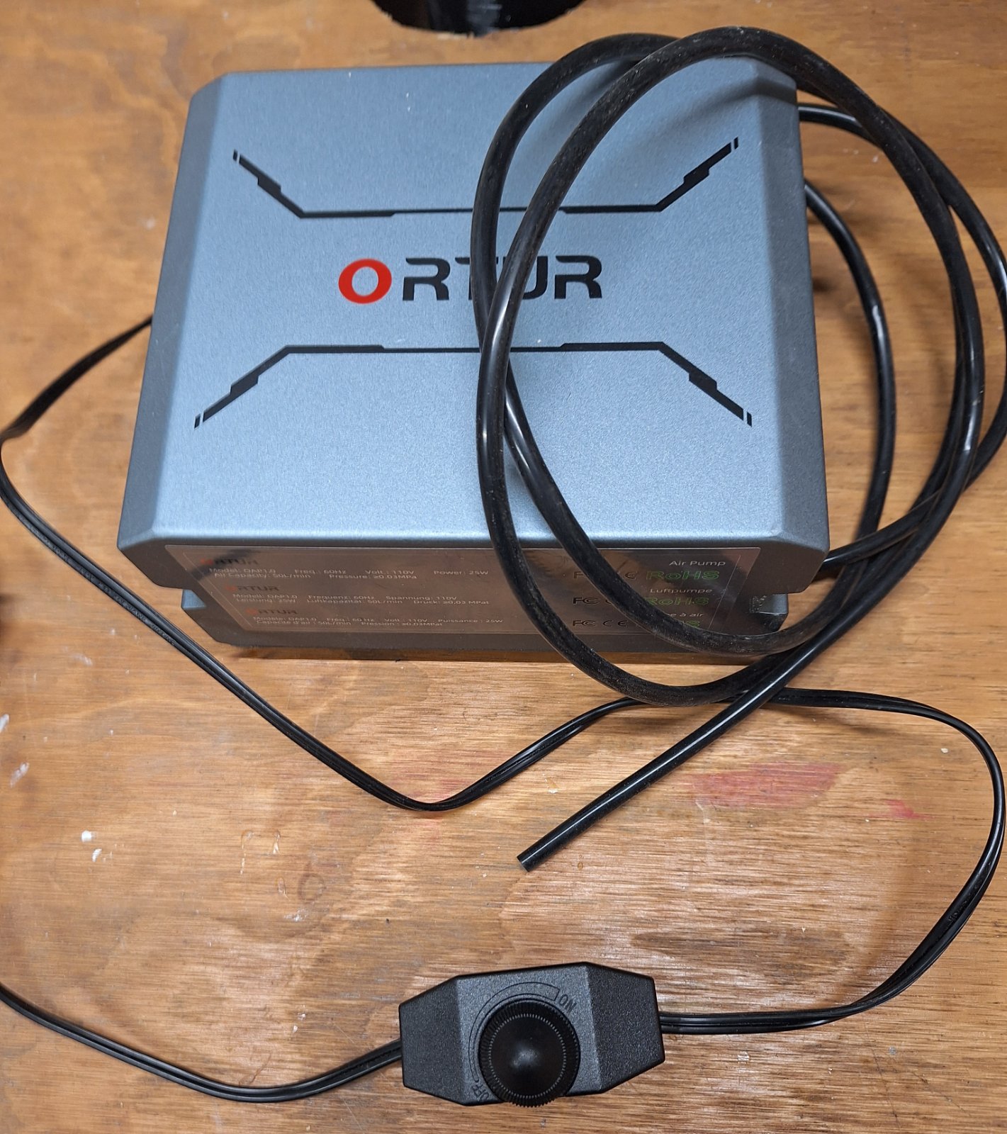

It has an air assist pump with adjustable control switch.

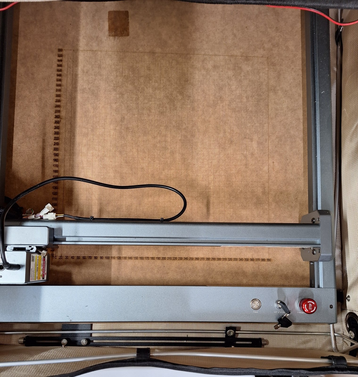

A grid board that has the grid for burning already done.

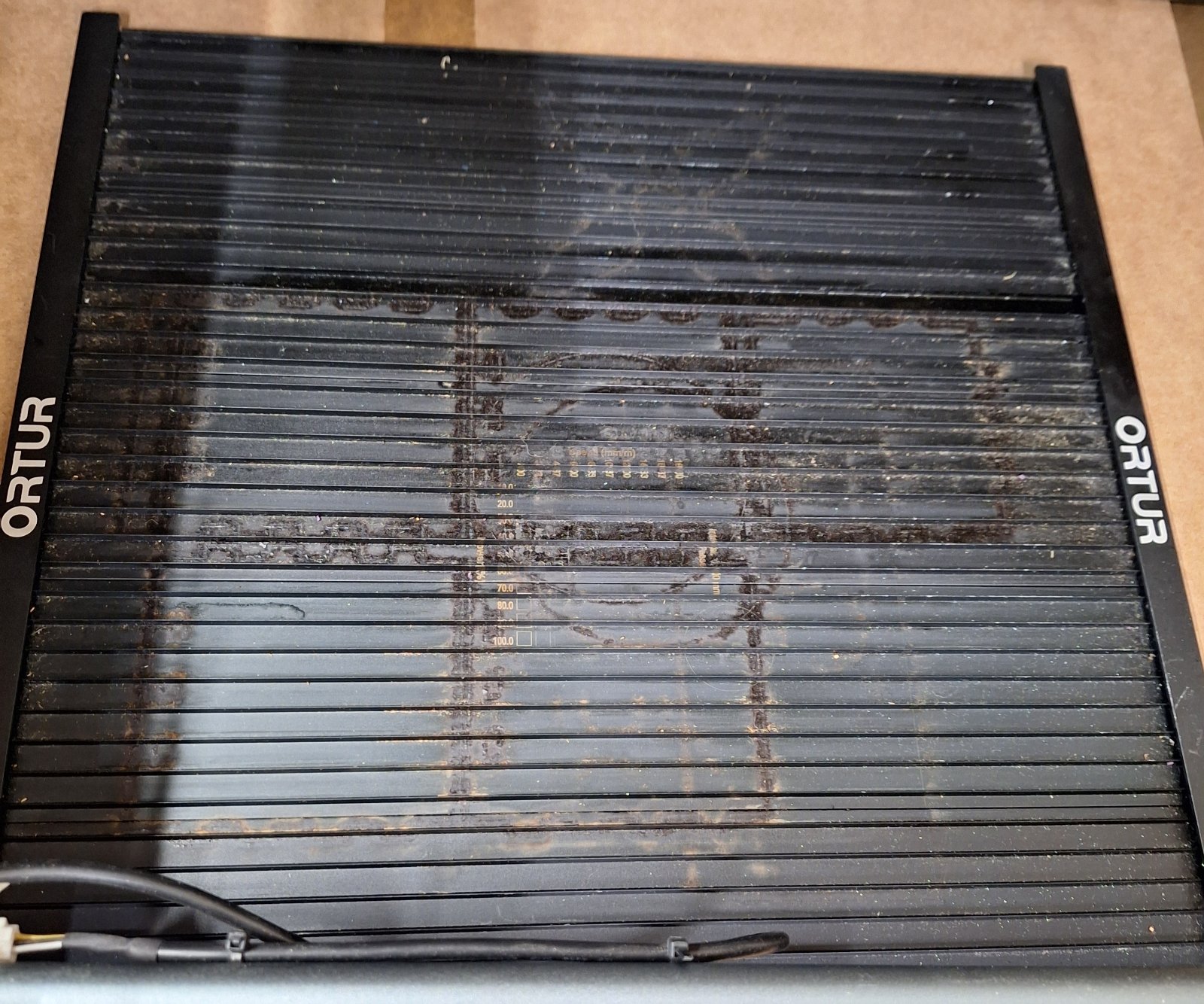

A metal plate for burning through materials. Includes a T square for alignment.
