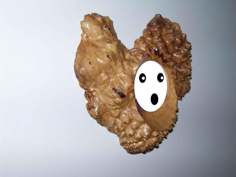

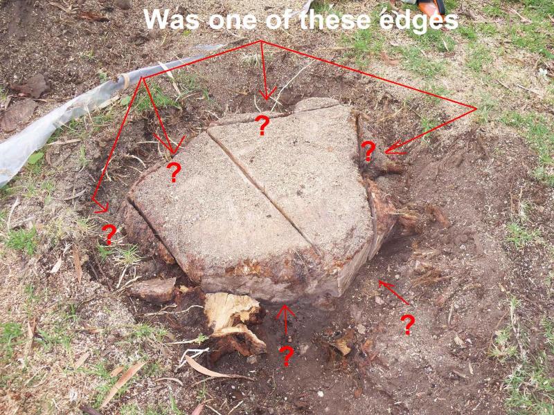

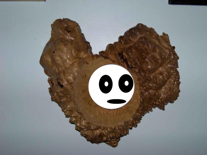

Anyhow, here they are, the first one is a edge we cut from the last Platypus gum burl episode (root part) which didn't look much when I cut it to access the centre part of the square we cut out but, when I was washing the dirt out of it, I turn it with the cut face up and I could see, the Australia map configuration (close enough). The front has a thick layer of bark so it took me "forever" to get that bark off, something I don't recommend anyone to try as is just an impossible tusk, when it still green...!:mad:
A little turning, (back and front) to accommodate an old wedding pic :tongue:, a little varnish and voila...!:wink:

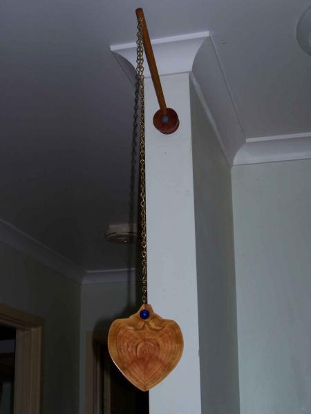

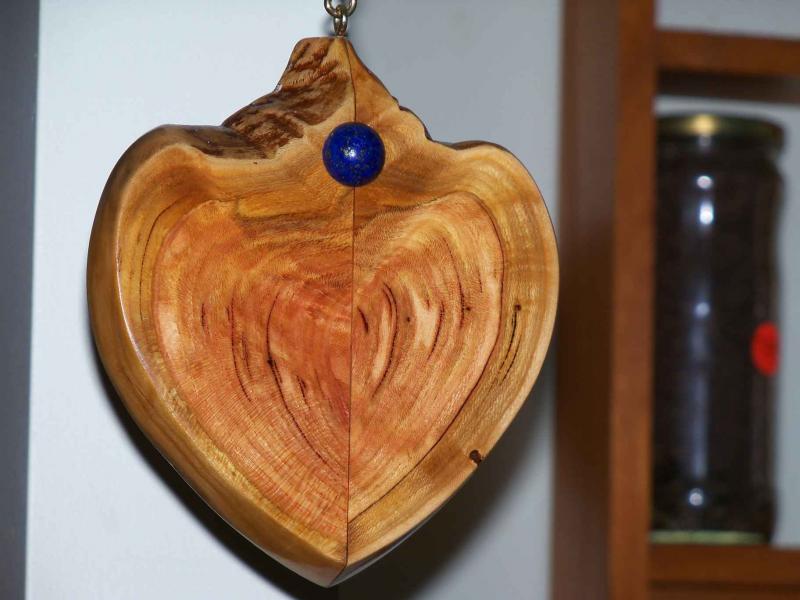

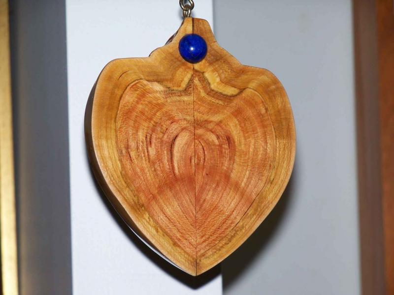

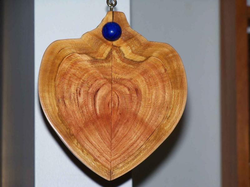

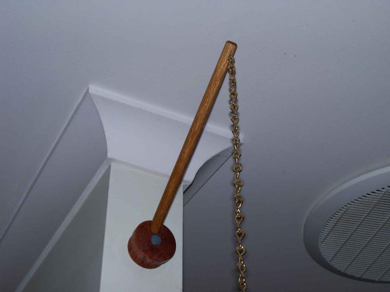

The second one is a very small Almond burl I cut from a old Almond tree at my doctors clinic yard, 4 weeks ago...!
The 2 middle slices were joint together with a bit of epoxy glue, a little varnish, 1 round Lapis stone I had for my knife handles making, cut is half, a bit of chain, a stick and a bit of She/Bull-Oak turned as a hanging base and voila, another piece of "ornamentation"...!:eek::biggrin:

But how do you make anything for Merissa without her seeing it? I agree with Larry the real wedding picture would be better, your self portrait needs a little work ; )

The Almond piece has amazing colours, reason why I needed to not waste its look. Quite frankly, I'm not expecting these piece to last forever like that, as Almond has all these beautiful colours when green but when dries, it changes considerably.
The wood was very green and I (again) did try to stop nature to do its thing and capture the best colours and grain pattern for as long as I can, the wood wasn't dry when I trimmed it to joint with epoxy, as the small burl was cut from the tree 4 weeks ago, sliced when I got home and then soaked in Fungishield for 24 hours. After let it drain and dry for a week or so, cracks where developing, there its, separation of the heartwood to the sapwood, which I glued with CA under compression.
After a few days I decided to stabilize it with Fungishield under pressure on my pressure pot, The idea was to force the Fungishield through the wood and push any of the moisture (water) out, 120 PSI is all I have so maybe not quite enough, will see...!
After letting this dry again, then I sanded and varnished it with Floorseal, after my attempt to coat it with the liquid glass or liquid gloss as many may did fail. The coating looked perfect as certainly looking the way I wanted as this stuff was about 2mm thick all around and is rock hard when dries, which would assist me with the attempt of preserving the piece as it is for as long as possible but, for some unknown reason, the part A and part B mix, wouldn't set/dry, after I spend nearly 2 hours in the sun holding this thing changing positions every few seconds to void runs.:mad:
After that time I had no choice than, remove all that sticky stuff, let dry and start again with my trustful Floorseal. So, for the purpose I needed this piece to hold, there is a gift to my Valentine today 14/2/2011, is accomplished and will be kept "swinging" until nature takes over and spoils all my work to which, will not be wasted as I will cut it into pen blanks and make a pen out of it for her (my wife) as a replacement...!:wink:
Sorry about the non-pic Larry, personal stuff mate...!:wink::biggrin:
