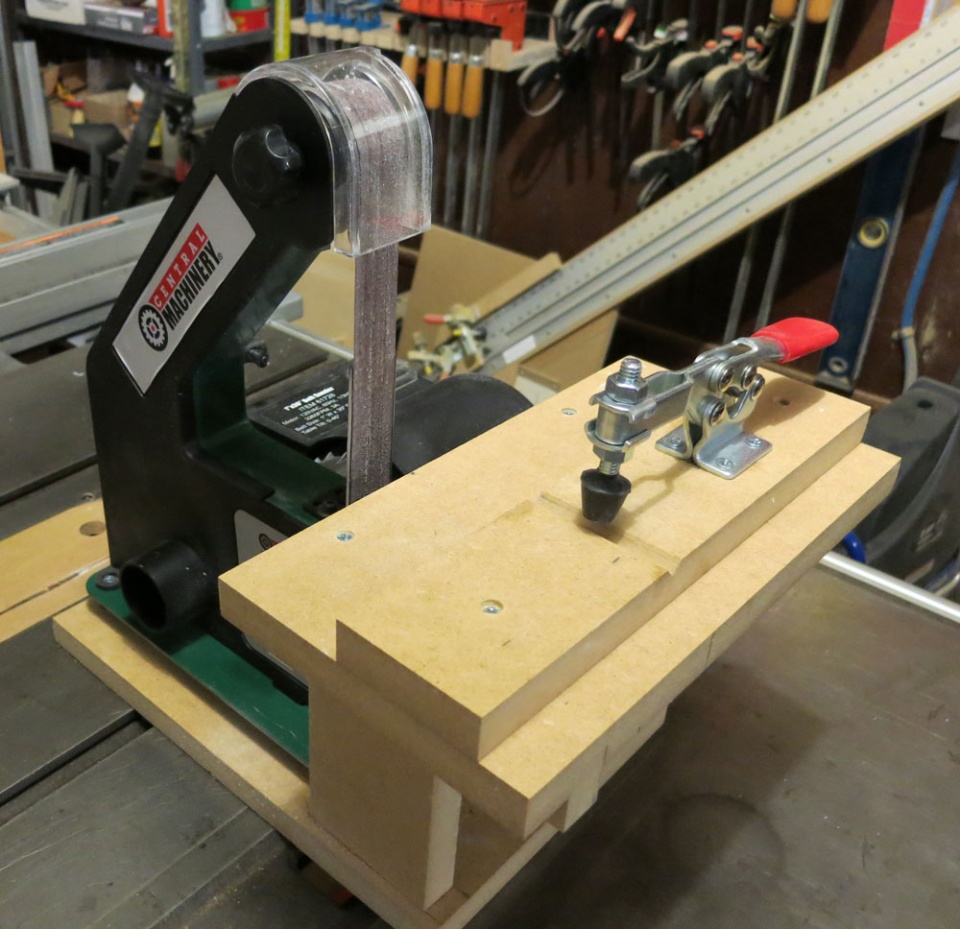

I've had one of the Ryobi sanders for about 12 years now, and it's seen its share of sanding and is still going strong. However, for pen blank squaring it was hard to keep that cheap miter gauge aligned. I purchased the Harbor Freight 1x30 belt sander and built a squaring jig for it. It uses a set of HF punches to align the blank. Picture is below if you're interested. The toggle clamp in the photo has since been replaced with a Bessey self-adjusting clamp.
