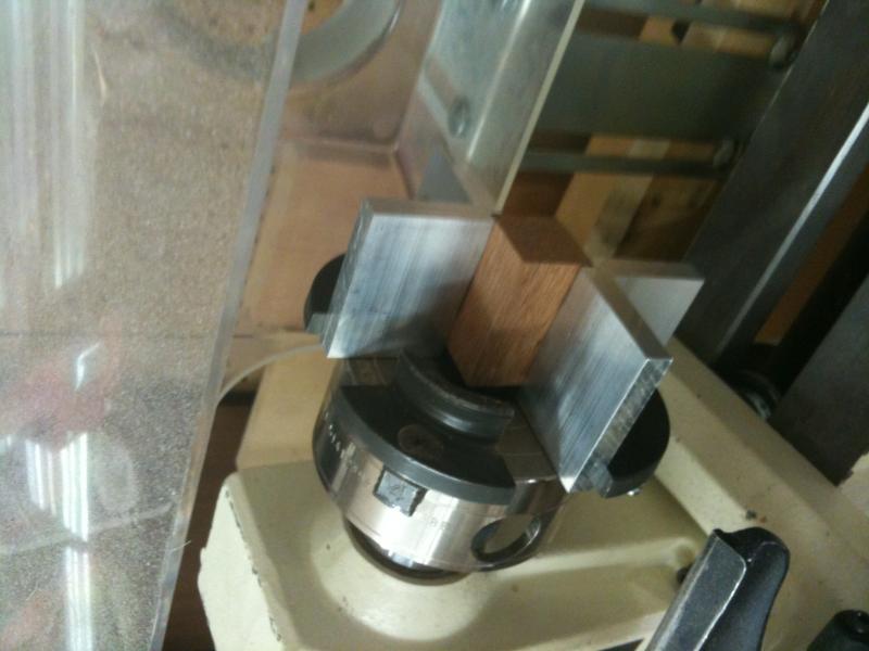

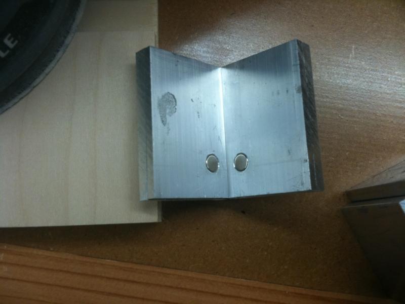

The latest issue of shop notes has a jig for drilling on the lathe. If you have a 4 jaw chuck I suggest doing this: There is a tutorial in the library on building these auxiliary jaws and it works very well and cost about $10.00 to make. The sharp corners should be rounded for obvious reasons (ouch).

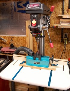

This blank vice from Rockler does a good job on my (not the best but in budget at the time) Craftsman drill press. It holds square blanks, round blanks, odd shaped, etc. pretty well. Can also be used to press pen together, but I choose to use my wood-jawed vise for that task.
