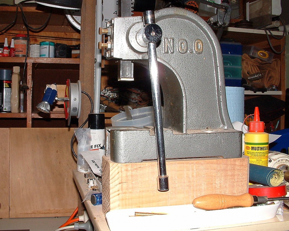

I use this Arbor press mounted at eye height where I sit to turn enables me to finish a pen etc where I sit. I have two sets of punches metric and imperial for closer fits to hold my blanks at the Sander to square my blanks and dissembly. I never regretted these items.
Peter.
