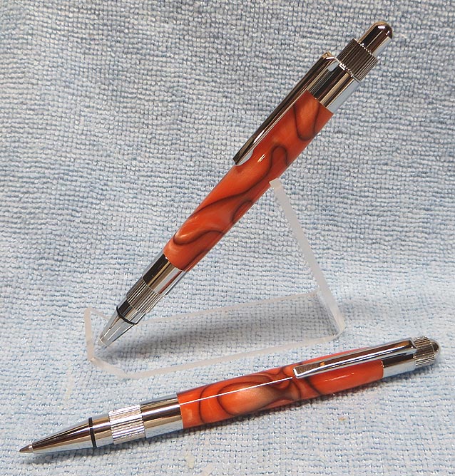

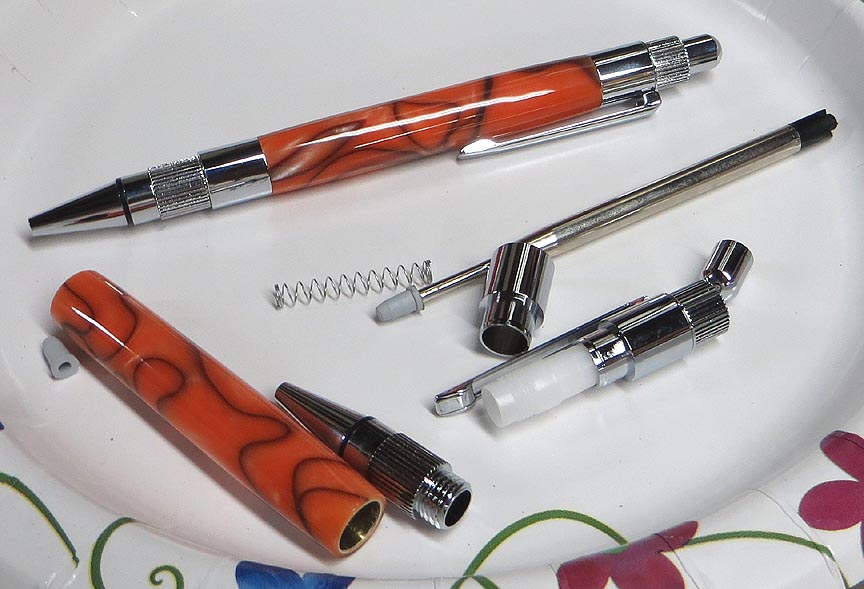

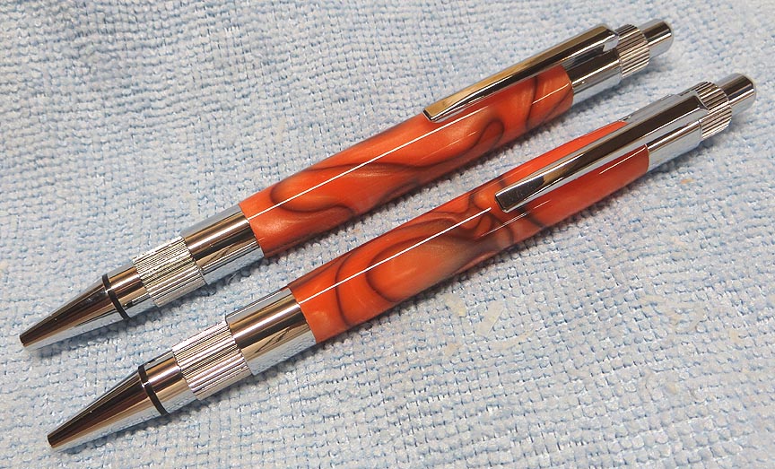

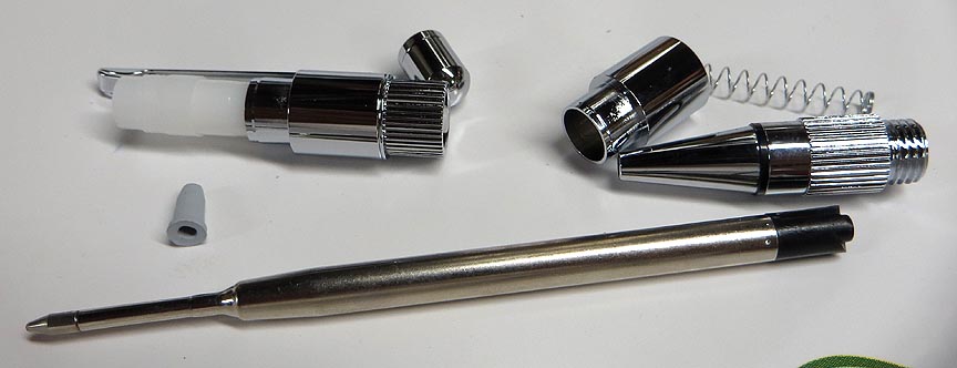

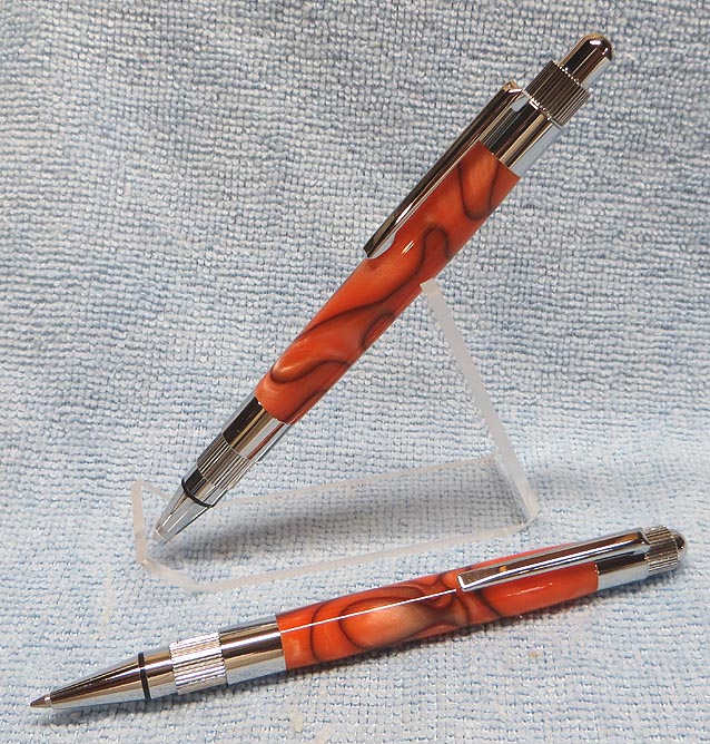

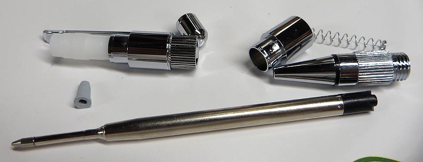

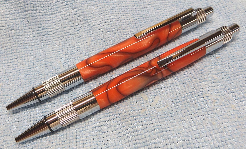

I haven't made a Stratus pen since 2015. It does use the plastic piece on the click mechanism. Never had any problems, but I haven't used it that much.
I have made the Duraclick EDC, which has that extender. They are not a problem for me personally, but I am somewhat concerned that a customer would lose or throw them away when refilling. I know the tube can be shortened to compensate for removing it but, as far as kits go, the blank is the only canvas for our art, and that doesn't leave as much blank to show off. Maybe I"ll try the "permanent" extender mod one of these days.
