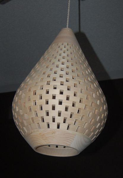

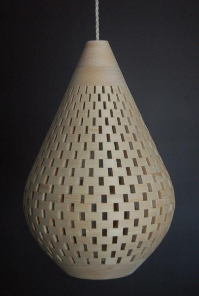

Since I've not been doing any pens of note lately, I thought that I would keep my name on here with this piece.
It's a prototype of a lamp that a friend a friend asked me to try. This one is made from milled 2 x 4's. I figured if I was going to blow it up, I may as well keep it cheap. It's 528 segments plus the top and bottom rings. Overall size is about 16" tall and just under 11" at its biggest diameter.
Having done this one, I'm really not sure if I'm up for another one any time soon. However, I'll never say "never".

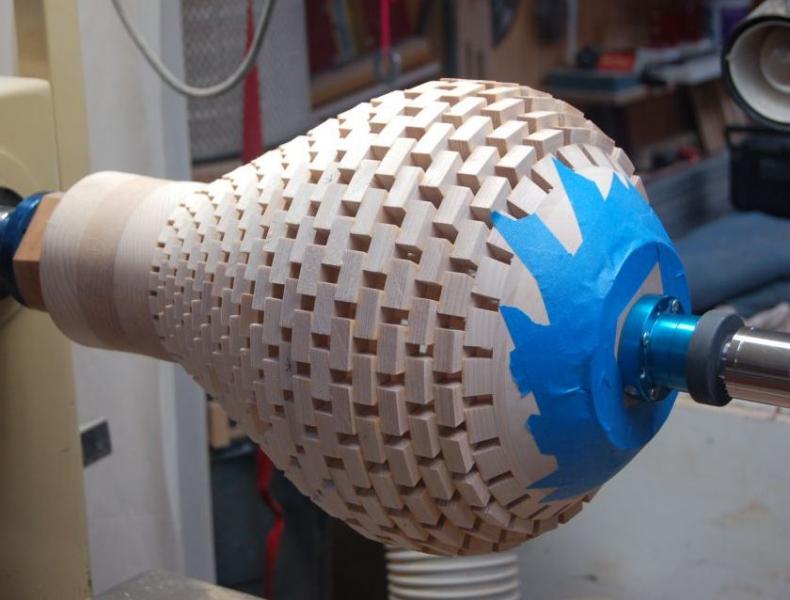

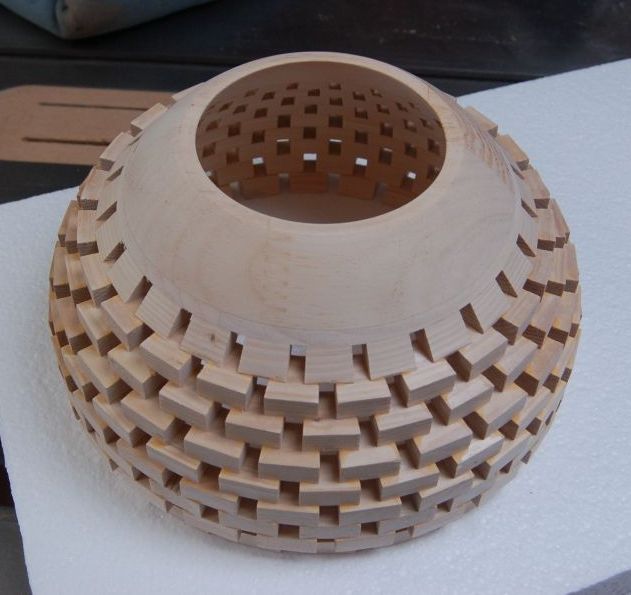

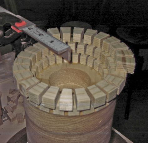

Mike(woodlvr), I'm attaching a couple of pics of the lamp in progress. I hope they work for you.
William: Feel free to borrow the design. If you like, I can send you the "map" of the piece layout and the spreadsheet that I did up in Excel that sets out the cutting list.
I want to emphasize that I couldn't have conceived of doing something like this without the help of Denny Edwards. He is the guy with patience. Putting up with my endless questions would challenge the patience of a saint. He has great movies on his site, showing step by step how to do these. Home
