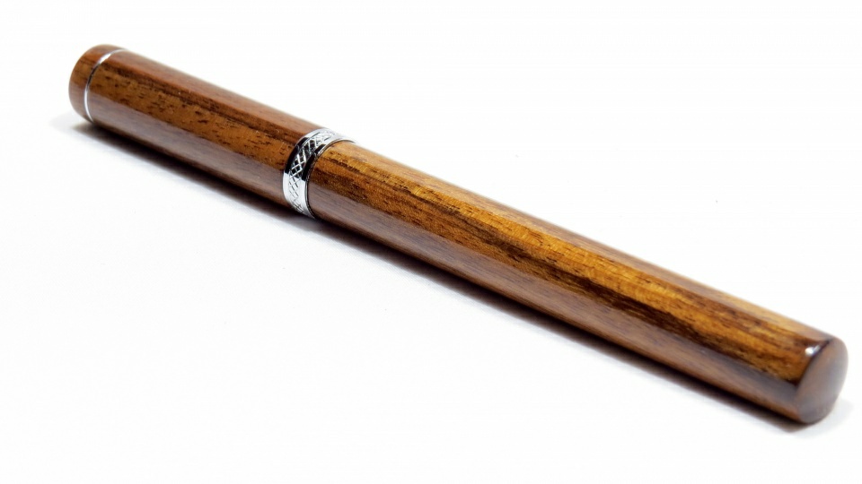

Shellac, oil blends, poly, and varnish work so well really no need to fill pores. I add lacquer because brushing lacquers mostly self leveling.
Here is an oak pen finished with lacquer, and no sanding dust or sealer!

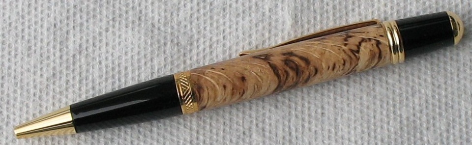

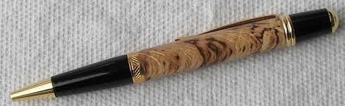

Low viscosity epoxy resin works great to fill in the pores on open grained woods. It also does a superp job of making the grain pop. Epoxies with a long pot life and UV blockers work best IMO. Walnut with epoxy and polyurethane clear coat.
