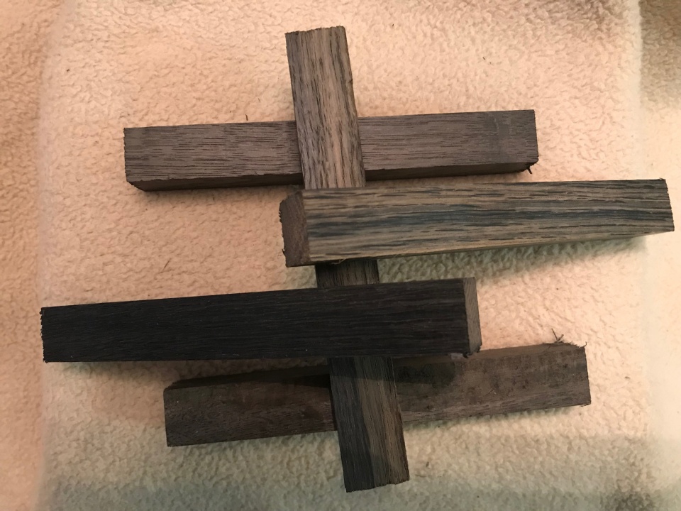

I received the Bog Oak blanks from TWVAMAN (Ireland)
I'd hate to waste any of this ancient wood with expeirmentation. So I'm hoping someone here can share their experience with this wood. I'd appreciate anyone's suggestions, recommendations or ideas for kits and finish suited to best display these blanks.
They are beautiful, Dark, Dense, Heavy, Open grain 3/4"x6"

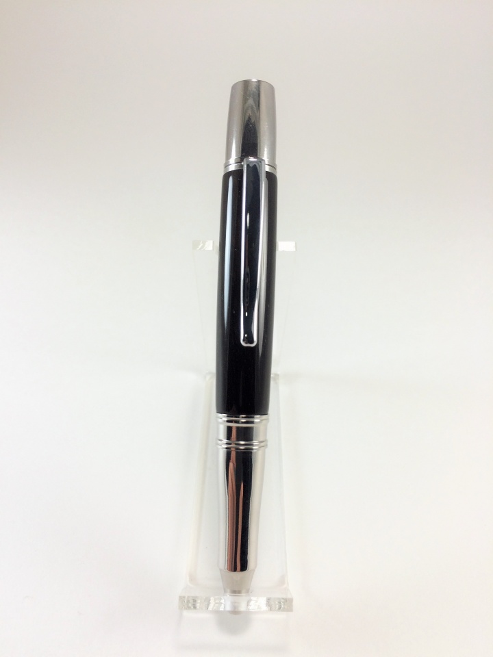

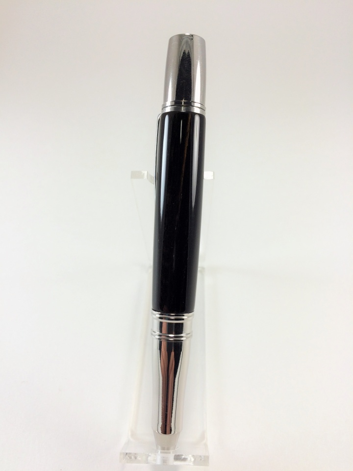

I made 2: one with CA (high gloss finish) and the other with friction polish (Pen Plus)). The CA finish made it look like black acrylic (no grain showing). The fiction polish preserved the look of the grain and left a natural finish. One was a liberty, coincidently, and the other was a professor/exemplar. Here's the Liberty. I didn't photograph the professor.
My experience exactly, Tony. Just not pleased at all with the end results using CA.
Nice looking pen!

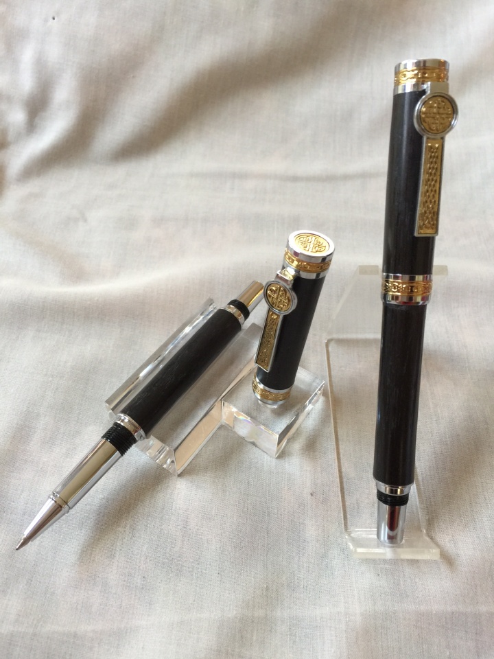

My favorite component set for Irish Bog Oak (IBO) is the Celticus and Jr. Celticus from Jimmy Findlay at WoodPenPro.com. I use Pens Plus to finish as I want the look and feel of the bog oak to be front and center as opposed to the plastic look and feel of CA.
A couple of Jr. Celticus pens:

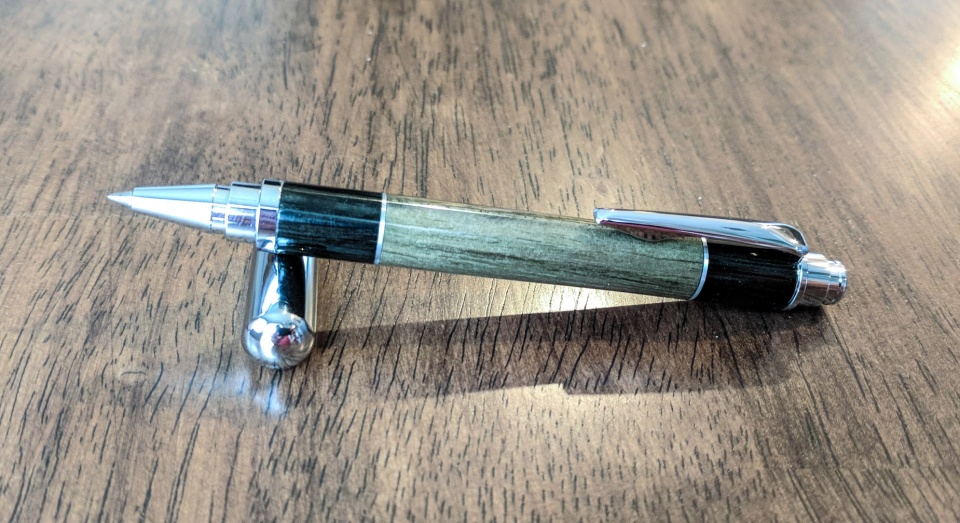

I have used one piece of bog oak, so am by no means an expert. The piece that I had was almost like charcoal, rather brittle but very black. It turned good, but I tried not to get too aggressive. As others have suggested, I chose the celtic twist for one pen and then did a simple segmented rollester with the leftover. For the rollester I chose to pair it with a green colored piece of blue mahoe -- I figured the Irish folks would appreciate the green. I did CA finish on both. If you use CA then be prepared to do a little extra work to get the pores filled, but I think that it has a nice depth when finished to high gloss.
Sorry for the bad photo quality, I have since improved my photography skills slightly...

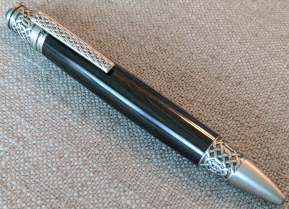

Ahhh! I copied that from my photo album. It's an oldie! Try this link
IAP Home - Photos - Curved Metal Segment
Wow! Outstanding!
I could not see how beautiful that turned out from the thumbnail.
Maybe I WILL try a CA or a poly dip.
Bravo Bravo:biggrin:
