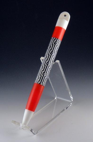

Here's my entry for this year. Only found time for one and wasn't even sure which category to enter. Based on the Parker style twist transmission.

Very nicely done but can you explain what we are looking at for those that have not followed your work for awhile. What is the blank made from??? What is the black and white portion made from??? Any other details can you if allowed to tell us more details??? Thanks for showing.

The black and white portion is on a Sierra style tube. The white was cast polyester. I then carved out the black areas on my CNC mill, filled with polymer clay, baked, turned and finished. The nib section has a home-made brass coupling with female threads to hold the transmission similar to the Sierra and also holds the nib section which was home cast red and white PR. A similar non threaded coupling holds the top of the transmission and the final made from the same red and white cast PR.
As for showing them off, the rules stated that was permissible after the submission date of September 28. Different from last year, but rules is rules.
