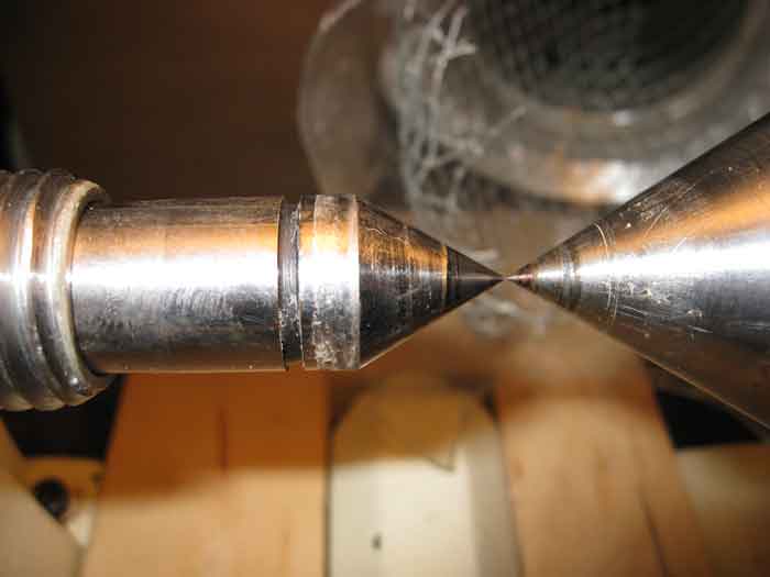

Do your centers line up when you bring them together?
Last I knew they did...but honestly haven't checked that in a while.....hmmm

Thanks for the thoughts.....will check them further and post again....I will try to take pics of the center alignment >< if it'll help....
