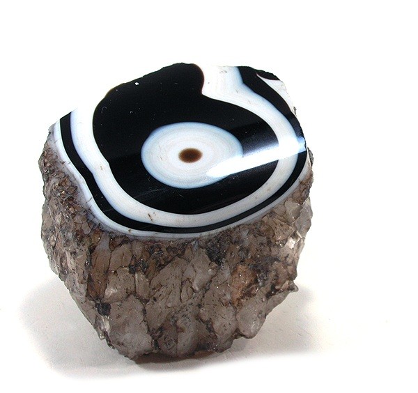

Hi Folks, hope I'm in the correct section with my odd question. I'm going to be removing an onyx counter from our wet bar and feel terrible about wasting that beautiful material. Is it possible to turn onyx, perhaps for a pen?
Thanks !

Yes, it is possible, but requires custom drills and drilling equipment. It also requires a lapidary lathe utilizing diamond tooling. Diamond polishing materials are also needed. Water is needed for cooling and keeping dust down to help prevent silicosis.
It's possible, but you'll need to design and build your own setup.
