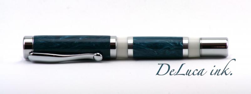

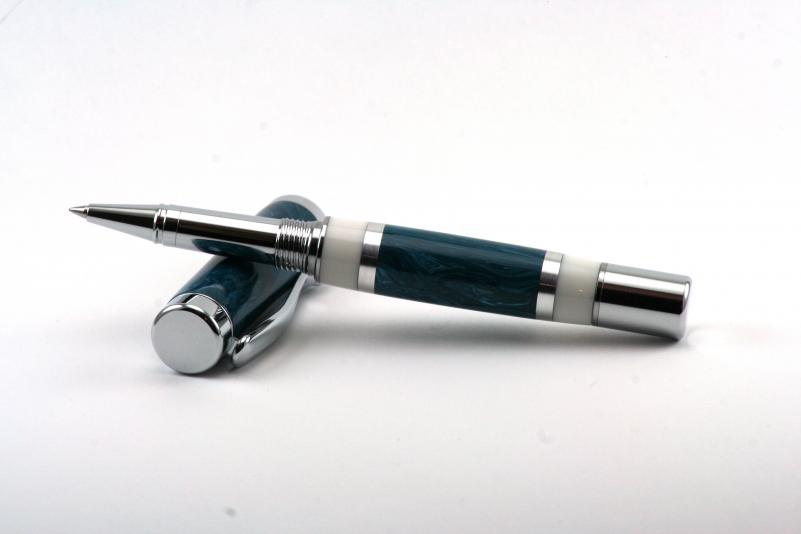

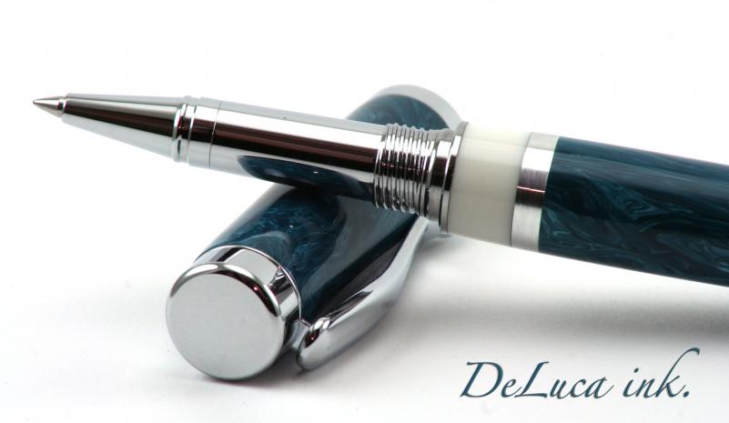

Should have only taken a few hours! I Made this pen, sorta, a few months ago, but i ruined the cap, and after assembly I noticed a small fiber in my ca finish! To the shelf it went as I am sure I had something else to make! Finially got around to reworking this one! I reshaped the body as it was not as straight then as it is now. CA finish on the body, regular good ole plastx on the cap, they dont shine any differently. The cap looks slightly underturned in the second photo...hmmm...doesnt feel that way! May take a closer look and refinish it, but I am sure with my luck on this one, it would sit for another few months :rolleyes: Anyhow Chrome Atrax, Segmented with Alt. Bone, Aluminum, and Ameado Teal from EB. Very solid feeling pen! C&C Welcome of course!!

Would you consider showing a pic like the first shot, but with the complete pen showing?
There's something about the look of the combination of the segmenting in the 2nd pic that's throwing me off.:smile:
Instead of a straight taper on the lower barrel you used a sharper drop mainly on the aluminum band and alt. bone. Really looks good. I like your proportion on the segements, especially the aluminum bands. Also, excellent combo on the colors.
There Ya Go...
Yup, much like it like that. With the cap on, not so much!
I only wish is that my imagination would kick in and tell me to do a pen like this!:redface:
Mack the original cap had an aluminum band about a quarter inch from the center band. It could for sure use something to tie it in to the body, but I believe I prefer it this way. Thanks for the comments though!
Sometimes the photo will make it 'appear' to be under-turned when it's just the finish allowing you to see 'into' the blank somewhat. That throws me off quite often also, and makes me grab the calipers to double check the triple check that was double checked....enough to drive ya crazy ain't it!
