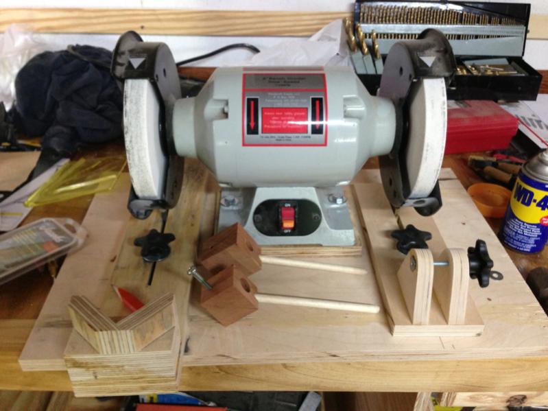

If you have done any welding, check out Captn Eddie Castelin's YouTube videos. In one of them he shows how to make a Wolverine -like- jig that he calls the "Black Hawk".

Bought mine from Woodcraft as well. Eddie Castelin sells his own version - The Blackhawk Sharpening Rig (or something like that) for less than the Wolverine.
Wish I had know this a long time ago. I like them simple and this one looks like a winner. Fact a person could pretty easily make one just form the picture, however looking at his prices it wouldn't be worth it to make your own. Like he says in his youtube video not as refined as the wolverine, but I bet it works just a well and surely gets the job done.
