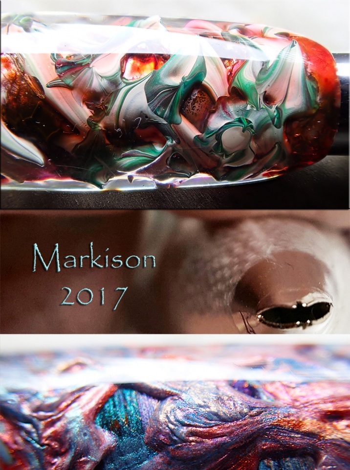

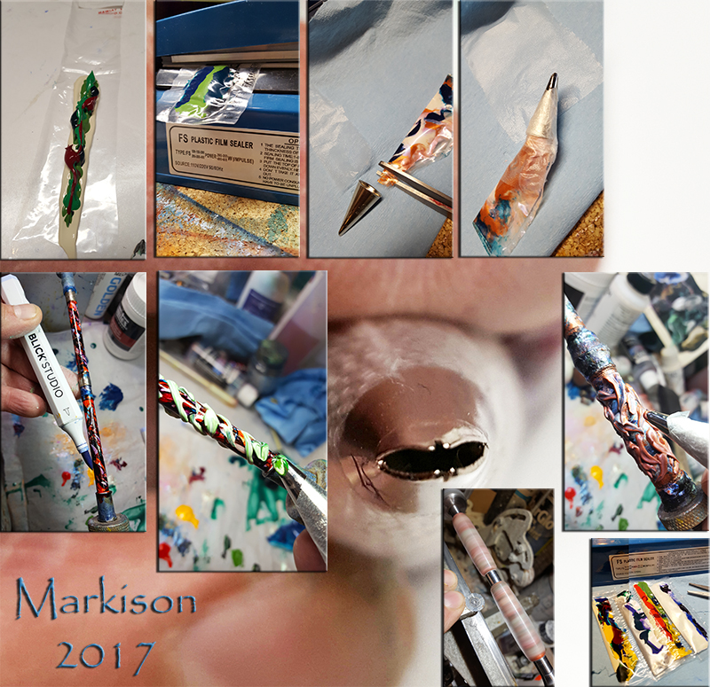

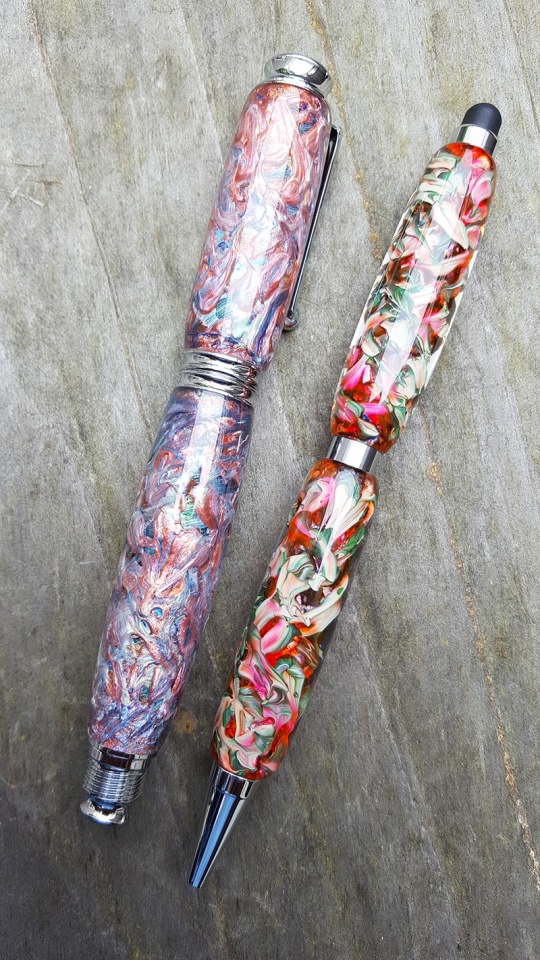

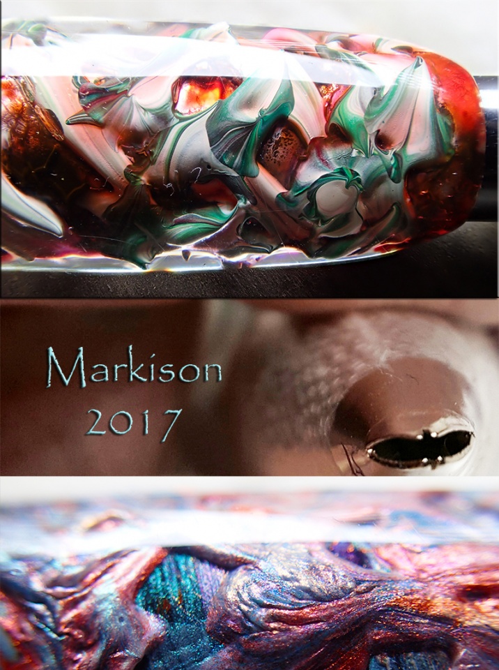

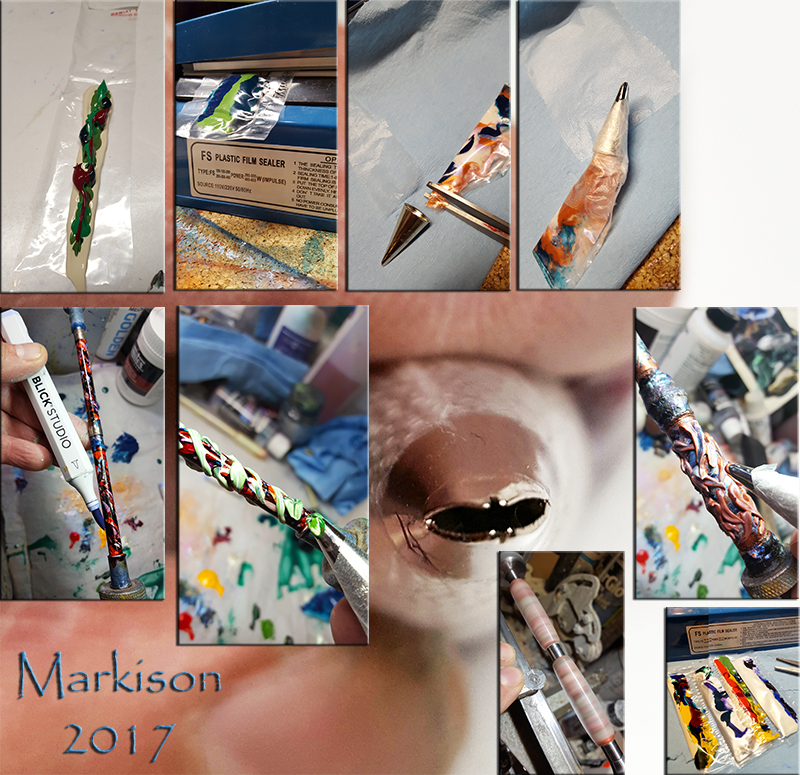

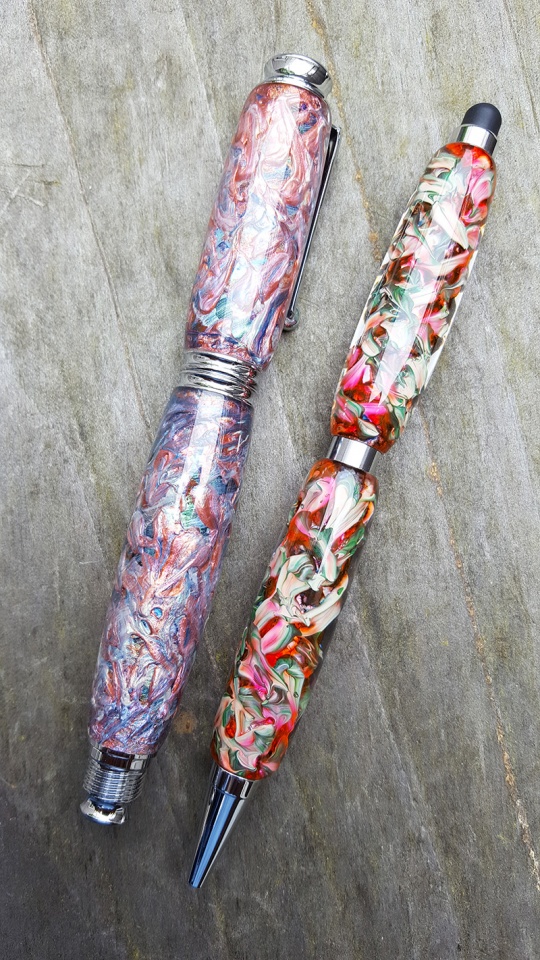

Decades after I'd piped innumerable cake frostings when the children were young, I had a little light bulb moment: Why not make some heat-sealed acrylic paint-filled tapering polyethylene bags (also recycling pen kit parts bags), cut the ends open, attach small piping tips with some press-and-seal wrap, do some alcohol ink underpaintings on brass pen tubes, pipe on some leaf-like "terrains", airbrush-seal them with Createx acrylic gloss top coat, let them dry for a week, tube-in cast them at 50psi with Douglas and Sturgess PR, turn them "fat" to avoid cutting into the "terrains", finish as usual and assemble? I realized that I'd be the same age whether or not I did it - so I did it.
Here are some techniques, a Virage fountain pen, a fat Slimline stylus pen, and some close-up views:
attachment.php
attachment.php
attachment.php

"Out of This World" Bob.
Do you Lay Awake of a Night Developing these Fantastic Processes in your Mind? or Do you Dream Them Up, then Awake, and Write them Down?
As far as the "Piper Pipping", You had me starting to Look for that "Partridge in the Pear Tree".
Joking Aside, I love your Inventiveness and Ingenuity, in particularly when Coupled with your Knowledge and Experience of a Vast and Comprehensive Range of Materials and their Individual Application Idiosyncrasies.
The Blank of the Slimline is Spectacularly Vivid, Very Crisp and Concise, Brilliant.

Piping heavy body acrylic paint out of a small tip results in some surprisingly fresh color blends - great fun.
The tips clean up easily with a spray bottle and small brushes (same brushes used for cleaning an airbrush).

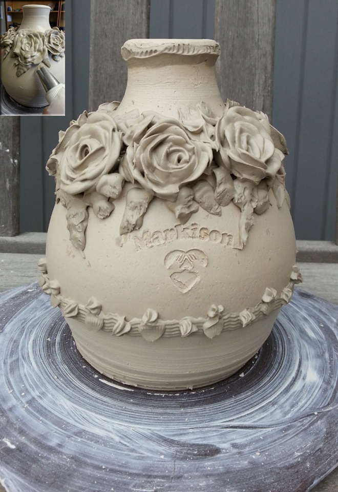

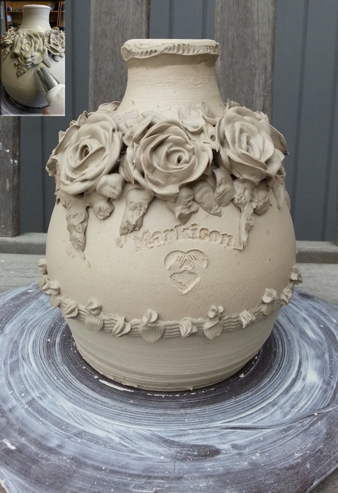

PS: The pen piping concept came out of a series of ceramic flower vases and fountains that I made a few years ago - clay formulas amenable to blending down to butter cream frosting consistency were adapted from articles published in Ceramics Monthly in the 1950's and 60's (when ceramists made their own clay bodies); and the working method sprang from dreams:
