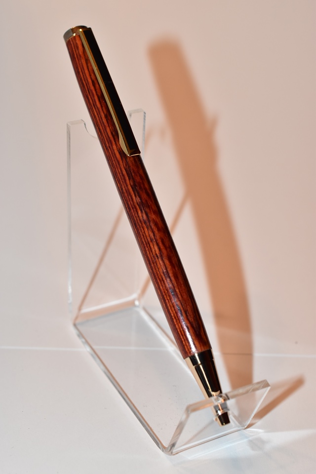

The other day I saw a one piece slimline and I had never heard of it. I looked up the tutorial in the library and made this one when I got home. It was the only slimline kit I had on hand. lol This one is done with spectraply.
I enjoy making these much more than the 2 piece. I like that you can showcase a longer piece of wood. More to come in the future for sure.

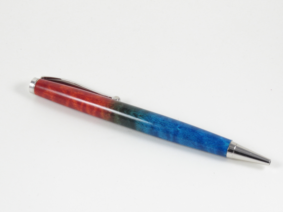

Both pens are wonderful Butch and Cliff. The blanks are awesome and the kit modifications are great. Well done to both.
The IAP Library has a wealth of knowledge, techniques and experience for those looking for hints!
Good work ... both of you !!! . I like the one piece mods for the slimline ... as both of you have just discovered, it is very attractive.
Other kits that lend themselves to a similar approach are the Cigar and the PSI Slimline Pro. You can find examples in various threads over the years and in the Library.
Most any, at least the ones I have tried, two piece twists can be made into a one piece. I have made the following into one piece pens: slimlines, slimline pro click, cigar, perfect fit, jr gent twist, el grande twist. Fun projects.
Nice job on this one.

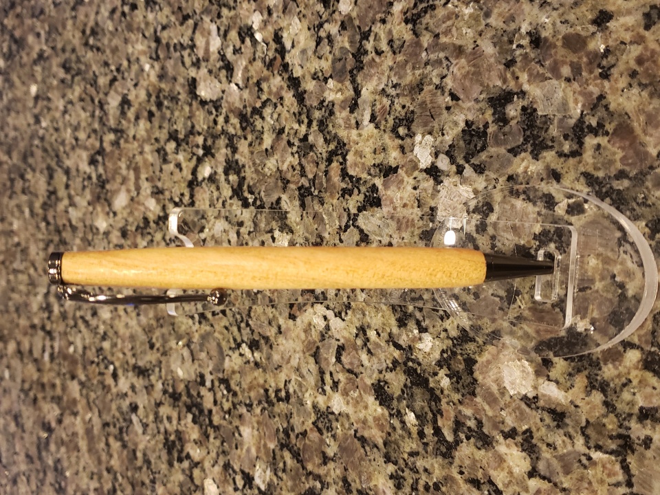

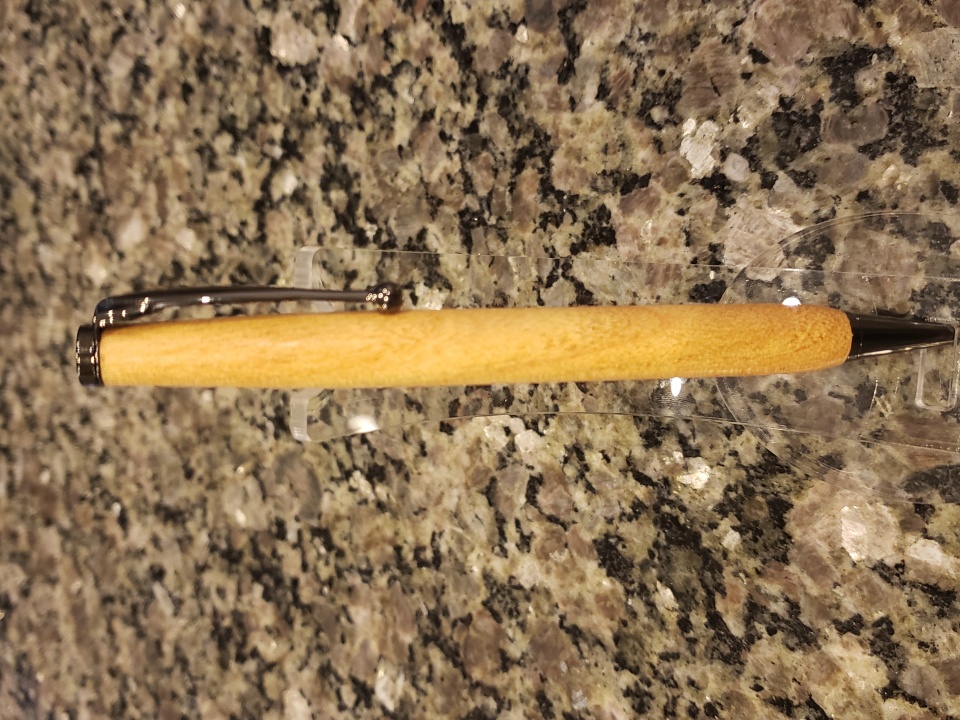

Great pens, inspired me to give it a try. I love the look but I'm having trouble getting it back apart so that's worrisome.
Made with honey locust leftovers from a live edge coffee table.

Same for me getting it apart at first. I was trying to just pull it straight out which wasn't easy. Now I grab the tip and twist while pulling and I can then get it out that way easy.
