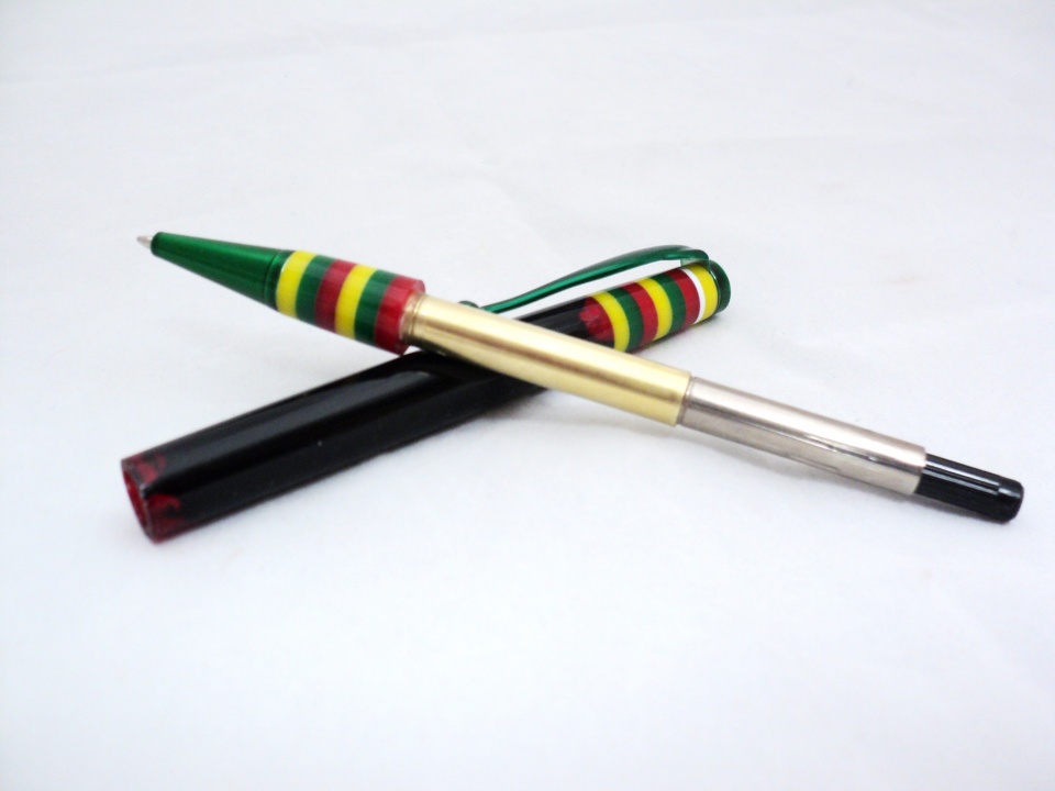

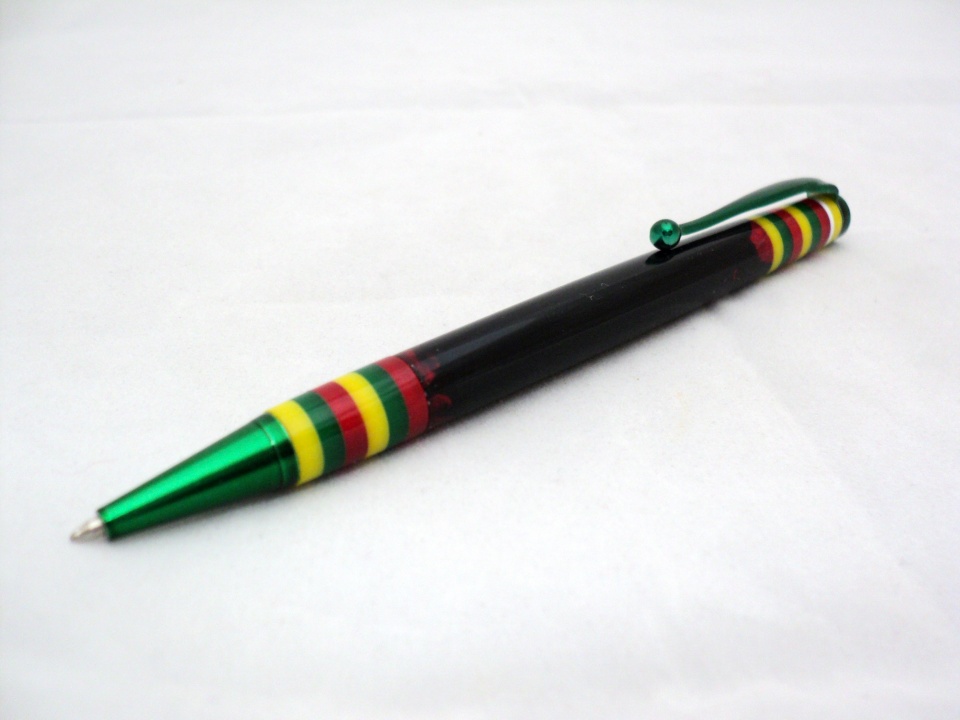

I read one of the tutorials from the library about a one-piece slimline & decided to give it a try. One of ideas mentioned in the notes was that it was difficult to twist just using the nib alone, so...I decided to add a short section near the end that would make it easier to hold on to & twist! 1st problem was that the tool grabbed while I was getting a bit of glue off near the 1st colored section & I almost cut the brass tube into! 2nd problem, for the long tube I decided to use a piece of Alumlite that I had cast (without a pressure pot) & discovered that it was full of pin holes! (should have thrown it in the trash then) I went on & soon the 3rd problem showed up when the clip end blew out. So I glued up another colored "clown" section & got it glued on what was left of my tube. I sanded a little, & applied the CA (3 different times because of unknown problems...maybe it was/is too humid! I kinda like the colored sections, so I may get me a good blank from Central Arkansas group member Slabs/Blanks/Boards & try another one!

I like it! I had the same problem when I experimented with Alumilite RC-3 It's supposed to degas on it's own, because it sets so quickly (2-3 min open time) it's hard to get into a pressure pot. (I'll likely try again, just because I'm like that...) Sometimes I have ADD moments when I need an idea to go quickly.
I think it looks great. I've made a few myself. I like the smaller pen to carry and the one piece design gives you a little more to hang onto when you try to write. Mine were stiff a first and I put a little fishing reel oil on the transmission and just a little residue off an oily paper towel on the bottom of the barrel so the nib would slide easier. It helped greatly.
