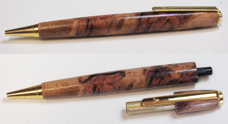

This pen I call the "one piece illusion" pen. It appears to be a one piece slimline. Hence the illusion. The join between the two pen barrels can be moved about on the pen...towards the nib making the cap longer or towards the clip making the barrel longer. There is a limit as to how far it can be moved. All the way to either end and we have the one piece slimline. I'm pretty sure I have placed the article on how I make these in library. If, not, I will send it. Enjoy.

Hey Don,
Have you considered using the grip from the comfort pen and making the "twist point" just above the comfort rubber?
Still gives the one-piece look with no movement of the clip.
The design you are showing looks really good, and you may be able to bend the clip out a little so it does not rub--great use of a slimline!!
