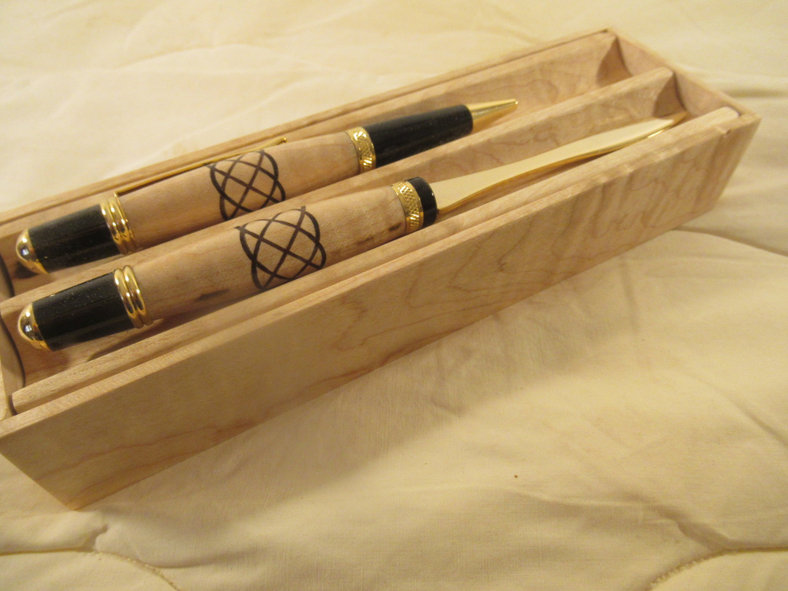

Curly maple with a 6 loop celtic knot
Matching pen and letter opener with curly maple case

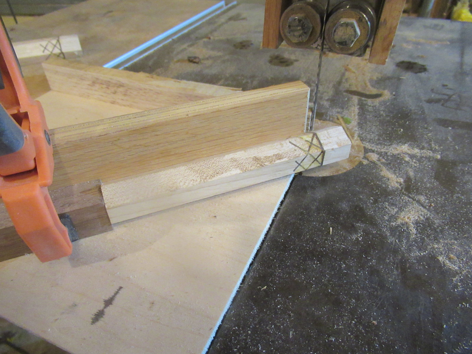

Here is the shop made sled for cutting the saw kerfs on my old bandsaw (1915 Crescent 20)
the kerfs are cut almost all the way through. the sled has a guide bar that fits the track seen on the left of the table

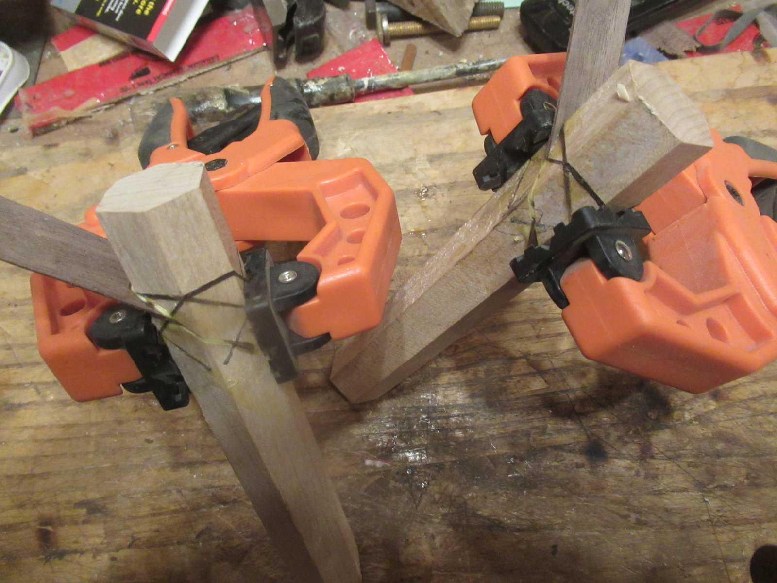

A couple of partially completed blanks clamped up

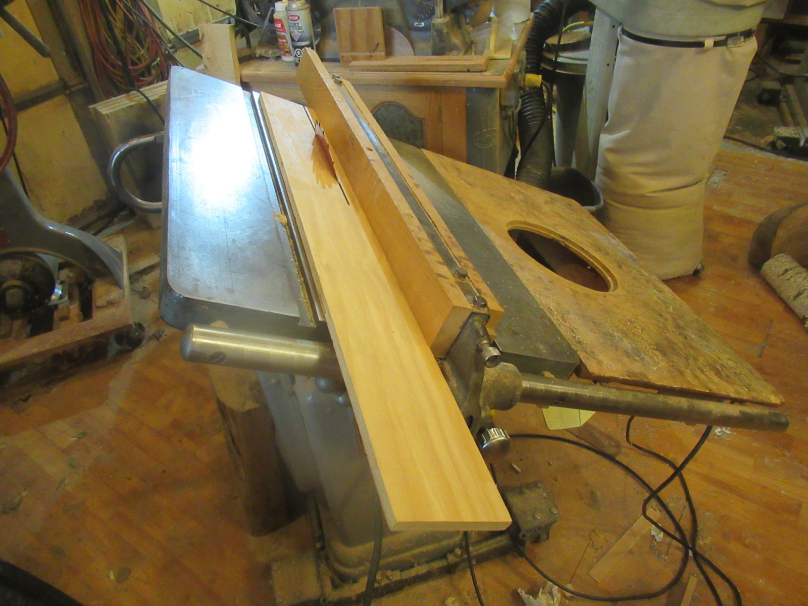

an accurate hexagon is critical, my tilttop tablesaw set at 30 degrees

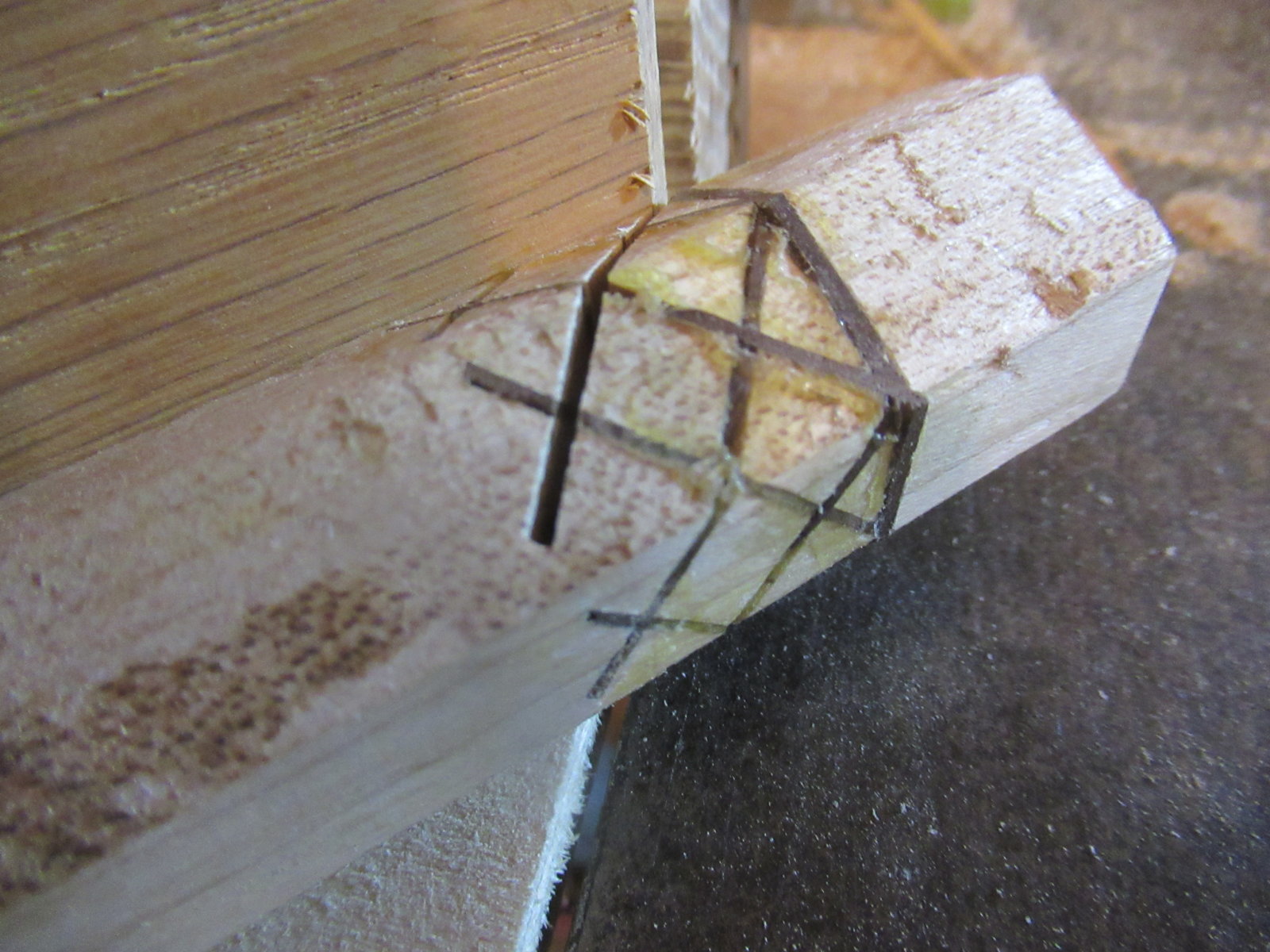

and an almost completed blank ready for its last insert
