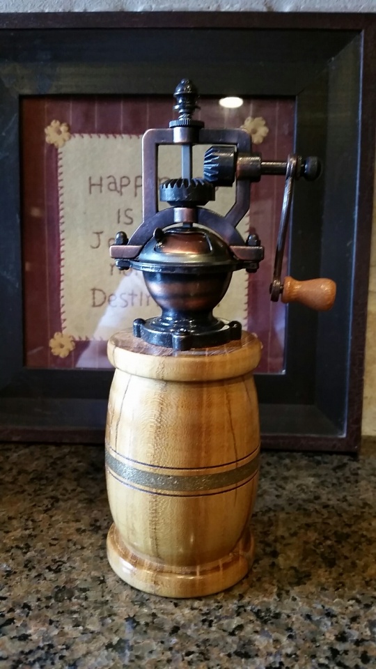

One of my blind turners with his pepper mill

Bill is both blind and a double amputee. He levers himself up out of his power wheelchair onto a high stool to turn at the lathe. He is almost completely blind...can see light and dark. He uses a cane out in front of his wheelchair to navigate around. (He is truly amazing!) This was his second turning project...a peppermill made from mulberry with brass filings inlayed into a center band and some large cracks.
That is fantastic. Being able to put a face to your stories is also inspirational. I can see and I can not do as well. Tell him job well done. Continued success and keep having fun. That is real cool. Thanks for showing.
By mixing the brass filings (or other inlay material) into ten minute epoxy, and putting a nitrile glove on the blind turner, they can press the loaded epoxy into the grooves and cracks themselves. I try to let them do as much alone as they are able. Using an easy tool detailer, they can cut their own v grooves, too. I have to help them some with the fine placement of the tool, but they do most of it themselves. They do most of the shaping with a small spindle gouge and a small roughing gouge. (I turn the blanks round before they start.)

Yes, it is food safe. The only part of it that contacts the pepper in the inside of the 1" hole down the center that the pepper falls through and it is sealed with walnut oil. The wood is mulberry. Frank emailed me and said he is keeping it for you. I'll pick it up tomorrow and PM you for shipping info.
Absolutely beautiful job. I REALLY like the "barrel" look.
