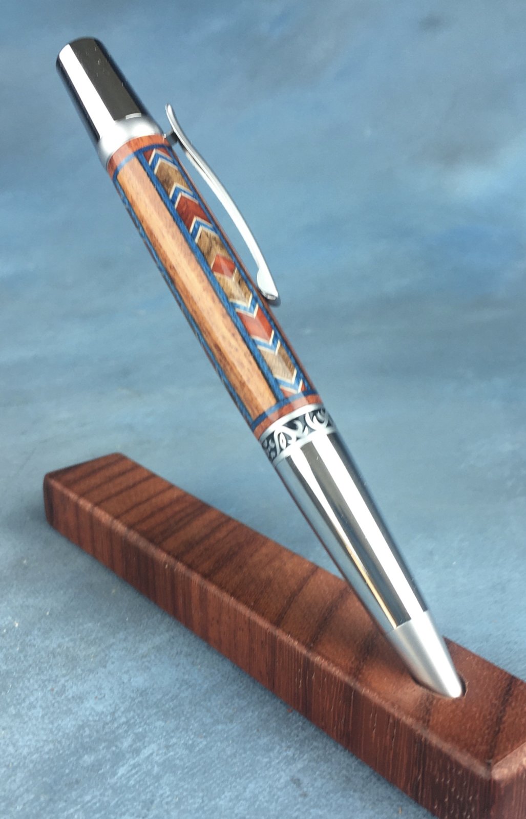

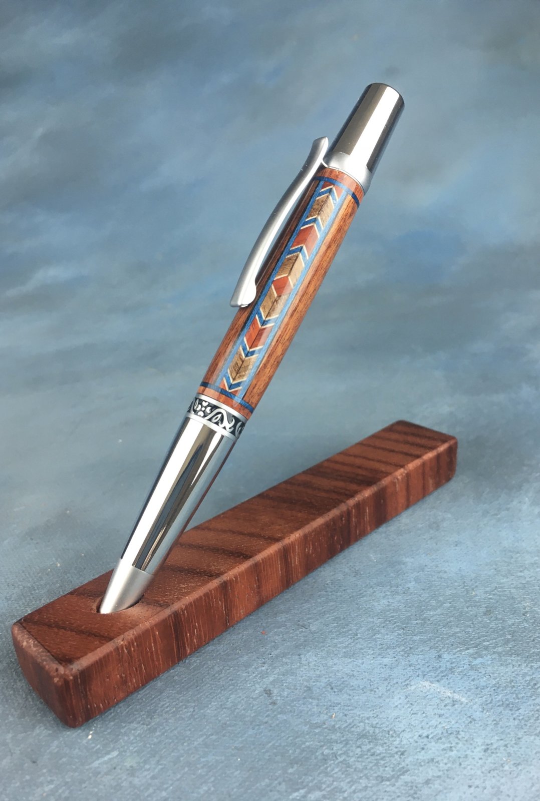

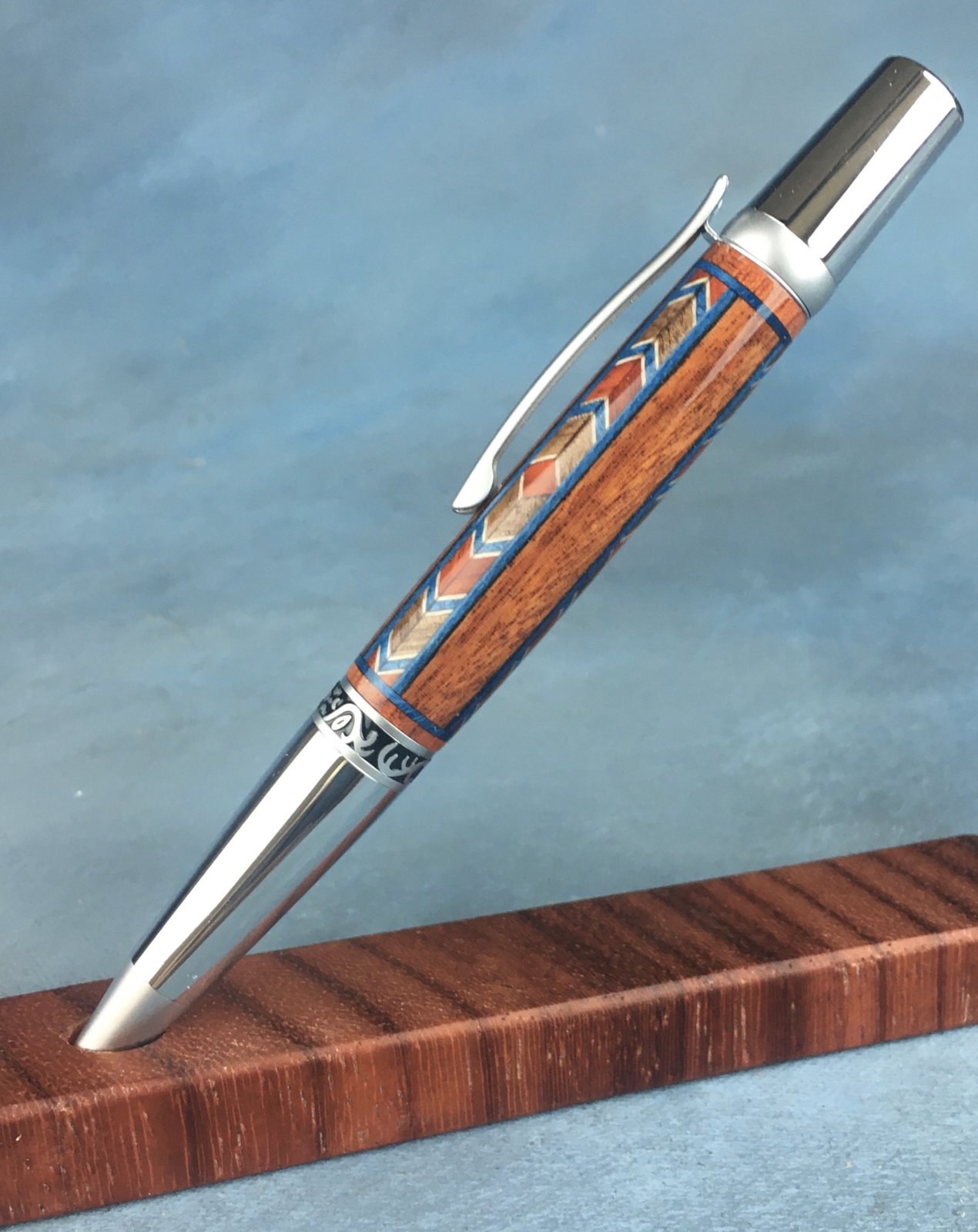

I bought three of these and this one had gaps between the segments. Not a dog or complaint, just a fact. To fill them I used 8 more coats of 40 cps CA. The result was a stuck Delrin finishing bushing that cracked off a chip of finish. After sanding and reapplying CA - here it is. Luckily the gap turned black and only Mark and I know. Now I have the set of three ready for Black Friday at the Bear Valley Holiday Bazaar. I've priced them almost twice my typical Sierra due to the much better and more expensive segmented blanks plus the elegant Sierra kit. We will see...
Mark James - take no offense as none was intended. I felt like a failure to only finish 2 of 3. I love these three segmented pens.

I think it looks great. I'm just quessing were I think the area is you are talking about, you did a great job of filling it in !
Good luck at the Bazaar !!

Nice looking pen! I don't see any issues with it and to the untrained eye, probably no one else will see issues with it either. Good job on both of your work.
