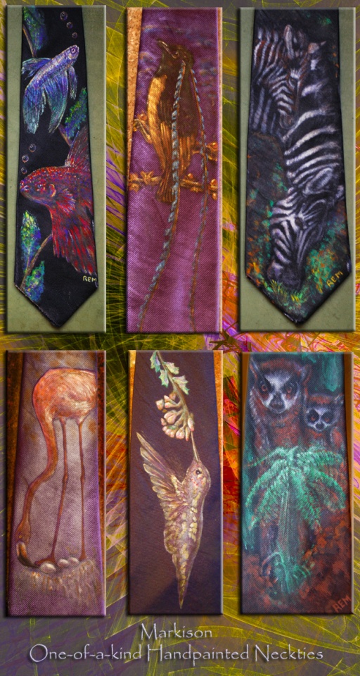

Some friends asked for handpainted wildlife-themed neckties.
Nice chance to work a narrow vertical canvas (like pen design, only different).
I used handmade acrylic paints - raw pigments ground into Golden GAC 900 fabric medium for handbrushing and Golden Airbrush medium (well-filtered after mixing) for airbrushing.
I sewed the ties out of solid colored silk twill (from Britex fabrics in San Francisco), inter-lined with medium/heavy weight necktie interfacing (65/65 wool blend, made in Netherlands, available on Amazon); using my own original cardboard patterns.
The trick is to use very little paint with feather-light brush strokes (barely touching the ridges of the silk twill necktie surface), thereby keeping the surface supple with normal drape.
Air-dried for a week, then gently ironed with a press cloth on silk setting.
They are:
Bettas, Saxony Bird of Paradise, Mother and Daughter Zebras,
Flamingo with Eggs, Hummingbird, and Suspicious Lemurs

Bob, I love reading your posts because I never know what the heck you are coming up with next!
BUT NECKTIES :eek:!
And although I cannot remember the last time I actually wore a necktie, they look awesome.
Wonderful!
Amazing!!!
Thanks for sharing! I too enjoy reading your processes. It is sort of like reading a book or listening to a radio mystery story and having to envision each step of your masterpieces instead of simply watching a video.
Keep them coming!
I like the fish, and the flamingo !!!
But I haven't worn a necktie for many years.
Fabulous work! I was just telling my wife yesterday about how amazing your talents are across many mediums. Now we add another medium to the list. Thanks for sharing.
