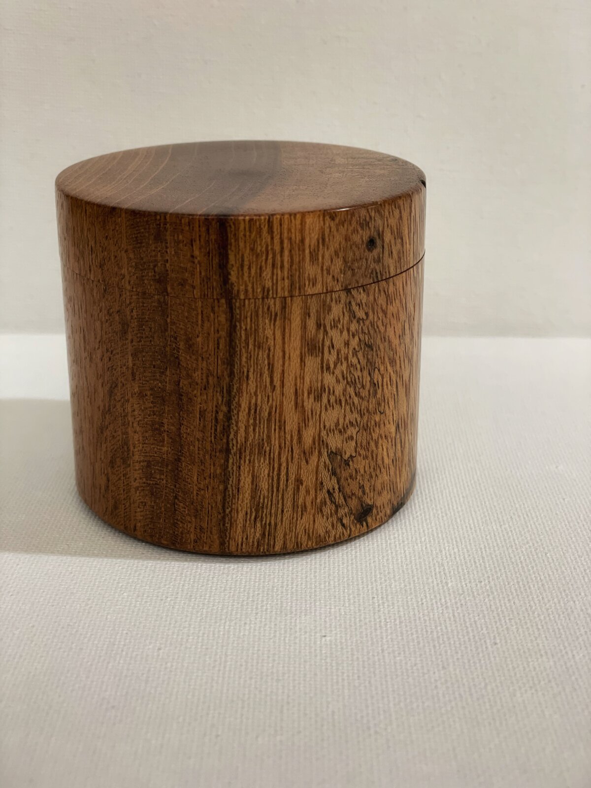

I know, you're all getting tired of these, but I'm not 😂. This one is small only 2.375 x 2.625. Made from spalted jatoba, worm holes filled with coffee grounds and finished with pens plus. I am particularly proud of the grain alignment on this one.

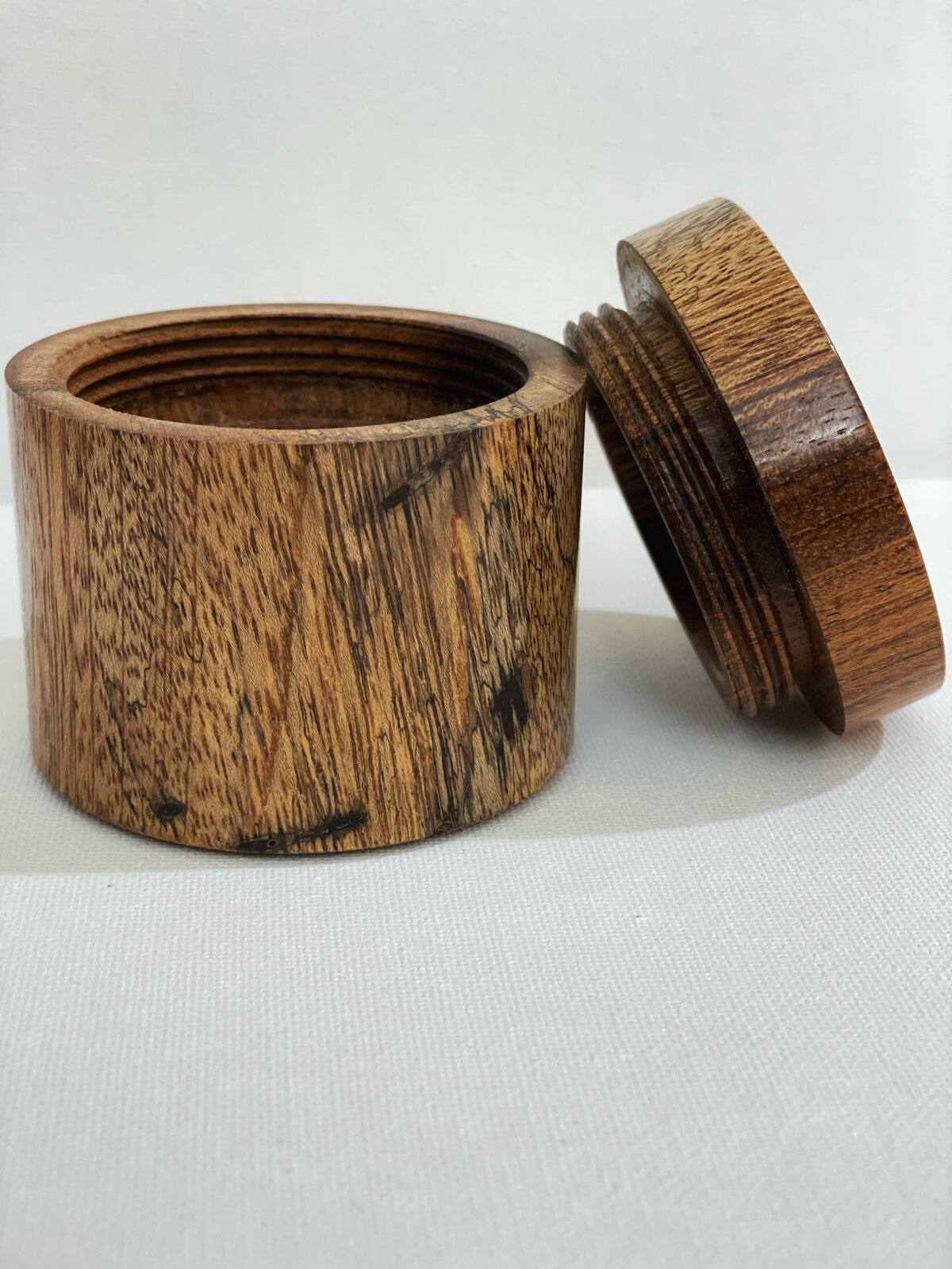

I am particularly intrigued by noting what mods to the threads are required to allow the lid to fit snugly on the box ! ! !
Special thanks for showing the lid OFF the box and leaning against it with threads of both lid and box clearly visible for comparison.
You just make a relief cut behind the threads, you actually make the cut before you cut the threads.
