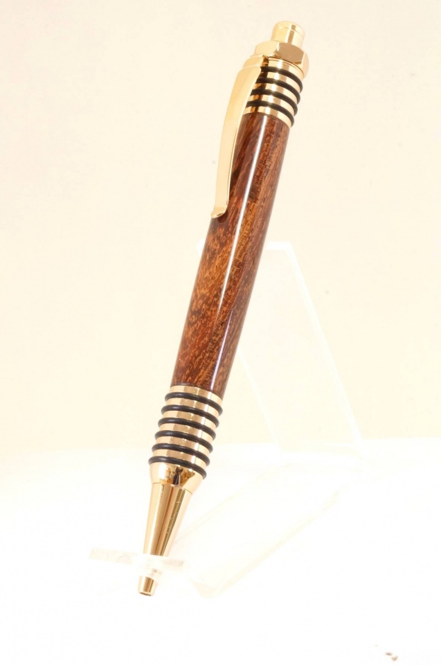

I posted in a recent thread that I had come across a wood that was new to me - Camel thorn. Evidently it's a relative in the Acacia family and native to Africa. Well, I just finished up one of the newer PSI offerings in this wood, the Spartan. CA finish, 10 coats thin, sanded to 2000, then polished with Novus 3 and 2, then the Beall wheels for a final buffing.
After my recent posts re horrible results with CA, I got some fresh CA and am totally blown away by the improvement!
Thanks for looking. Comments welcome

Purty blank to put it lightly..what component set is that?...me likey..:biggrin:..sorry...just re-read the post..Spartan it is..bushigs the same as?? I can see that component set selling...an see a few blanks matching the components well...are the rings removable or repositionable?
i like the camelthorn too. My son told me about it from a bow hunt he was on in Africa - I really like how it turns. IT looks really good with that kit - nice job on the pen!
Ambidextrous - the rings are not removable nor are they repositionable (that I can see). I believe the bushing set is the same as the Majestic Squire.
Dan - the kit is nice. Decent click mechanism. Assembly is as simple as it can get. Some may think it's a bit on the "wide body" size. Maybe just a we bit smaller than the Guardian Jr if you are familiar with that one. Personally I like it.
That looks great!
I bought a pair of the Spartan kits to do my next pens.It looks like it would b a comfy pen to hold,with the o-rings.
Since I'm a mechanic,I like how it looks.
That camelthorn looks really nice!
