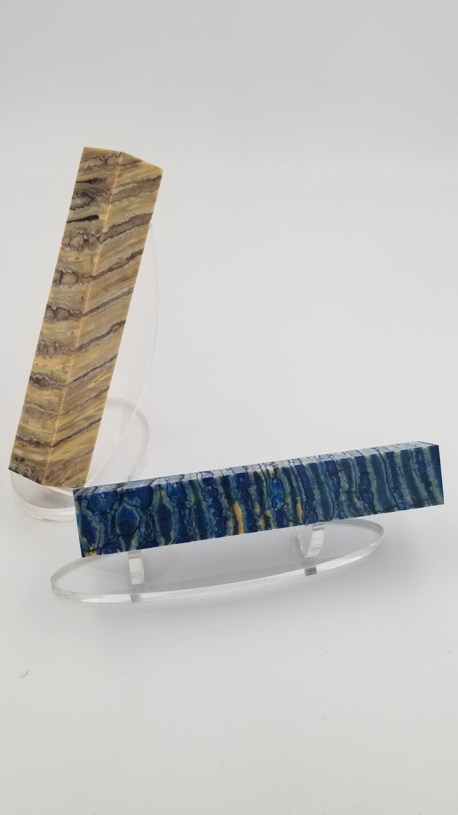

Got these Mammith teeth from House of Mammoth. They'll sit on the shelf for a bit as I research how to turn them but they sure look purdy. 😍

Impressive blanks, they should be even more impressive looking once you get them turned. If you don't mind me asking, what would the price be, on such rare material?

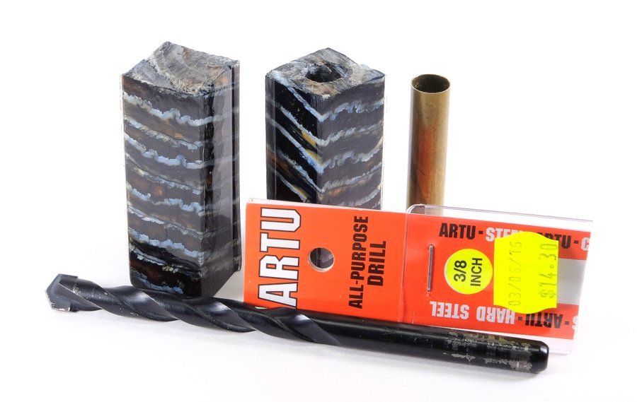

As starters I found drilling using a Tungsten Tip drill nearest to the required size,then a steel drill to the correct sizing. The bands of clear you see in the blank is Silica that slows the drilling each time. I found an old three wheeler bandsaw with a metal cutting blade to cut the blanks to length.
Yes I purchased from the same source,great guy and wonderful service.
Have fun Peter.

thanks for the drilling tip and the warning re silica. I'd never considered using a masonry bit on material like this but actually it's a sound idea. Maybe I would regrind the tip a bit sharper before use or stone it sharper with a diamond file. I assume the steel bit needed a small res hardening session after effectively reaming the hole to size?
Len
Hey Len, I paid $79/blank plus shipping. I thought it a fair price.
