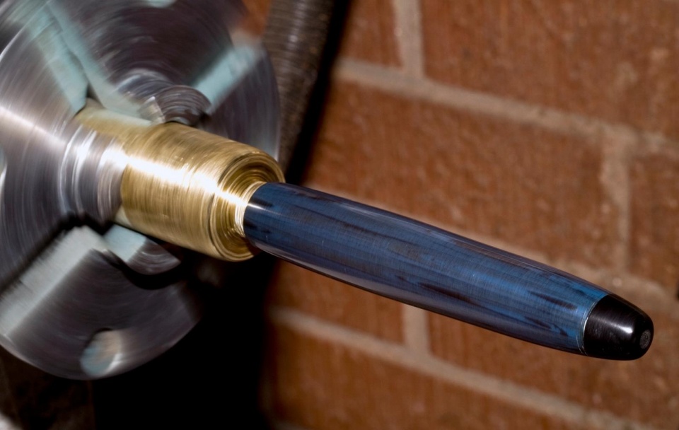

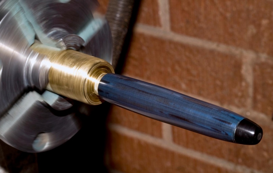

Why use a special chuck when you can do something like this?
attachment.php
I looked at collet chucks but decided against them due to being to limited. Oh the back side of that item in the photo is female threaded. I also made a nut/bolt that I often use as well. These are 12mm x .8 triple threads.

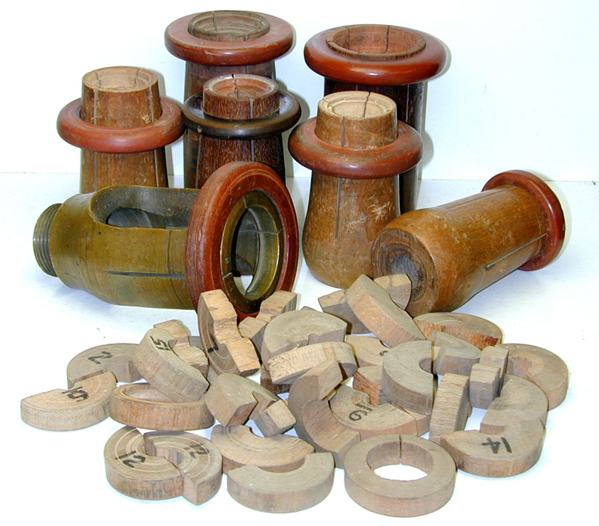

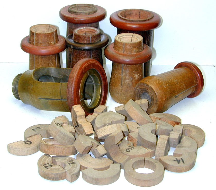

That's the same chuck I use on all the pen blanks to square the ends, drill and on bowls. On this chuck, Nova G3, is the 1" jaws.
I have watched every japanese master pen maker video that I could find and studied how they did things. One of the first things I learned was, they use wooden chucks.
attachment.php
Absent that you also have to deal with the material being marred up via jaws, clamping actions and the like. It only made logical practical sense to go with a screw thread insert holder.
