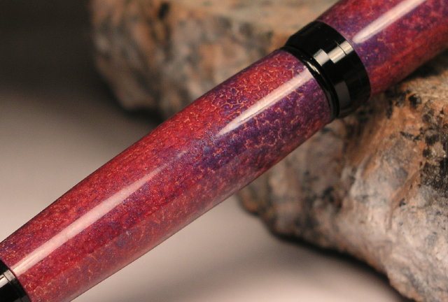

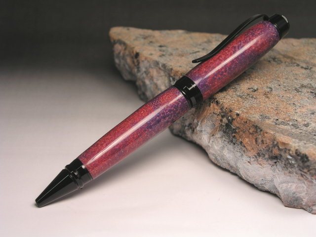

I made a whole pen with the embossing powders, and then torched it. Covered it with CA:
I would imagine it would work the same if CA'd in place. It is fairly fine and should work. Things like glitter can work too if you get the extra super fine stuff. Usually around the opening should not be an issue as you put the material in the hole and then turn it back off with a scraper. That should clean up the area around the voids.
Cheers,
Fangar
