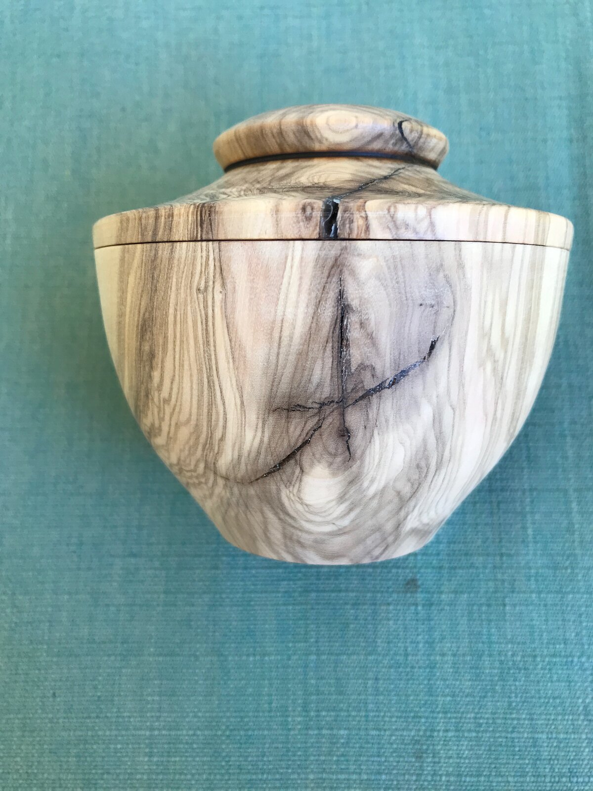

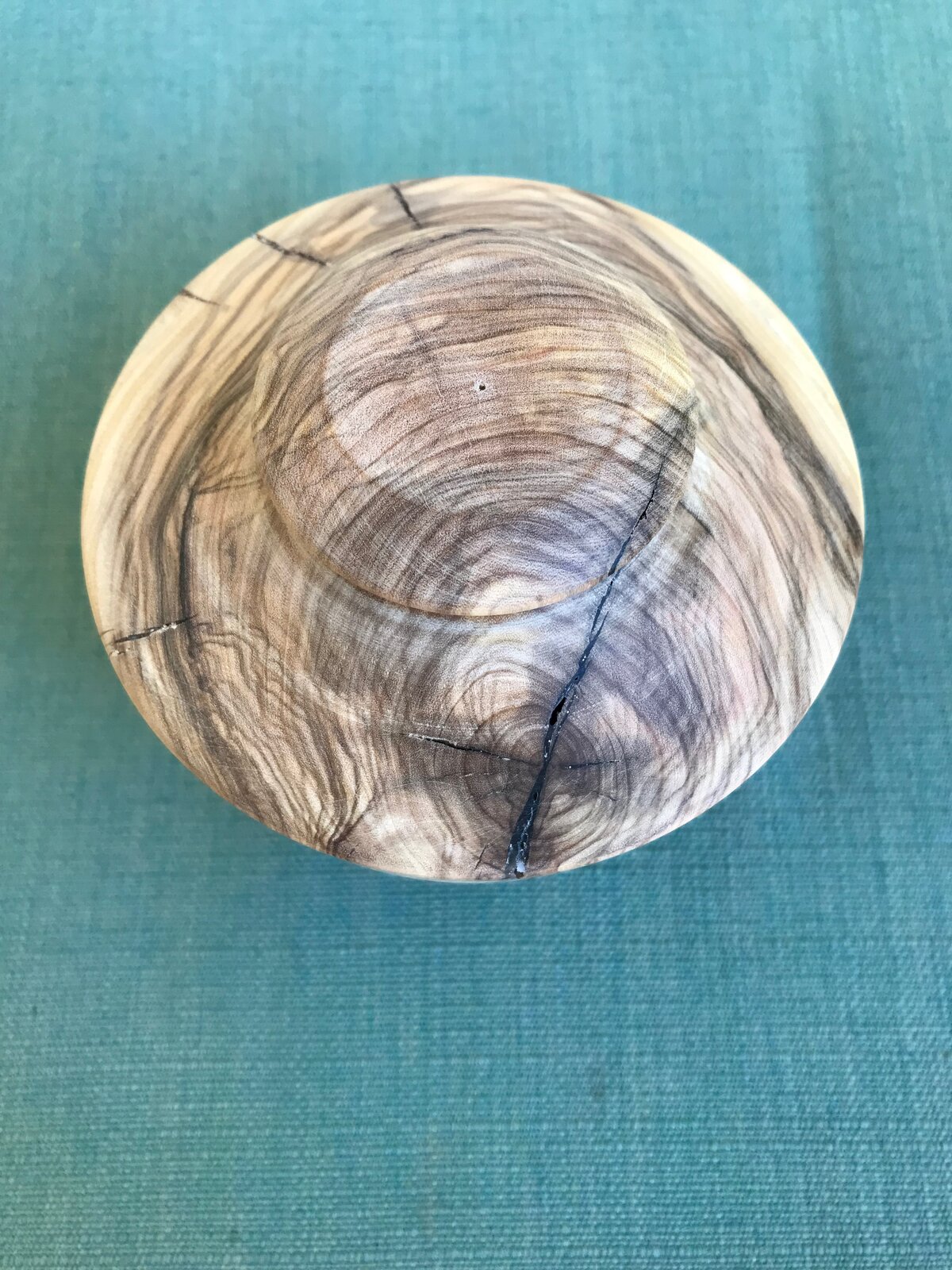

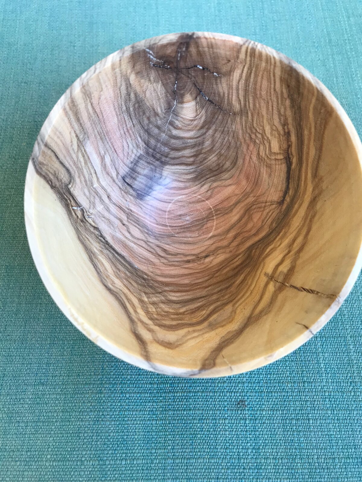

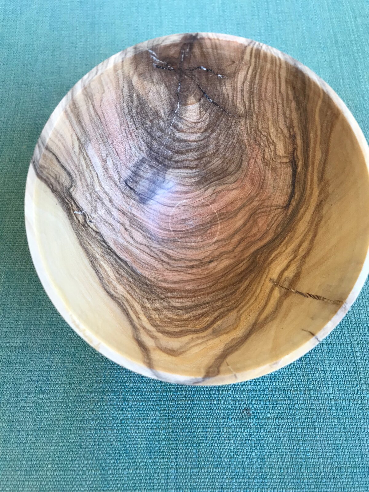

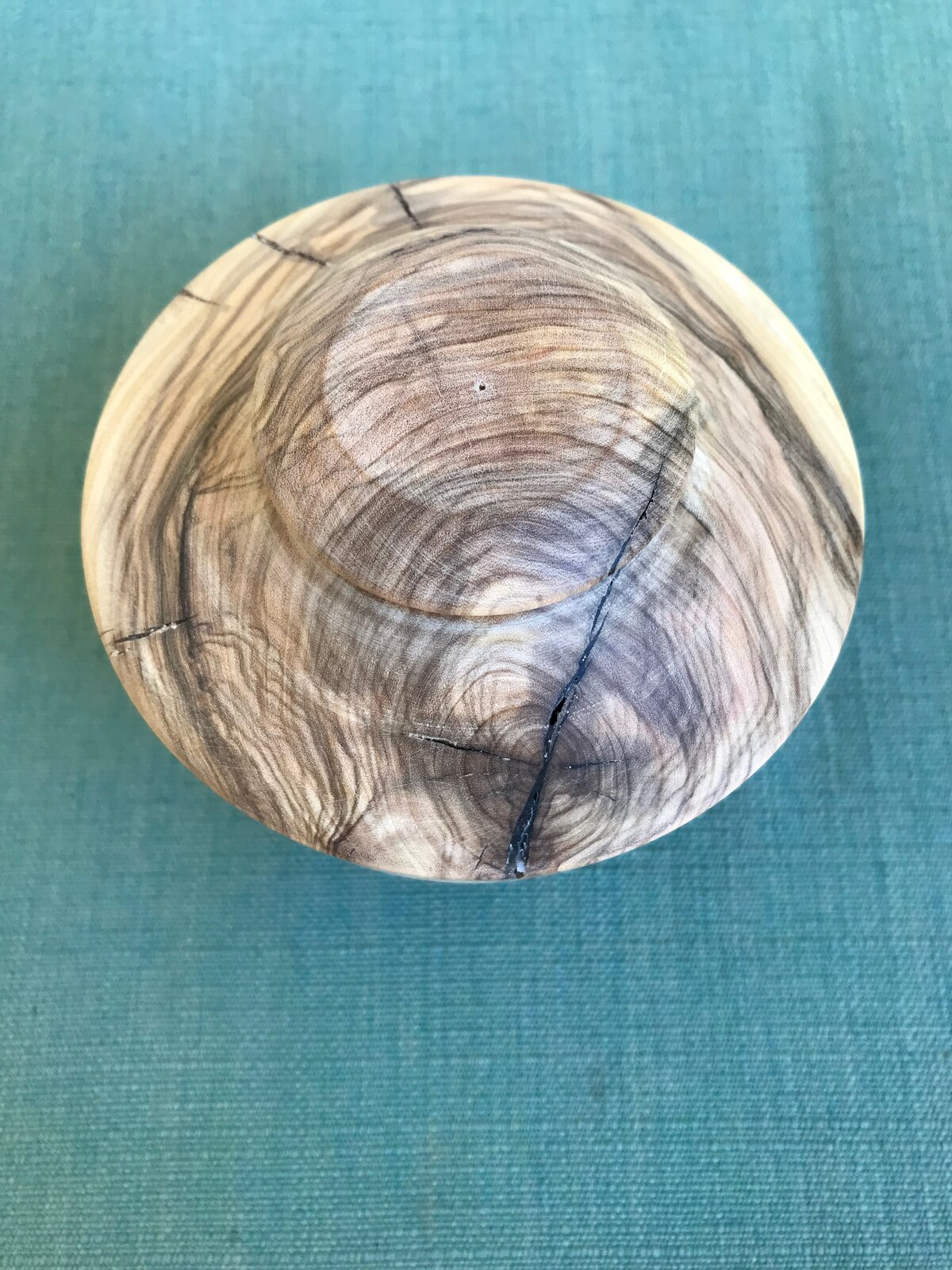

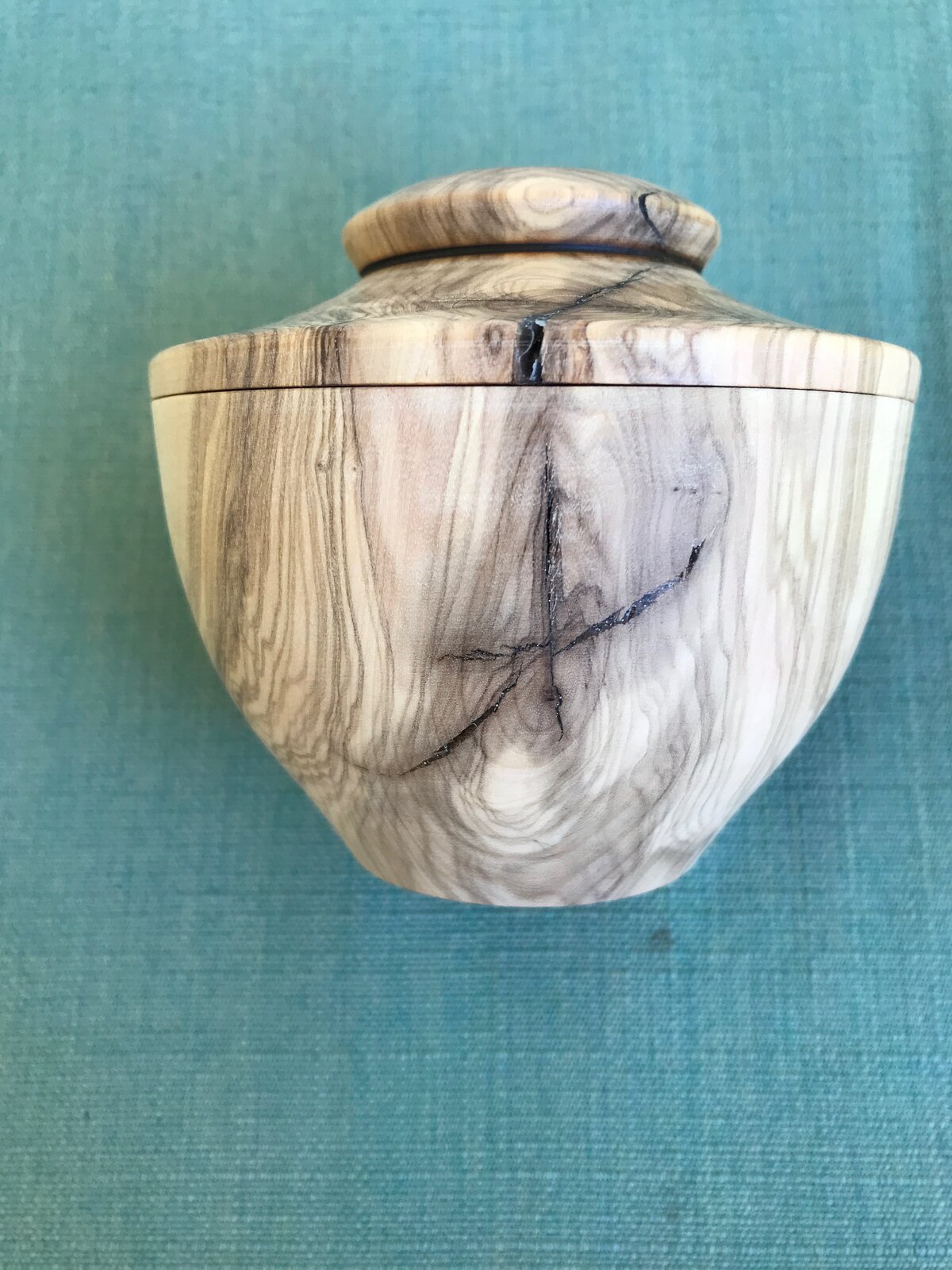

Took time off and busted out this little 4 x 3 Olive wood vessel. doesn't have any finish vet, going to finish in Pure Tung Oil.
This is local California Olive from my friends ranch in Esclon, California , was cut two years ago and ready now for tuning.

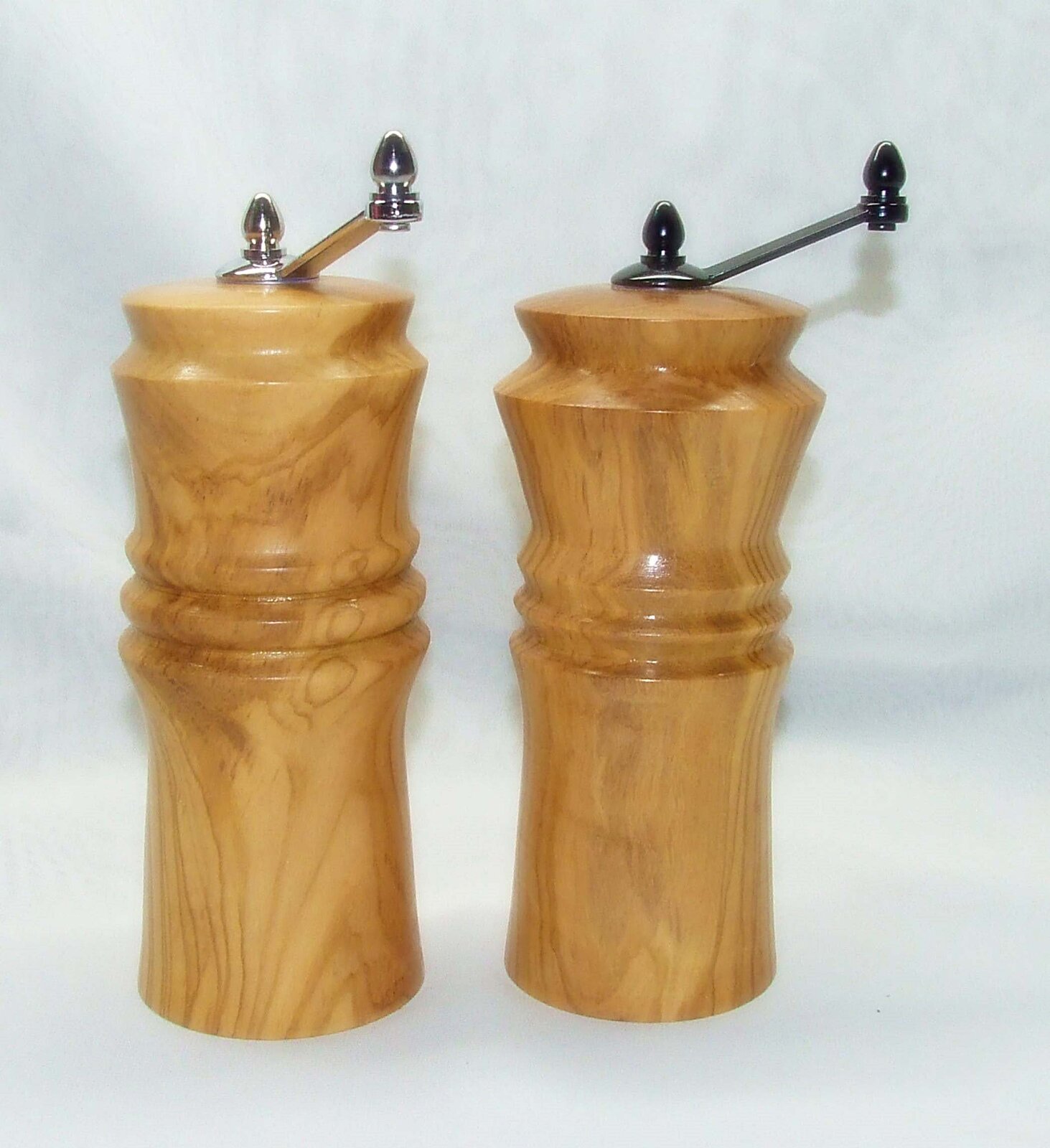

Recently bought a chunk from my local wood supplier and made up two crank operated pepper mills....6" midi style.

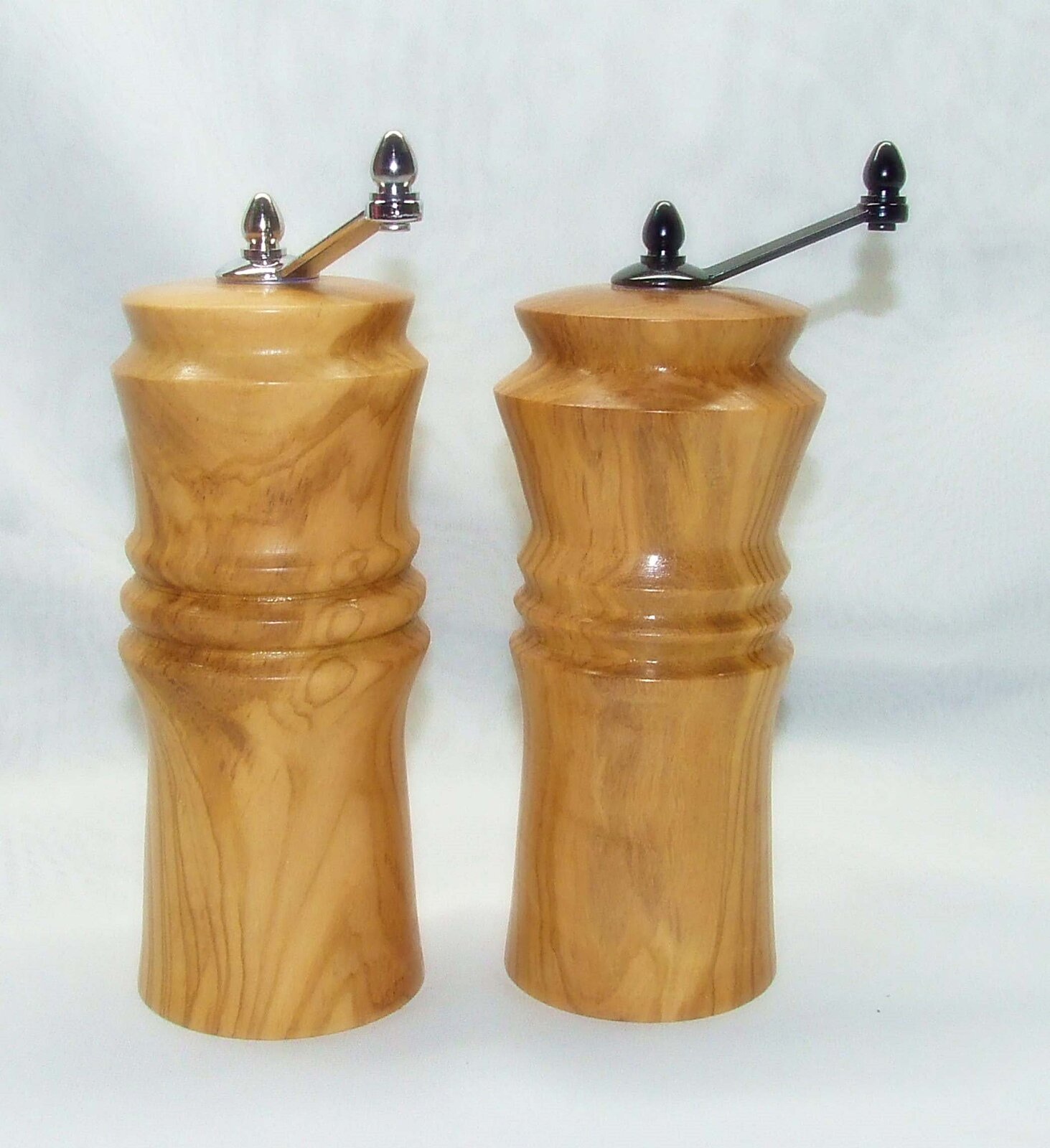

Did you stabilize that crack before turning? I would have been terrified that that would catch/blow out. Beautiful product!
Just used a little epoxy as I was starting to form the vessel. Then near finish size re epoxy the cracks. didn't stabilize. used a Pure Tung oil finish, ten coats and then buffed out. Photo's attached are before Tung Oil finish.
