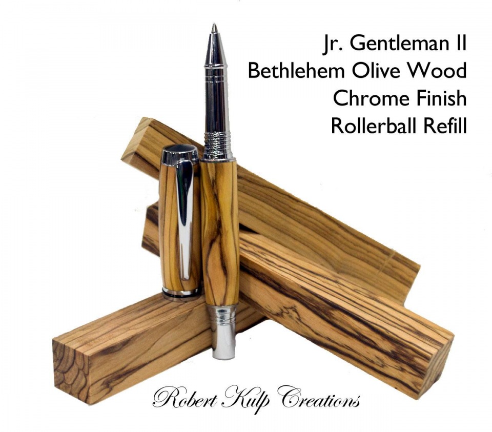

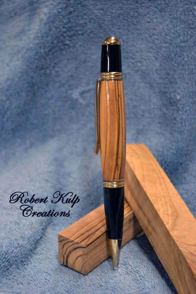

It's probably out of the price range, but you might could get donations to help offset the costs - The Jr. Gent II in Chrome looks great wrapped in Olive Wood. It's beefy enough to really show off the figured wood and turns really easily and quickly. As an alternative, a Gatsby or one of those styles also works really well with Olive Wood.
Personally, I think that gold clashes a little too much with the Olive Wood's color, but chrome, gunmetal, or black titanium contrasts very nicely. Smitty's six-pack special would be great for this project - great kit at a great price.
