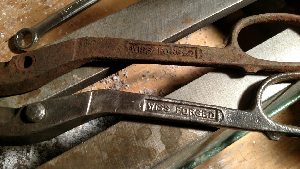

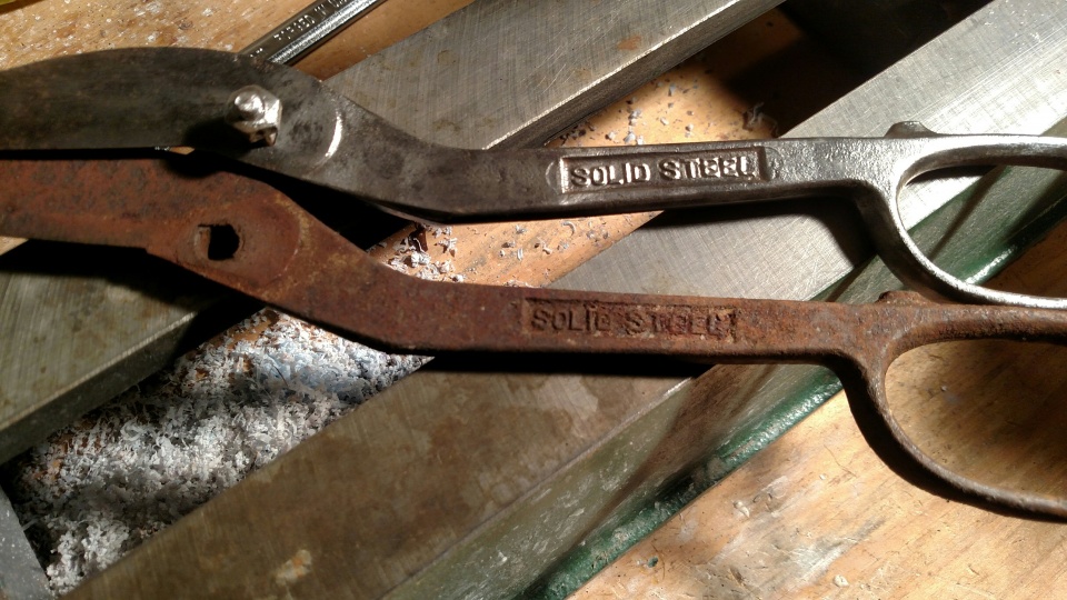

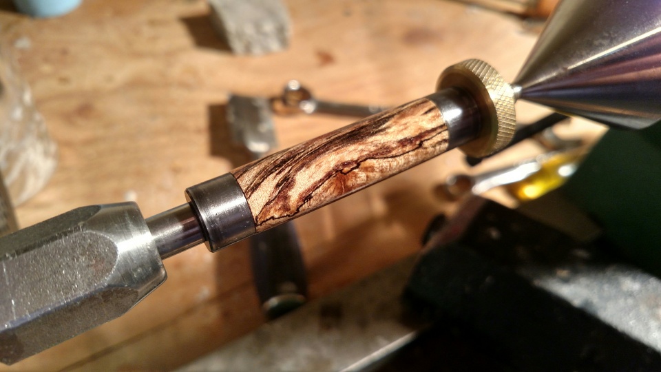

I'm waiting on some pen blanks to dry in glue up so I'm messing with the shears. I chucked up a brass wheel and got to cleaning rust.
I've got a few #5 baileys that I'm tinkering with and an old, old, ooolllld Ohio Tools Company Jointer plane in various stages of repair.
But for now, here is a pic of the Wiss shears in repair.

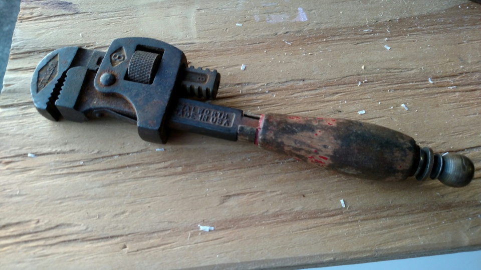

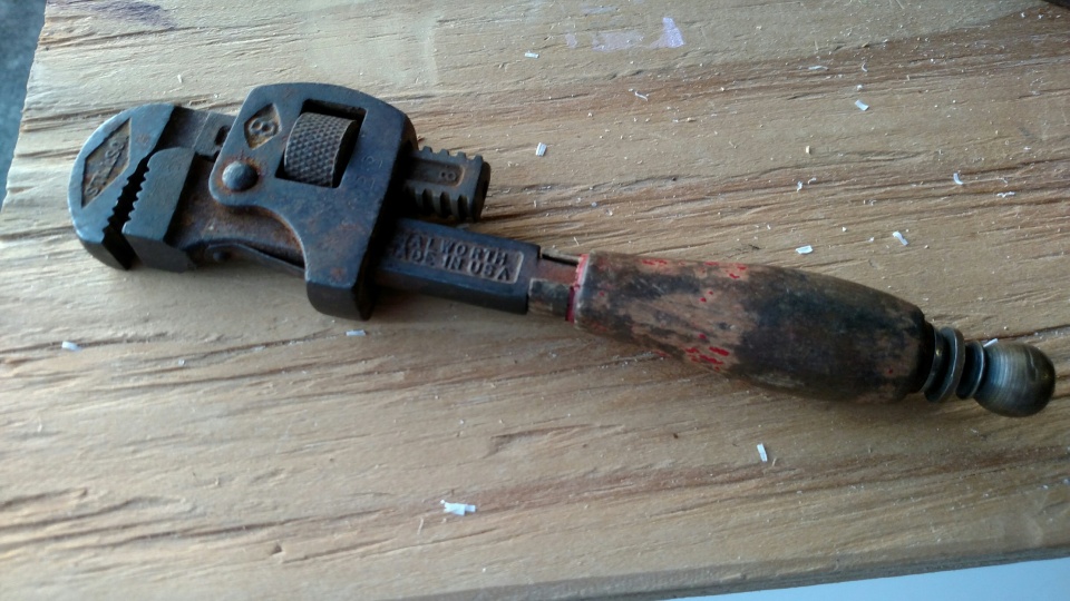

I stopped into a pawn shop today looking for a bench grinder and found this old wrench for a $1. I also grabbed a large blade flat head screwdriver and some guitar picks for a grand total of $4. Don't mind if I do.
Next, I stopped over at ACE for a brass compression coupler to use as a new ferrule.
I now need to decide what to use as a new handle. It's a toss up between walnut, sapele or heart pine.

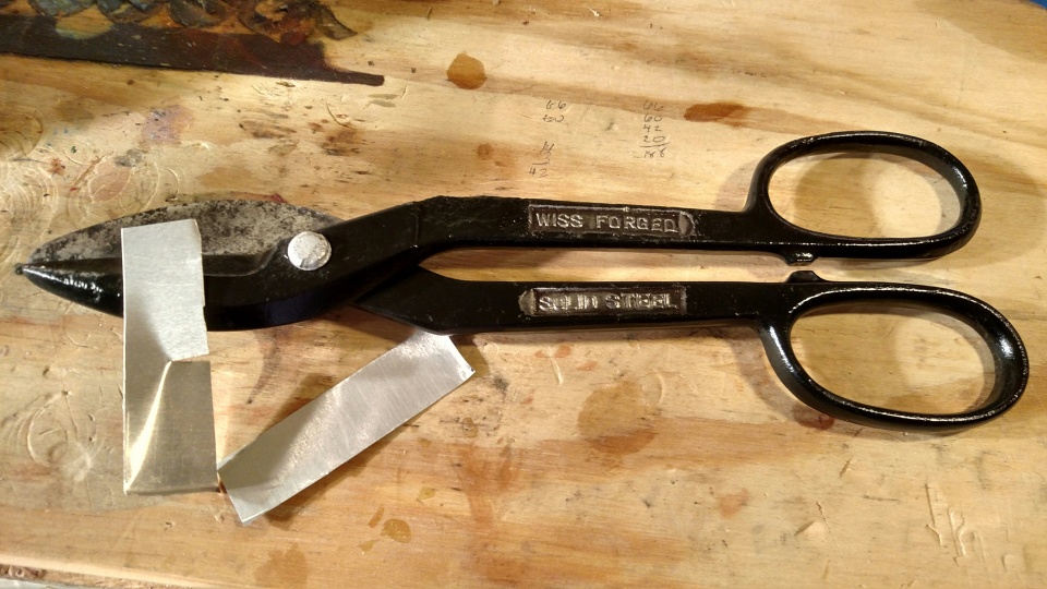

The snips are back in user condition and cut well. Some day I will revisit the cutting face, whatever that is called. It's fairly pitted but is now coated with paste wax to help stave off any further rust. I left the name imprint bare metal and applied a coat of clear.

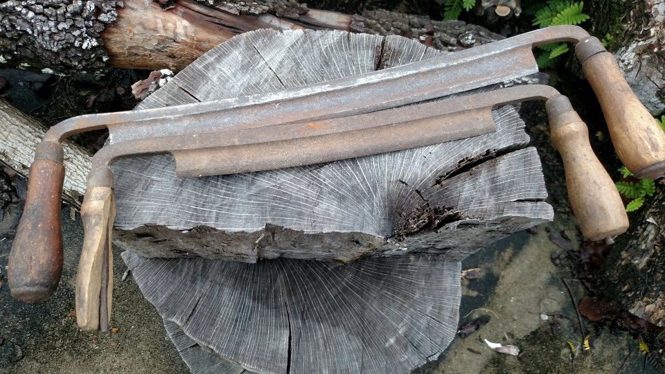

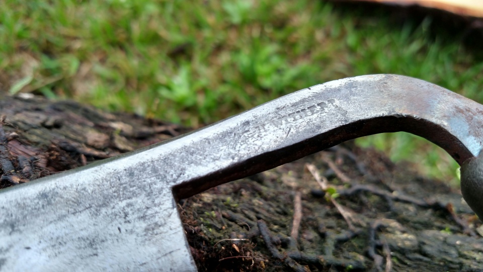

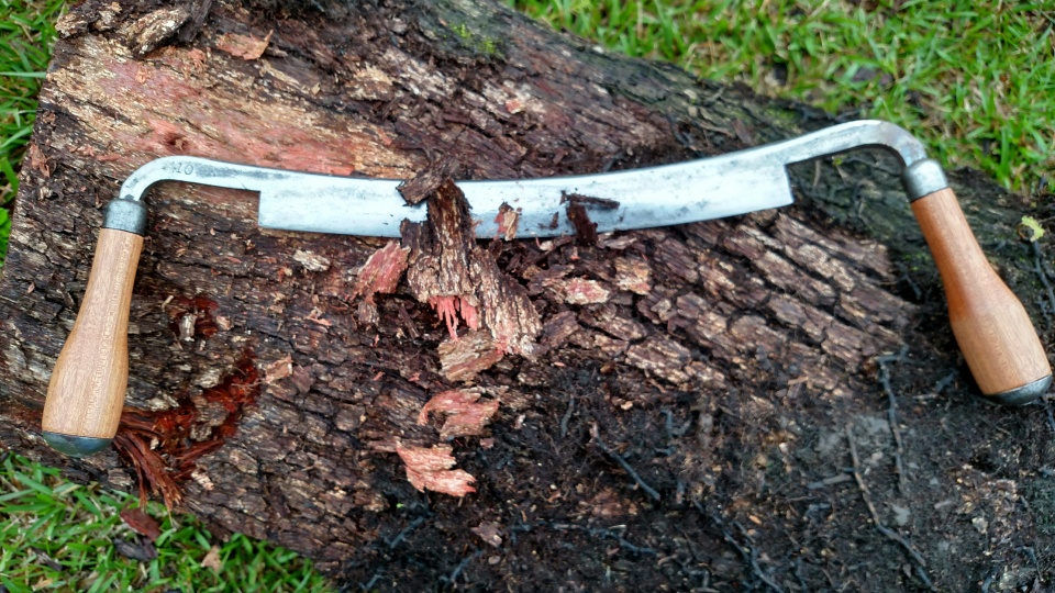

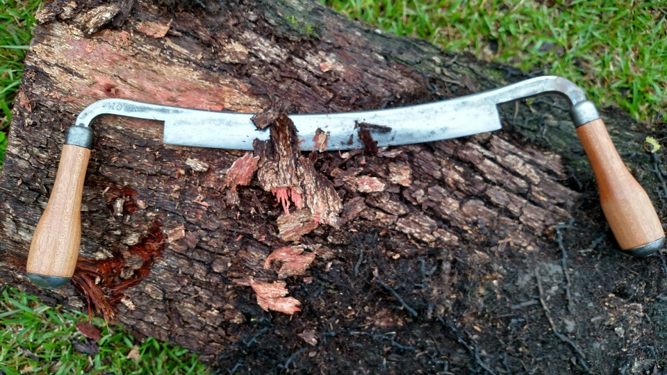

I haven't been able to work on much restoration lately but I will claim victory on one 10", Withers draw knife. I found this one for about $12, maybe? Of course it was rusted, a tang was bent and one of the handles was partially missing while the other was there but broken.
I cleaned up all the rust, filed down some abuse spots here and there, straightened out the bent tang and turned two new handles from some scrap sapele. The handles were epoxied back in place and the end of the tang that comes through the butt plate/ end cap piece was peened back over to hold it all in.
The finish on the sapele is light coat of thin CA followed by Johnson's paste wax.
I've got a two other drawknives to restore this month as well as several #5 Bailey planes as well as a destroyed #6 and a very good #7 I've had for about 2 years that doesn't get used.
