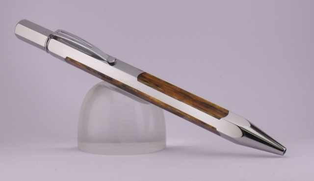

This was a bit of a saga and I had to change the design half way through. The inlays were supposed to be 'inside' the flats of the hex, but I was fractional off centre and it looked poor. So I just extended them to overlap the sides of the hex stainless steel. Two long inlays and a short one for the side with the clip.
The material is Antique Gold acrylic, twist finial, Parker style refill and donor clip.
I'm pretty pleased with the end result. Hope you like it too!!!. :wink:
Any questions, comments or critiques welcome:biggrin:

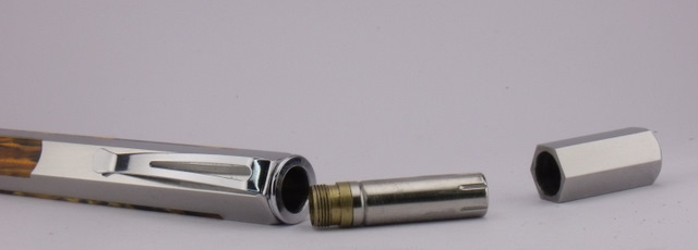

Here's a few pics of how it was made, if you want to see them. The last pic shows the back of the pen, behind the clip side.:wink:

Ah.. now things make a little more sense! I was picturing you filing down a bolt
from round to square and wondering if your forearms looked like Popeye's.
Or at least you would have invented an electric file.. :tongue:
Did you need to make some custom parts to hold the hex shape?
This is a good looking piece.. and it's nice to see some of what goes on
behind the finished product

WOW
that is really, really nice
at first look I thought the inlay was wood then I read your post.
Great work it's nice to have a mill. I have a mini metal lathe 7x12 I just love it.
Good job

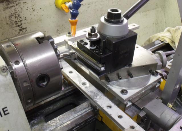

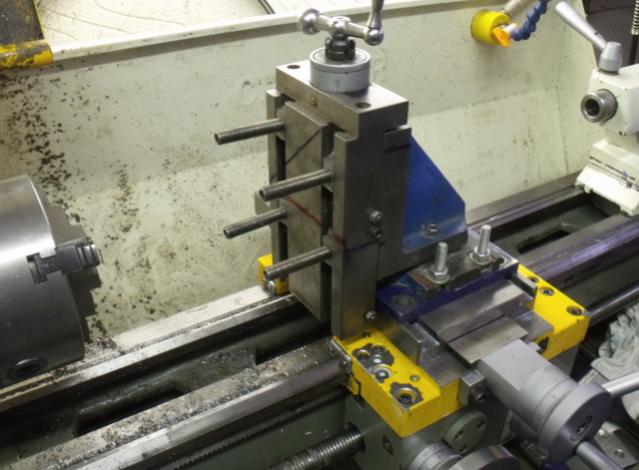

Funny you should mention that Charlie. As you can see, I used the QCTP that I got from you and I learned something new about my lathe.
I checked that the bottom of the tool holder was perfectly parralel to the carriage and it is.....BUT while I was doing the set up, I discovered that the cross slide actually travelled downwards when it was advanced forward. It was only a gnats hair out, so I simply skimmed the bottom of the holder with a bigger end mill ( which I also got from you!! :biggrin: )
Clamping it the holder wasn't difficult, even on edge. I placed it in the holder and temporarily clamped it to the back surface of the holder ( to keep it straight. Then clamped it down with the grub screws. A bit of brass protects the top corner of the hex from the screws.
Glenn, the inlays were pretty straight forward. I used a drum sander to round the ends over till each ends was a good fit. The inlays are fractionally longer than the cutout in the steel. I placed one end of the inlay in one end of the cutout and slightly bent the inlay so I could get the other end in. This left a slight bow in the middle. I then just clamped it up and warmed it with a heat gun and allowed to cool before glueing them in.:wink:

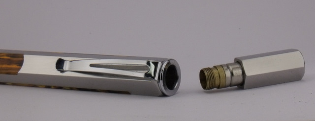

Question: what type mechanism are you using and is it possible to see the workings??? If you had a problem with the transmission is it possible to replace it with your design or will it have to be drilled out??? Thanks for sharing.

..........Question: what type mechanism are you using and is it possible to see the workings??? If you had a problem with the transmission is it possible to replace it with your design or will it have to be drilled out??? ......
Just a stock twist mech, similar to the one in an Elegant Beauty type kit.
Easily removed. LOL, I really did once made a complete pen but it couldn't be opened to get a refill inside!!!:redface::biggrin:
The hex comes in lengths of around 300mm. 'Milling' and point and drilling done on the lathe. I don't have a milling machine but sure would love one.:biggrin:
Skip, thanks. A picture is worth a 1000 words. That explains it.

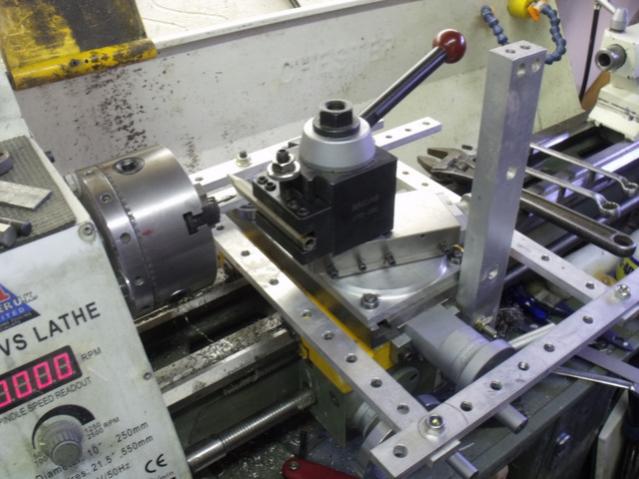

Do you mean one of those milling heads that bolt to the back of the lathe bed?? If so, I don't see the point really as I rarely need to mill anything longer than 200mm and I can get that with my cross slide and the tool in the headstock. I do have a vertical slide which is great and also other goodies like a rotary table with index plates.
Proper dedicated milling machines aren't much more expensive than the bolt on type and not as limiting. Also, the carriage on a lathe is designed for 'downward' pressure into the bed but vertical milling on a lathe can try and lift the bed. I'll just keep saving my pennies till I can afford a better one. Setting up is another story, believe it or not, it took me much much longer to prep the lathe to do this milling than the job itself. All the framework around the carriage is just to make dead stops for each end of the cuts.:wink:

Skip, Nice thinking a very nice looking pen! I was wondering what is the purpose of the Aluminum frame around the top of the saddle, and cross slide? is this for support for the cross slide? or to hold a video camera?

LOL, it's been a while since I had that kind of reaction from a lady:tongue:
Hiya Ken,
looks more complex than it is. All it did was to provide a dead stop for both ends of the cuts. This way I didn't have to keep count of the dial indicators. The four horizontal frame sections are secured to the back of the carriage and travel with it, the thick vertical piece was the stop. I could have chopped it up to make it look neater, but I use it for other stuff too.
