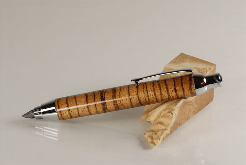

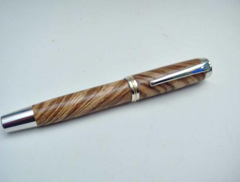

Pap, The zebrawood gets a little scary cutting it cross grain, but if you take it real easy especially near the ends while your turning it looks great, Bias cut is a little easier to turn with out the ends chipping off, Most of the Bloodwood I've gotten doesn't have a lot of grain to it I suppose there might be some difference cross the grain just not sure.

Pap, zebrawood looks really nice crosscut. You need to take more care while turning it, but it is worth the effort.

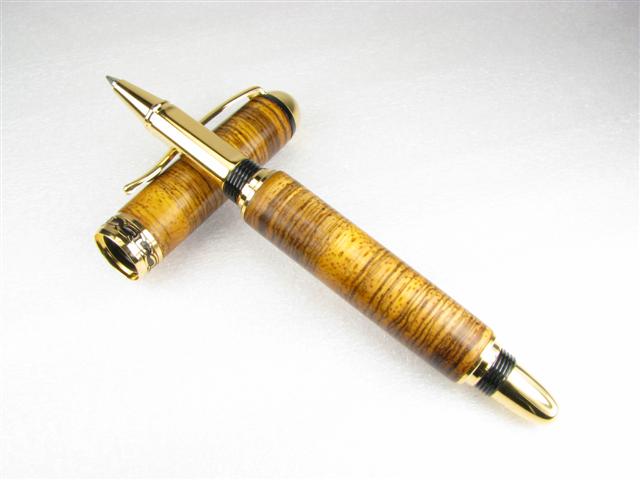

Hi papNal; In no way am I attempting to outdo Keith with this picture post. I just want to give you another idea when you X-cut the Zebrawood.
After I finished turning, I used a yellow aniline dye to bring out the contrast between the dark and light grains of the Zebrawood. A little sanding after the dyeing brings out the chatoyance in the wood.
Mack, that's a great idea to use the dye to increase the contrast.
The cross cut zebrawood does have some amazing chatoyance, doesn't it?

It's not too bad cutting the zebrawood as a crosscut. But when you go to turn it be REALLY careful. Crosscut blanks can chunk out on you in a heartbeat if you get too aggressive. Just take them a little slower and make sure your tools are sharp.
