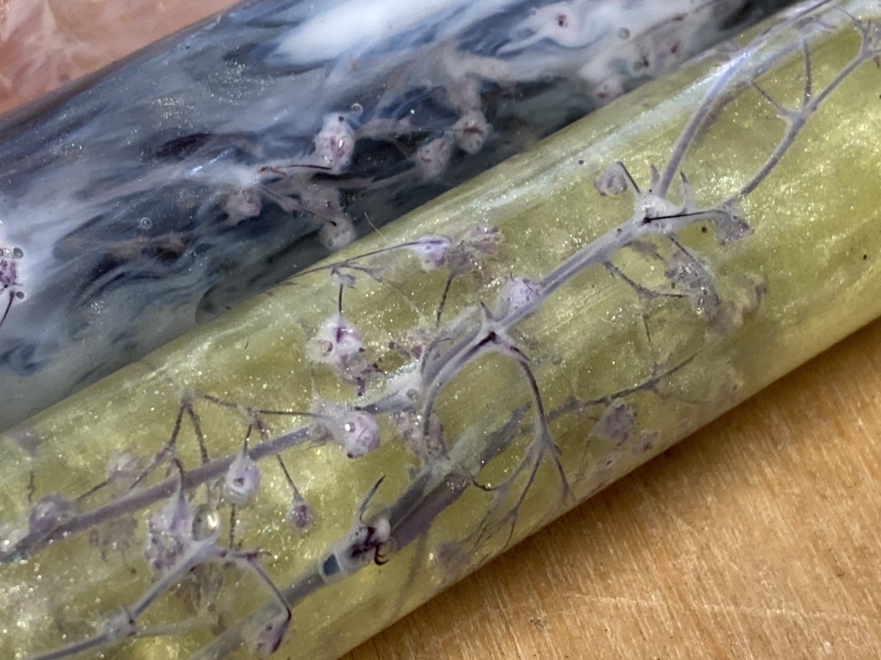

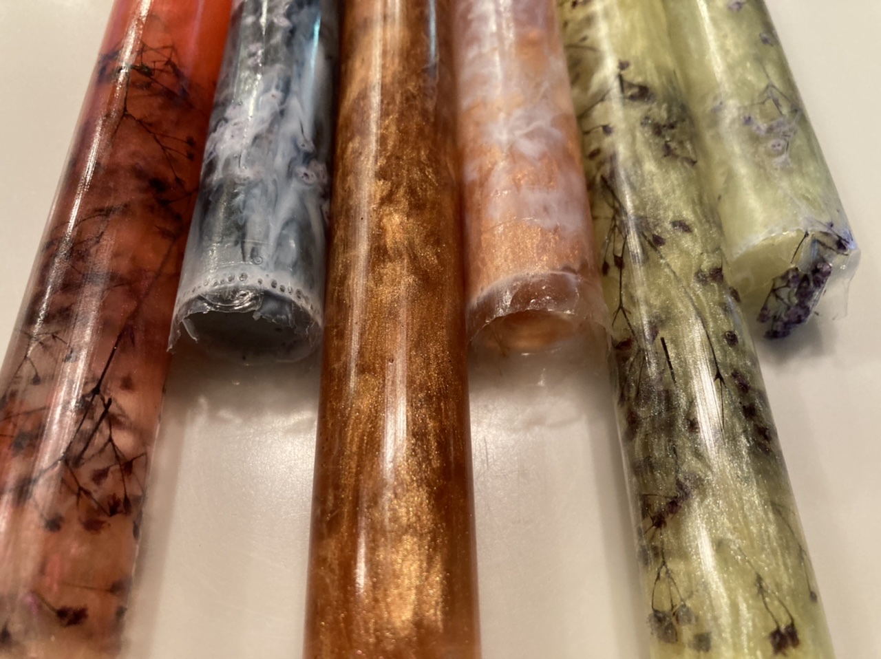

I'm not sure what's going on, but my alumilite clear casts are all turning out white and gassy. This is dried baby's breath dyed purple. The front added yellow mica powder. The rear added battleship gray. The tubes were held at 45 psi for 24 hrs.
The front I'd say looks white because of bubbles at the flowers. But the back one is streaked with white.
I'm wondering if the alumilite has gone bad. I'm at the end of the bottles. I have new ones on deck. Change my recipe? Or just pitch the old and business as usual?

Polyurethane, Alumilite Clear, doesn't like moisture. It also has to be mixed thoroughly and by weight. If your heavy on the B side it will turn milky white. Also if your mixing small batches or not scraping the bottom and side any resin not mixed properly will streak white. As far as old resin some of the manufacturers say 1 month or a few months. I've use resin just over a year old with no problems. I warm the b side before mixing to help with bubbles and mixing. Good Luck.
Moisture causes foaming. Maybe your embedded stuff was not dry.
As Kenny mentioned, incorrect ratio or incomplete mixing will cause totally white or white streaks.

As the B side ages it`s viscosity increases , to the point where crystals form within it . Using it at that stage at equal parts by weight can give whiteness , even when the encased material is totally dry . Being cheap , I experimented and found that increasing the B side weight by 1 % reduced the problem . I made a number of castings at +3 % B , and some up to + 7 % B as my resin stock continued to age , all totally clear . I`m sure there may have been some degradation of other properties of the resin , but none that was as degrading as the whiteness .
All of that said , moisture is the most usual cause . The whiteness in the yellow one appears to be centered at the points where the plant branches . These would likely be the highest moisture areas , but are also areas where the plants chemistry may be slightly different . The gray one is more typical of what I see with aged B side resin .
As stated, that looks like moisture. Not much, but it doesn't take much. I have used Alumilite clear and clear slow old enough it has begun to crystallize. We simply warm mine up. Not had any issues.

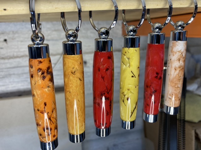

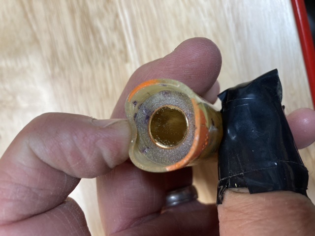

Here are my results. I poured these for making bottle opener handles, but deemed them too soft. I switched to use them for keychains instead so they'd have the support of the brass tube.
See how soft!
They turned ok, but I could easily scratch the surface with my fingernail, so I coated in CA and polished that for a protective finish.
I wonder if they were soft because of the ratio off, or if I bought the wrong product.
