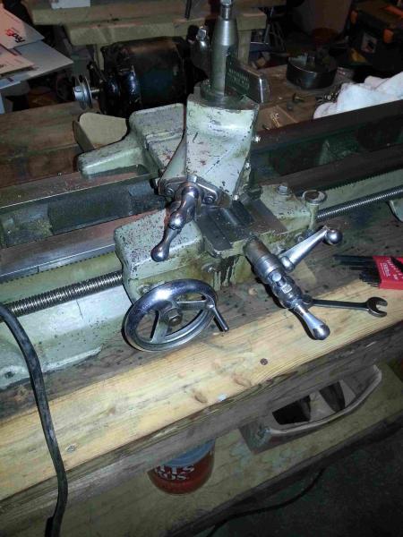

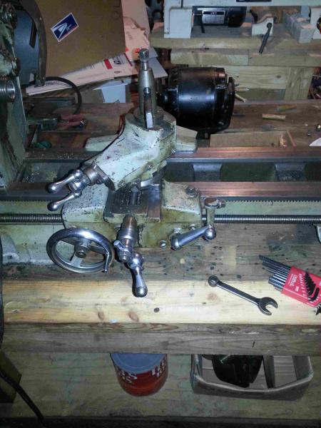

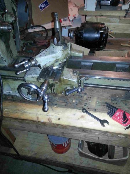

Here are some pictures, Mike. I'm in the dark about how the thing works.

Short answer is no there is no power feed. You will survive without it. Replacement handles on Ebay are $30.00 plus. A lot of them are interchangeable between the 9, 10 and 12 Look under both Atlas and Craftsman when searching.
