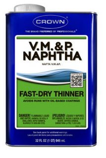

I know this is an older thread but just ran across the idea of using naphtha as an accelerator. Would I use the big box product and apply with a little spray bottle?
Sylvanite
Jul 18, 2006
3,113
Hillsborough, North Carolina, USA.
CA glue is acidic and polymerizes with the addition of a mild base (pretty much anything with an -OH ion).
If you look at the MSDS for factory accelerator, you'll see that in addition to the naphtha, heptane, hexane, butane, or acetone, they contain (typically around 1%) an amine such as n, n-dimethyl-p-toluidine. That's the ingredient that promotes the polymerization. The other 99% is just a carrier.
You can try using straight naphtha, but don't be surprised if it doesn't work well.
I hope that helps,
Eric
ramaroodle
Feb 15, 2018
686
Seattle
I hope that helps,
Eric
So, something branded as "accelerator" is a better choice?
