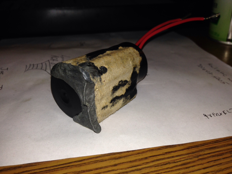

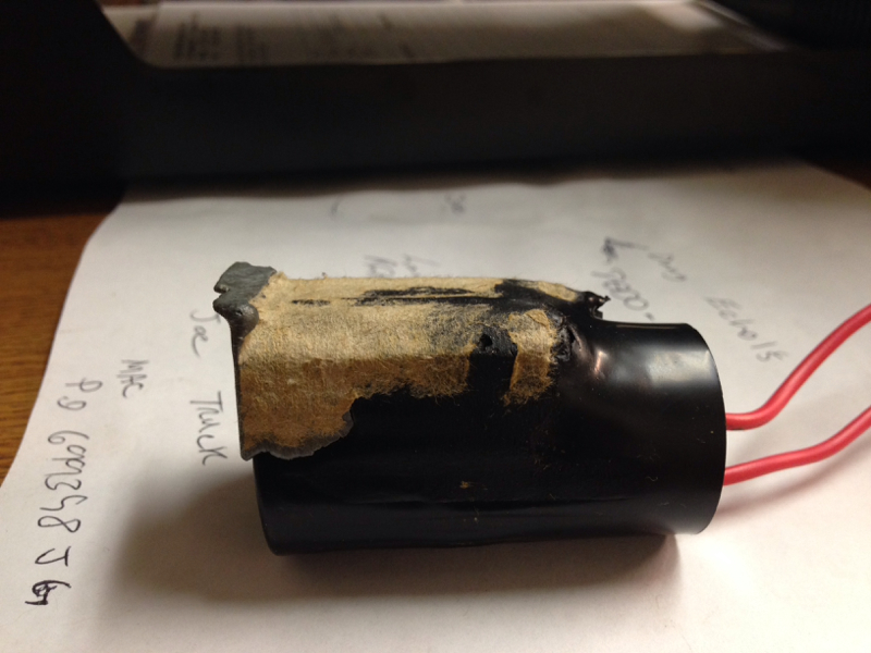

Hey guys, thanks for all the info. Finally had a chance to break into it last night and found this for a capacitor. I think it might be a little bad. It's a 25uf 250vac with a -35 ~ +65 degrees Celsius.

Well, here's an update. Bought two start capacitors and blew both within 2 to 10 minutes. Took the motor to a rewind shop and he'd it checked and motors good. They hooked up a run capacitor and ran for two hours straight and never even got hot. The only problem now is trying to mount this large shinny capacitor somewhere.
Those where the two that blew out. And at the cost, not gonna work.

That is correct, I ordered two capacitors from jet and both blew in under ten minutes each. Those are, according to jet, start capacitors. But when I spin the hand wheel it'll run, but I can stall it out by grabbing the work piece. But when the winding shop had the run capacitor hooked up, it would start and could not stall it out.
